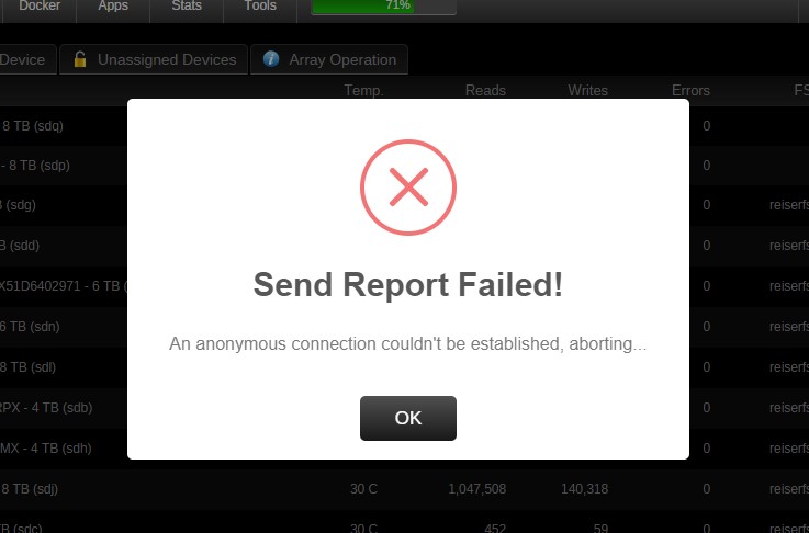

Just finished Preclear of a Seagate 8TB Archive drive and got the popup to share stats anonymously but it keeps failing. IKs there something I need to set at my end?
I'm having the same problem as tabish121. I was preclearing an 8TB Seagate and it went perfectly through the pre-read and zeroing and then at 95% of the post-read it just stopped and the timer is frozen at 15:09:01 and now unraid shows the disk as spun down. I also noticed that 1 core of my 8 on the cpu is maxing out at 100%. Here is the preclear log:

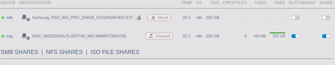

596e78977a988_2017-07-1823_06_43-tower_Main.thumb.png.34a041fde0cceb009d97b634942163e0.png

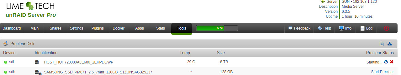

Having trouble doing a pre-clear. I started one about an hour ago and the screen still looks like this? Any ideas? I selected the JOE.L drop down and left all the other options default.
