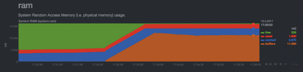

I'll try the Tweaks ant Tips plugin in 20 min. currently running a Mimtest.

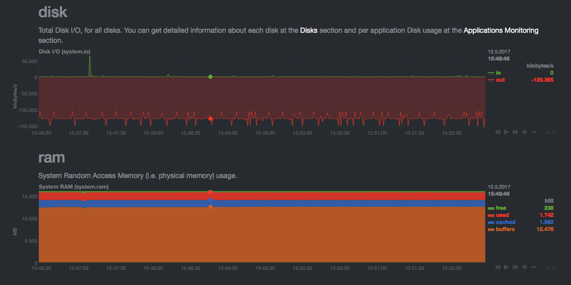

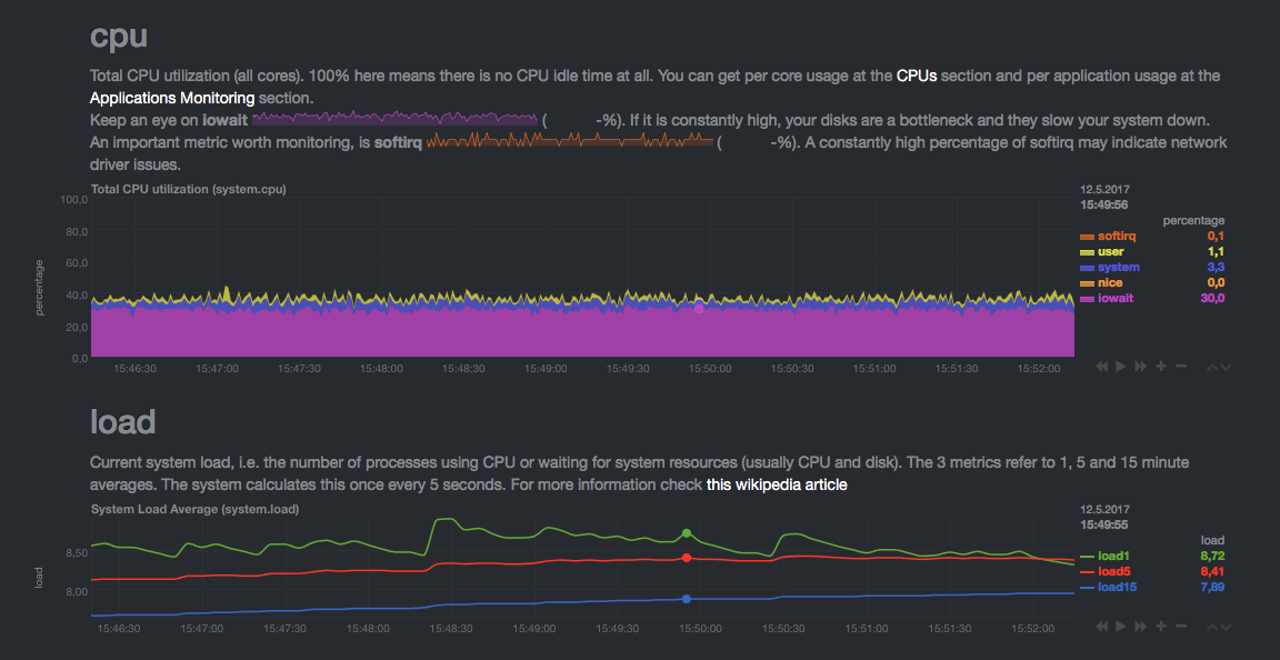

Could this screenshots from netadata eventually help trubleshooting?
5915c32e3ad6c_Bildschirmfoto2017-05-12um16_11_50.thumb.png.81311a4427b969a322d7574ec5252613.png5915c2d50b0ec_Bildschirmfoto2017-05-12um16_11_33.thumb.png.c632597c1fd503c2e2a339c49483cd07.png
See attached for what mine looks like.  you seem to have a lot of spce allocated to Bluffers and it does even show up on my system.   It is important to remember that when the OS 'requests' memory for some process if it is not available, it will dump something from memory.  The GUI  Process (I believe it is emhttp)  is not restartable and it is dumpable!   So when it is shutdown, you have lost the GUI period...
Memtest was OK!

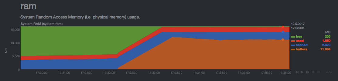

I just added your suggested settings under tweaks and starting a new Preclear now.
If I got it right that should solve the problem. I've seen some emhttp issues while tailing the log.
Edit:
Preclear running for 8 min now. Buffers going up again.
5915d6921db84_Bildschirmfoto2017-05-12um17_36_03.thumb.png.9184963e4fda055edb6298fcf72a38dd.png
Is there a way to limit the buffering for Preclear?

2 hours ago, Diggewuff said:
Memtest was OK!
Edit:

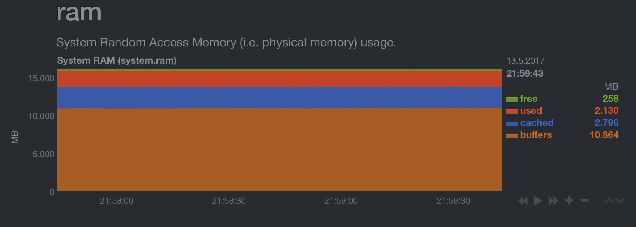

OK. The Preclear ran for 2 hours without Problems. But killed te GUI again.
Any ideas? Logs to take la look on... Settings to try...
