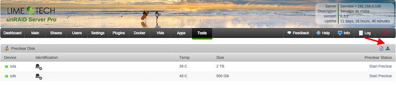

On 17/05/2015 at 8:10 PM, gfjardim said:
Q) How can I download a copy of the plugin log?
A) Please go to Tools, then Pleclear Disk, and click on the Download icon:
58d2586e87cf5_CapturadeTela2017-03-22as06_58_22.png.3225471341bf4d5dddaf798e9e6ee246.png
Please follow the instructions above and send here the zip file.
