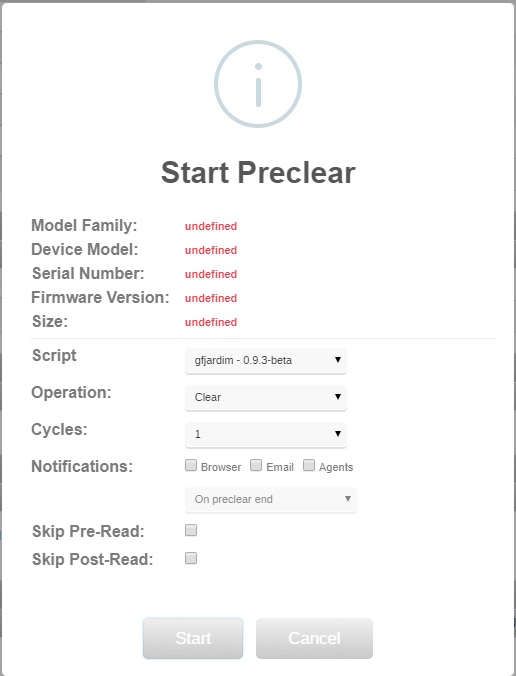

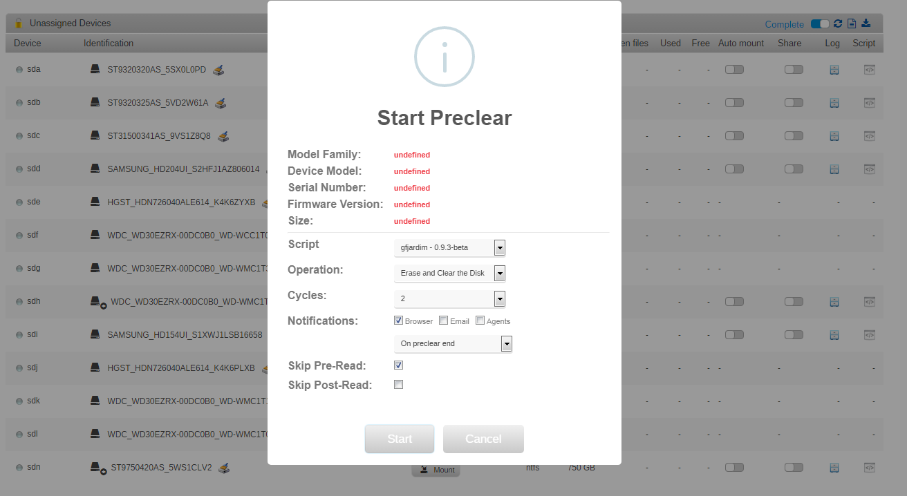

I've just bought a new 2TB drive that I want to set up on my unRAID server - when I come to use Preclear it's telling me that the model famil, device model, serial number, firmware version and size are all "undefined" - is this normal??
Also, for a brand new drive, which operation should I be running? (Clear, verify all the disk, verify MBR only, erase all the disk or erase and clear the disk)
And lastly, should I be skipping the pre or post read??
Thanks for any help with this - VERY new unRAID user here!!!
I'm getting this as well, a previous version used to show this info without issue.

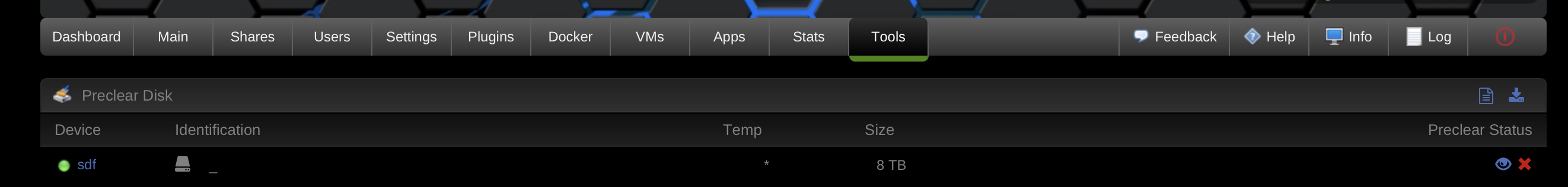

I'm also loosing all the pre-clear icons from Main tab after a pre-clear on a disk is started.  Also the Pre-clear plugin page  is now empty with message "No unassigned disks available", however all my drives are unassigned.

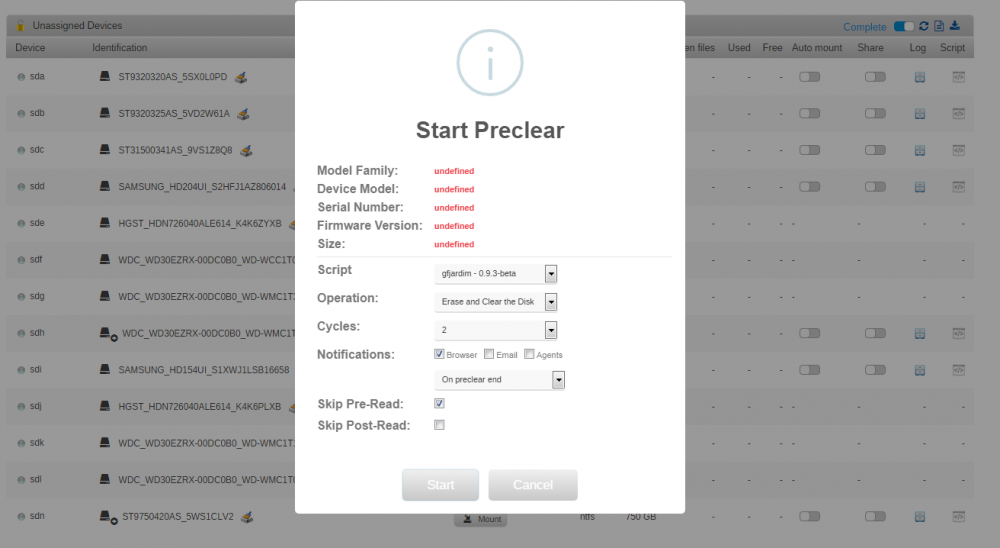

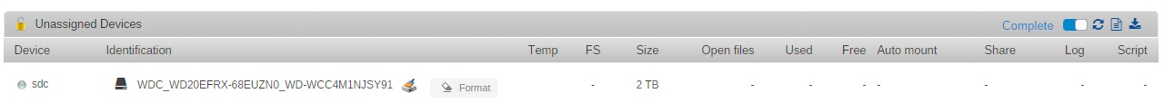

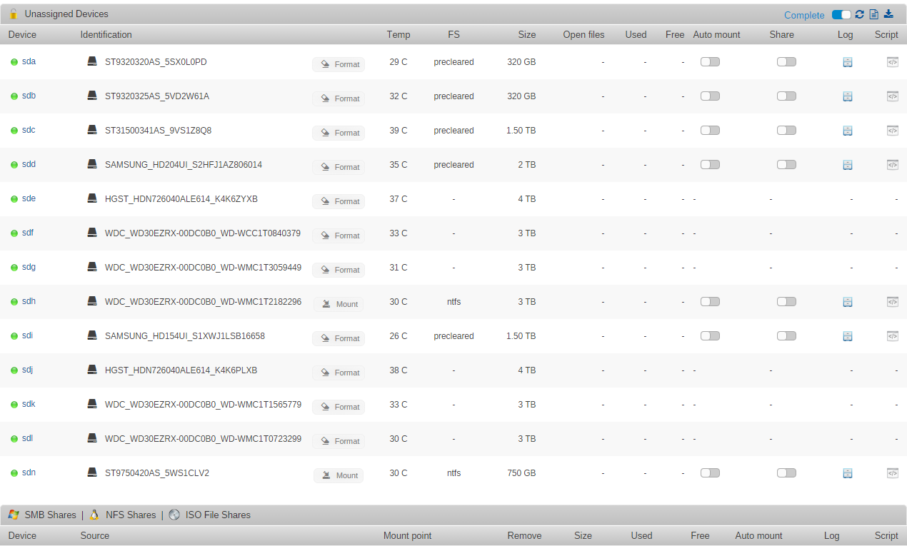

I've updated mine (assume I don't need a reboot or anything??) and it doesn't seem to have made any difference - my 2TB drive still shows up in my unassigned devices list in my "Main" tab (although there is no illumination on the far left near where it says "sdc" - is it supposed to?
And if I click on the Preclear icon I still get the following

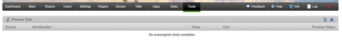

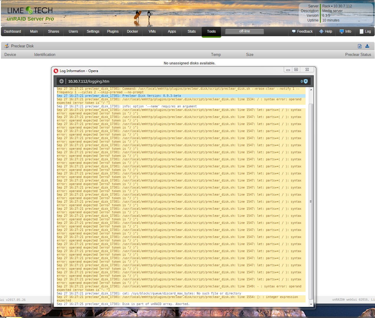

Also, if I click on Tools>Preclear Disk nothing shows up:
Am I doing something wrong or should this show a bit more information? (I don't want to start the Preclear process without being sure I've set everything up correctly!)

  • all drives were showing on preclear page
  • disk details were displayed correctly in the options window

I've since tried a clean install (remove plugin / reboot / install plugin / reboot) and am still presented with the same symptoms.  Screenshots and preclear log attacehd.

I noticed an error about rc.diskinfo not running when I installed the plugin.  I tried using the .plg file for 9.24 from my other unRAID server to install the plugin, which installed but still didn't work.  What I did was  run "/etc/rc.d/rc.diskinfo -d" to start it on daemon mode while 9.24 was installed and then updated to 9.26.  Now I'm able to run preclear and it displays all of the expected disk information.

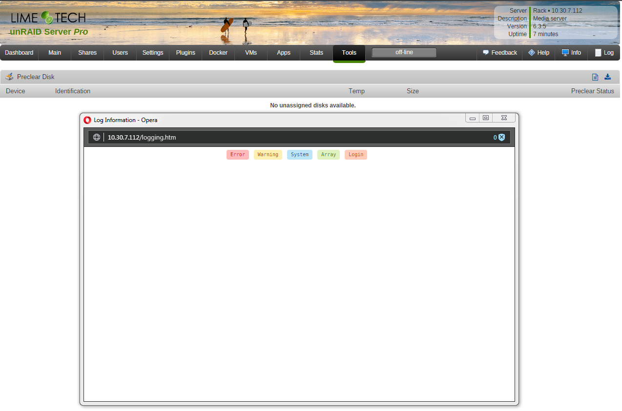

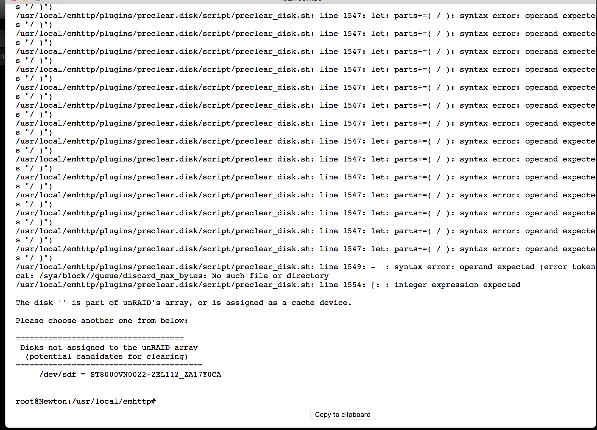

when I try to pre clear the disk, the icon on main goes away, but when I open pre clear I was able to find a log for the operation. it looks like because there is an issue with the drive information, it thinks the disk is in the array.
in my case this is a new disk, fresh out of the box into the server.
the disk selected is the one listed in the "potential candidates for clearing" list.
Edit: adding screen shot of how disk is appearing in pre clear plugin

Yes.
The correct command to test it is /etc/rc.d/rc.diskinfo --daemon
