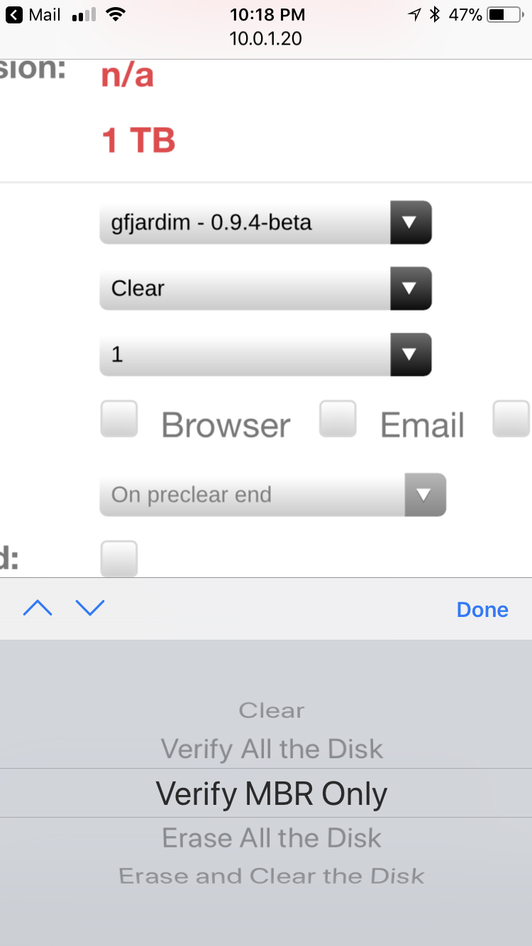

What is the difference between erase disk and clear disk?  Clear zero's the drive I believe but what does the erase disk option do?
Erase will fill the entire disk with randomly generated data; Erase and Clear will do the erase operation, then fill it with zeroes and write the unRAID clear signature. Clear will fill the disk with zeroes then write the unRAID clear signature.
Thanks for tihs script @gfjardim
I would put this right up front in the OP.
So Erase and Clear is what the default PreClear script would normally do, right?
Edited by axeman
You can actually select between a bunch of different erase, clear and verify options.
No, Clear is the default operation. Erase should be used when removing a disk from your array to be sold, e.g.
Enviado de meu SM-G955F usando Tapatalk
Dang - should've waited for your reply. I did erase and clear. I've got 3 cycles going and it just started the erasing.
