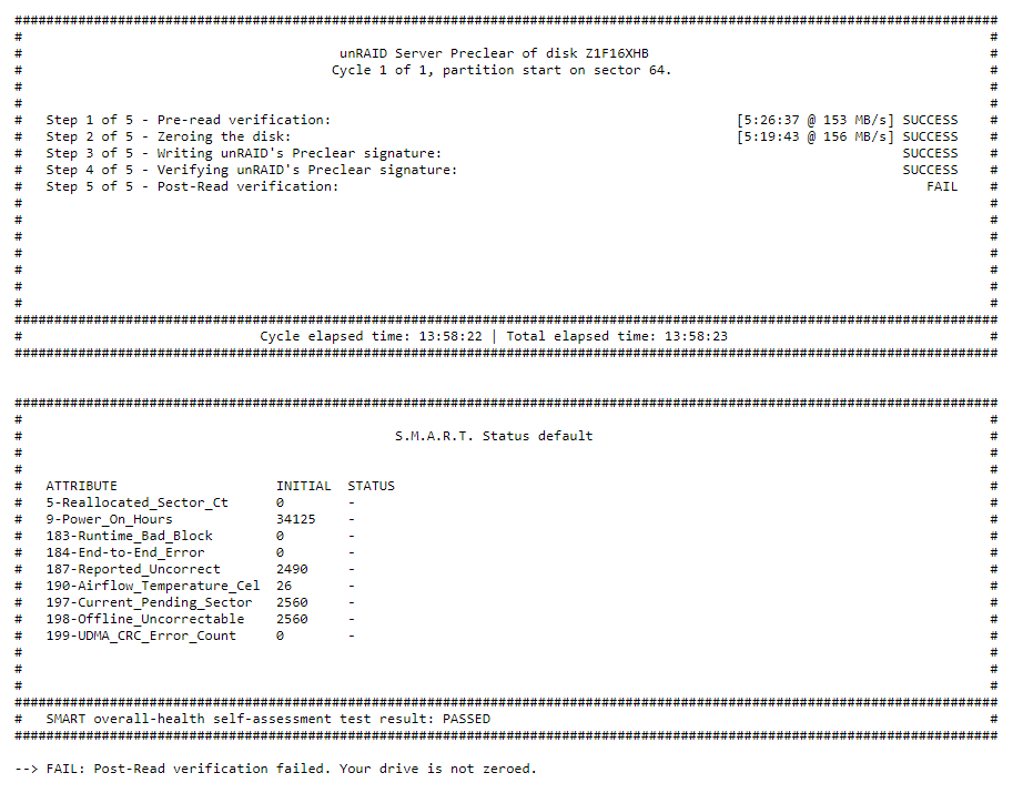

Just of curiosity.. How could SMART report this disk as PASSED??? It failed the post-read verification and the disk does not look healthy at all....
Also the google forms failed to upload this report.. I let it sit for 5 minutes before i reloaded the webpage to get it to respond and then clicked dismiss. The next report that were ok were possible to upload fine in 2 secs.
I agree that it does not look healthy!    SMART always seems to be conservative about failing a disk, so I always assume that if a disk is OK according to SMART it may be OK in real life.    If SMART reports it as failing I treat that as meaning urgent action is required.
There are often a number of SMART attributes that have threshold 0, which means the attribute will never be able to go below the threshold value and so will never be in a failing state. So these attributes will only be treated as indicators for an intelligent reader to ponder.
Having a current pending sector is a warning - not a failure - for a disk.
On one hand, it can be a physically damaged sector - which doesn't mean the disk will fail but that the specific sectors needs to be remapped with spare sectors.
Or it can be a physically damaged head, meaning that the drive is permanently bad at reading and/or writing data.
But it can also be a power issue etc that has nothing to do with the disk itself.
Another thing is that the drive doesn't keep track of write times for the individual sectors. You know that you have recently written to every sector, which means that you know that 2560 offline uncorrectable is a extremely bad figure, because it means the recent fails did fail because head or surface is bad.
The above is a reason why many SMART programs informs about changes - expecting the owner to react if some of these fields ticks up and to try to make an intelligent decision of what to do next.
Ok, this is the infamous Seagate 3TB disk.. I bought 4 of them and now 3 of them has failed... :) But they are old now.... 1 of the disks still tests fault free... But i will keep an eye on it.. Changed from QNAP to unRAID also because it offers more security in case QNAP hardware fail or the RAID5... :)
@Meph, you have found the one of the disks that the preclear script and its cousin ,  the Preclear plugin, were developed to find and identify.  Without it, you probably would have installed this disk back into your array and it would have been installed.  As has been pointed out, the SMART system has declared that this disk is fine.  And, it probably is for 90% of the applications where it might be used.  But not for unRAID (and virtually any other RAID setup)!  Remember the SMART system was developed by the HD manufacturers and is designed to discourage the return of disks using it as a basis for a warranty  claim!
Both Preclear processes present the user with the information necessary to make a decision as whether to use the disk or not.  The real philosophical  question is whether the "SMART over-all health assessment test"  results should be included in their reports.    I have never seen a case where it indicated that a disk has failed where a prudent person looking at the other attributes would have assumed that the disk was good.  Perhaps, if someone has encountered one, I would be the first to say leave it in the report as I believe to err on the side of caution in this type of situation.
PS--- If this were a disk of mine, I would be running to the trash can to pitch it in!  I would not even use it for secondary storage...
Edited by Frank1940
@Frank1940 Yes, I agree.. I would never use this disk with those many errors.. It's in the pile marked as "Defective" and is going to the recycling center next time im going there..
One thing is strange though. The report for this disc tried to upload as usual to the developer of the plugin, but upload failed. I tried like 3-4 times.. All other reports (like 10-15 reports) have reported just fine. This is the only report where the preclear plugin did not run to the end.

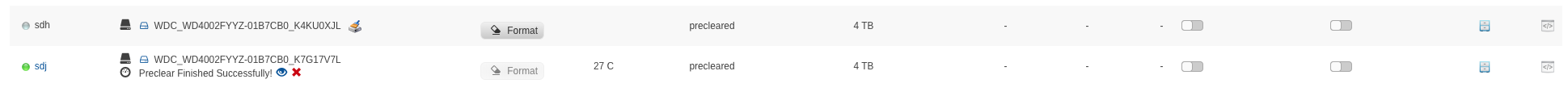

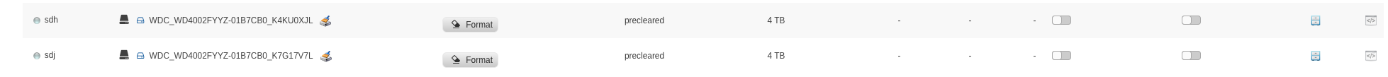

I'm currently running the stable release 6.4.0 and I have only one problem with the Preclear plugin.
After I preclear the drive in the unassigned devices section, It says that the preclear completed successfully, but I have the option to cancel currently running preclear as can be seen in the attached screenshot.
5a66429b18ec5_ScreenShot2018-01-22at12_35_04PM.thumb.png.b10251b2d966a454bb23c2e6e694aff0.png
I cannot get that message to disappear unless I stop the unRAID server and reboot the server, which then gives me this attached screenshot.
5a66429c063f9_ScreenShot2018-01-22at12_39_18PM.thumb.png.a47d4197a27cd055183ef67112a2b509.png
Is this normal behaviour with this plugin?
