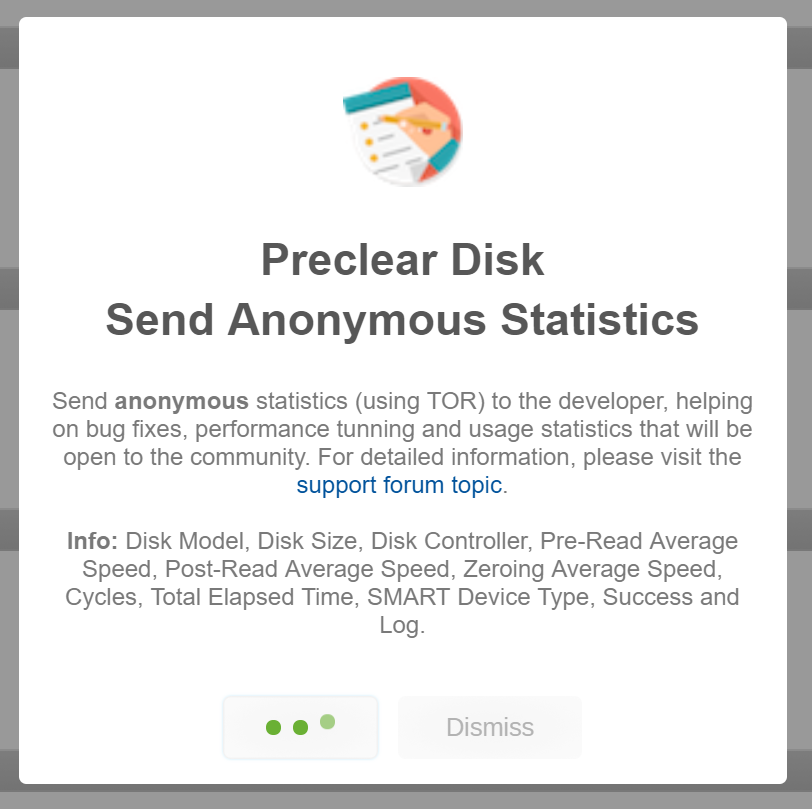

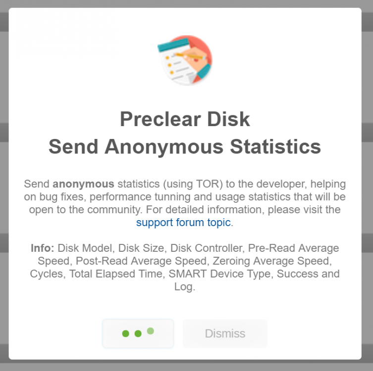

On 04/09/2017 at 0:05 AM, capone said:
I have two "dismissed" reports that just won't send... does anyone else have the same issue? I've been trying to send them over the last few days/week... and they just won't send... all the other reports I've generated from different precleared disks have been sent.
I've attached screenshots of the syslog (my IP removed)...and the "sending statistics" screen...Capture1.PNG.be6750ef5d5089bb480b5fbdf8346956.PNG
Nothing else happens...it just sits there... and never sends...
I'll remove TOR from Statistics. The hassle is greater than the benefits.
