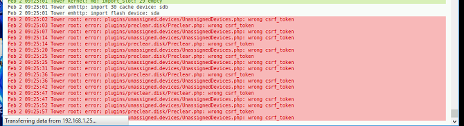

Hello Forum
Started getting these errors in my syslog this morning after updating PreClear Plugin and Unassigned Devices Plugin.
I'm I the only one?  See attachment
Hello Forum
Are you sure you have the latest version of these plugins installed?

There is a difference between missing csrf_token and wrong csrf_token.  The missing csrf_token means the post does not have the csrf_token defined.  This is a coding issue in the plugin.  A wrong csrf_token means the csrf_token passed in is the wrong value.  The wrong csrf_token is generally from a stale token from a webgui being open during a reboot.  It would pass the old value because the csrf_token is re-genereated on each boot.
- Missing csrf_token  is a programming problem.
- Wrong csrf_token is from a stale value being used and can be fixed by refreshing the page in the open browser.

OK, so that's normal. Any advise on the "missing csrf_token"?
Apparently, it is caused by ANY browser window that was opened (and is still open) before your last reboot.  And, apparently, it can be on any computer or device and not necessarily the computer that is displaying the error.
Thank you for the clarification!  Hopefully, the number of Missing csrf_token issues will decline rapidly as the programmers 'fix' the last of them and folks get all of their plugins updated.  But I would hazard that we will always that the Wrong csrf_token issue with us...
