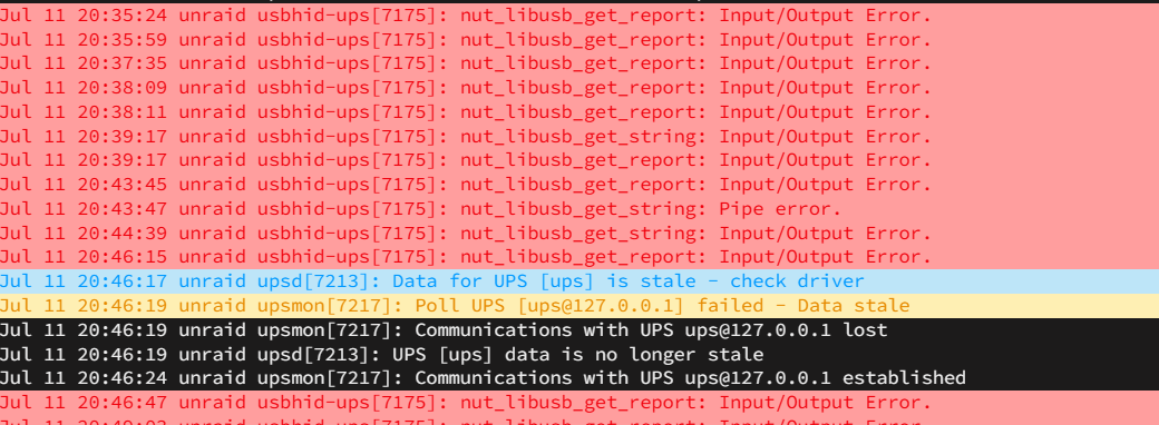

Hi there, i'm having issues with my ups staying connected. looking in the system log i get the errors in the picture. the only way to make it work again is to stop the service, unplug and replug the usb which i'm keeping it in the same usb port however i have tried changing ports and then re-enabling the service and it'll stay working for quite a while. Any ideas of what i can try to resolve?image.thumb.png.cfb021047509f02e66046eec53855e2a.png
Do you see any messages in the logs about the USB connection dropping?

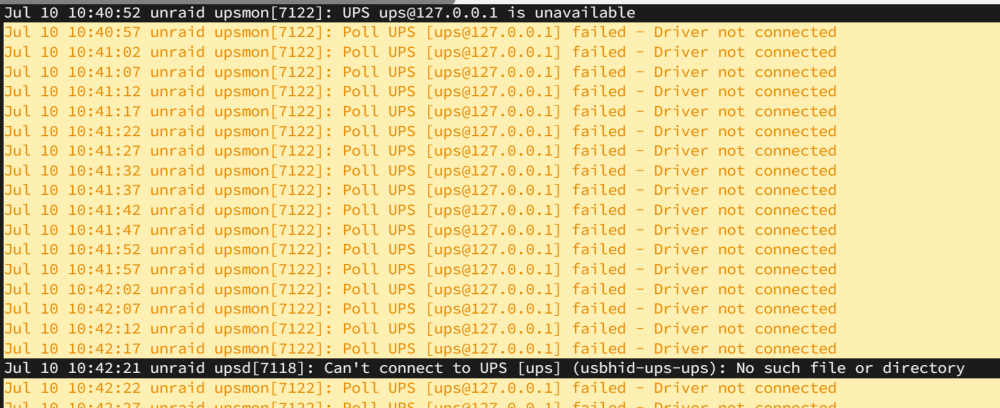

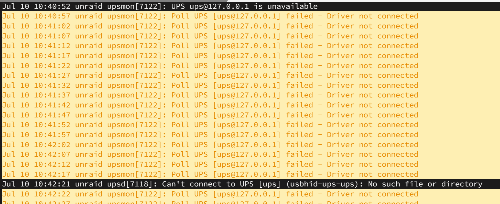

it does seem so this is what the log shows. my usb mouse seems to drop connection in a similar way preventing a vm from starting that i have the device passed through on but my usb keyboard and headset don't seem to have problems.
Usb drop offline and was enumerated so nut likely trying to use dev 27 but is now 28 hence the failure.
Wonder why its dropping out its a new build, but ill keep try to resolve that, anyway to have it pick up the new dev number when it does this like the built in ups plugin does?

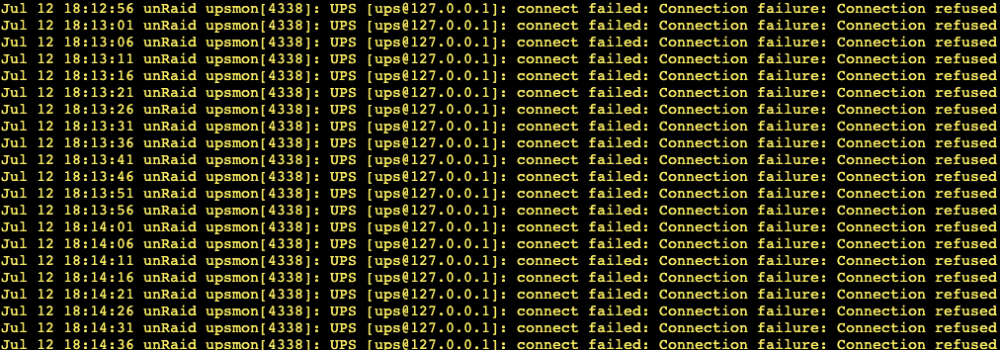

after upgrading to 6.12.2 and starting the plug-in, the ups in the local area network I connected works normally, but I can see the log
unRaid upsmon[4338]: UPS [[email protected]]: connect failed: Connection failure: Connection refused
