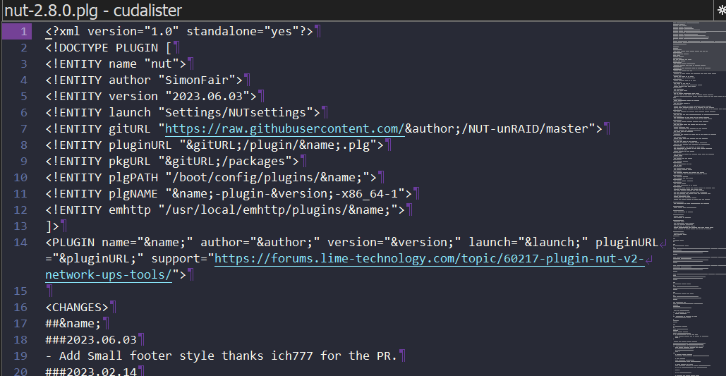

@dmacias nut-2.8.0.plg doesnt have updated ?
i found it missed 2 updates ....
###2023.06.03
- Add Small footer style thanks ich777 for the PR.
###2023.02.14
-6.12 Dashboard support
-PHP8 fixes
-Refresh option.
Maybe you can update 2.8.0 also ?
###2023.06.03
###2023.02.14
-PHP8 fixes
-Refresh option.
It is my version of the plugin 2.8.0 is a test load. I have not added the changes to that version yet. it already include 2023.02.14 but not likely to be in the change log.
I have not tested 2.8.0 on pre 6.12 systems and with USB attached UPS as yet. It was created to cover SNMP requirements.
OK, im just moved to this version 2.8.0 because the developers of nut suggested in case of my problem (Eaton 9E unknown)
but its still unknown .... .Also the new version have a lot of updates from 2.7 .
Maybe if you will have time to move to 2.8.0 from test to release ?

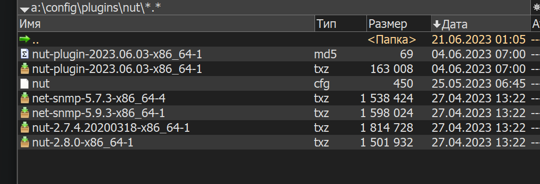

After updated to 6.12 version , somehow plugin goes back to 2.7 from 2.8 ...
is 2.8 working OK in 6,12 ?
After checked the plugin auto updated to nut-plugin-2023.06.03-x86_64-1.txz also file nut-2.8.0.plg
but in fact its 2.7.1  ....
i restored v2.8.0 (nut-plugin-2023.02.14-x86_64-1 and nut-2.8.0.plg ) from backup to flash yesterday but after autoupdate its again updated to (nut-plugin-2023.06.03-x86_64-1.txz and nut-2.8.0.plg) that in fact its 2.7.1 ...
@SimonF can you please check why nut-2.8.0.plg update from "nut-plugin-2023.02.14-x86_64-1" to "nut-plugin-2023.06.03-x86_64-1.txz" and become 2.7.4 in  nut-2.8.0.plg ? on 6.12.1
is anyone have update problem also for plugin ?
P.S i removed plugin then installed again , and have same problem after autoupdate

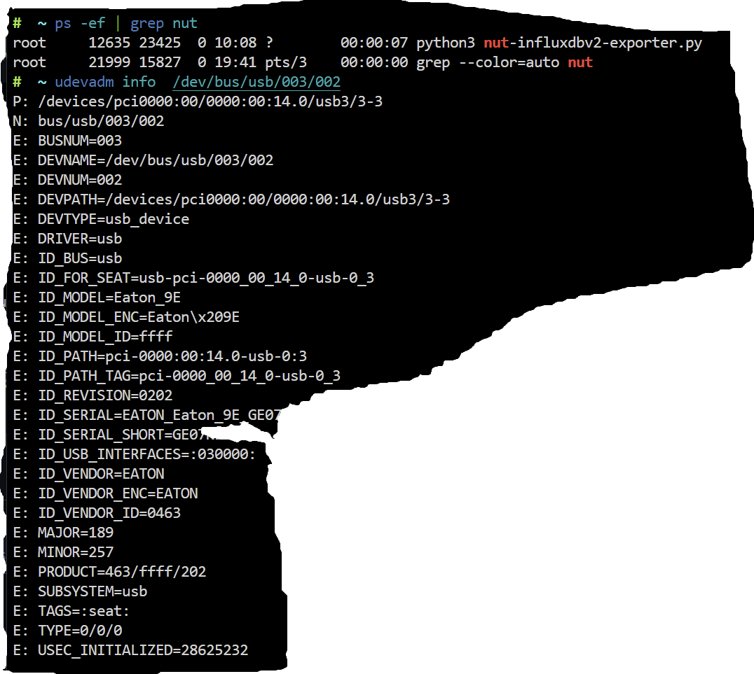

@SimonF about "unknown 2000" device in my case , i made a debug logs for authors and they ask :
(Just in case: are the udev.rules (or udev.hwdb) issues ruled out? Does the OS know to not grab certain VID:PID pairs and/or to re-own them to nut:nut or similar accounts?)
Maybe you know about it?

Thanks, another post was :
So the problem is very likely due to that original "libusb can't get the details", which may be a permissions problem or the device being busy due to someone else grabbing it with higher priority (hypervisor, OS drivers and daemons, etc.
The strange thing i can see all info when running ' lsusb -vv ' :
249145961-ee4c576f-9f8d-482a-9f25-3ec5b4
but device,model is unknown and no serial number :
249140433-d951fde4-0089-41a4-ac76-7e75d9

@SimonF Maybe you can help me with (unknown) problem ,im in tuch with developers of nut they said:
Thanks. So, to summarize: even though the driver is running as root, and maybe there are no competitors (who is 6609? was it somehow fuser itself or something else?), libusb in usbhid-ups won't tell the basic iProduct etc. fields used during matching and which lsusb does see, but the driver sees further info from the actual protocol query/response.
So a sort of sideways solution could be to ensure these values (if "unknown") by querying something additionally over USB HID protocol, if the device serves those data points.
But the primary direct solution would be to find out why they are "unknown" in the first place and avoiding that. And documenting in how-to's for posterity.
> fuser /dev/bus/usb/003/002
Cannot stat file /proc/6609/fd/46: Stale file handle
/dev/bus/usb/003/002:  7697
i found 6609 its smb deamon , maybe its used becose of netserver ups mode in my case , im using for Windows client (my Main PC)
So maybe you can suggest something ?

not sure why you have a smb. So are the NUT devs saying that it gets the info from usb device. Will look at their code. I may be able to get info myself from udev if it is unknown.
What does udevadm info  /dev/bus/usb/003/002 show for you.

Wow it shows all the info ! include product and serial :
Thats what i runned for nut developer requested :
