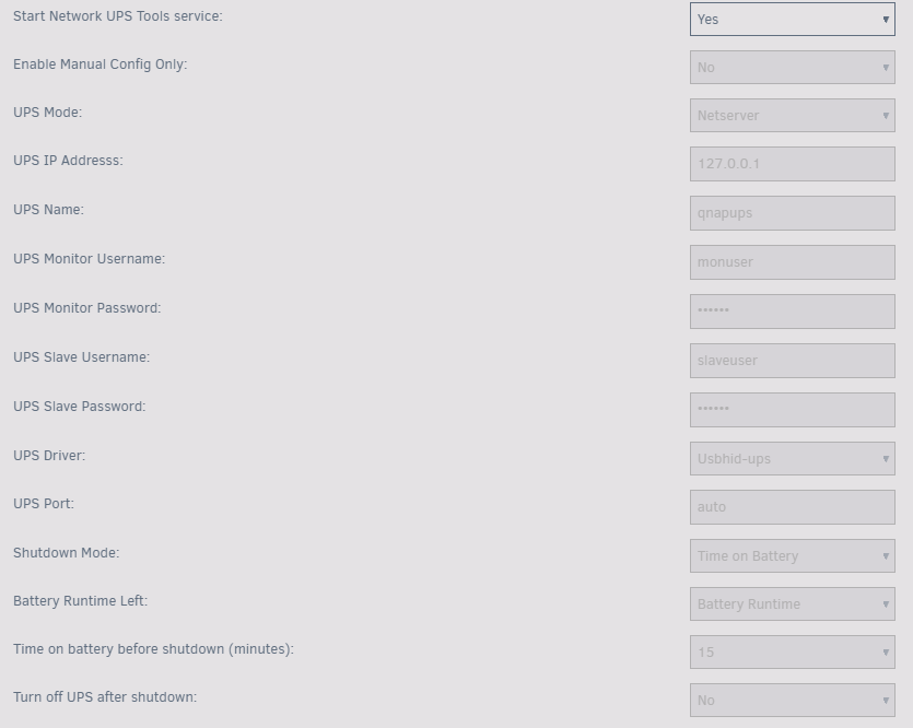

Quick question from a brand new UnRaid user...
I've got NUT installed now (beautiful work btw) and my generic UPS is detected and working fine.
Would it be possible to have NUT on my UnRaid server signal another server that's on the UPS (but not connected to the USB) to shutdown when the power fails?
If this is already a feature and I'm just being stupid from sleep deprivation, thanks, but how do I implement it?
Setting UPS mode to Netserver, then it will serve others network client, the UPS name and username setting just for share to Qnap NAS, it can be anything you like.
Edited by Vr2Io
Thank you, that works!

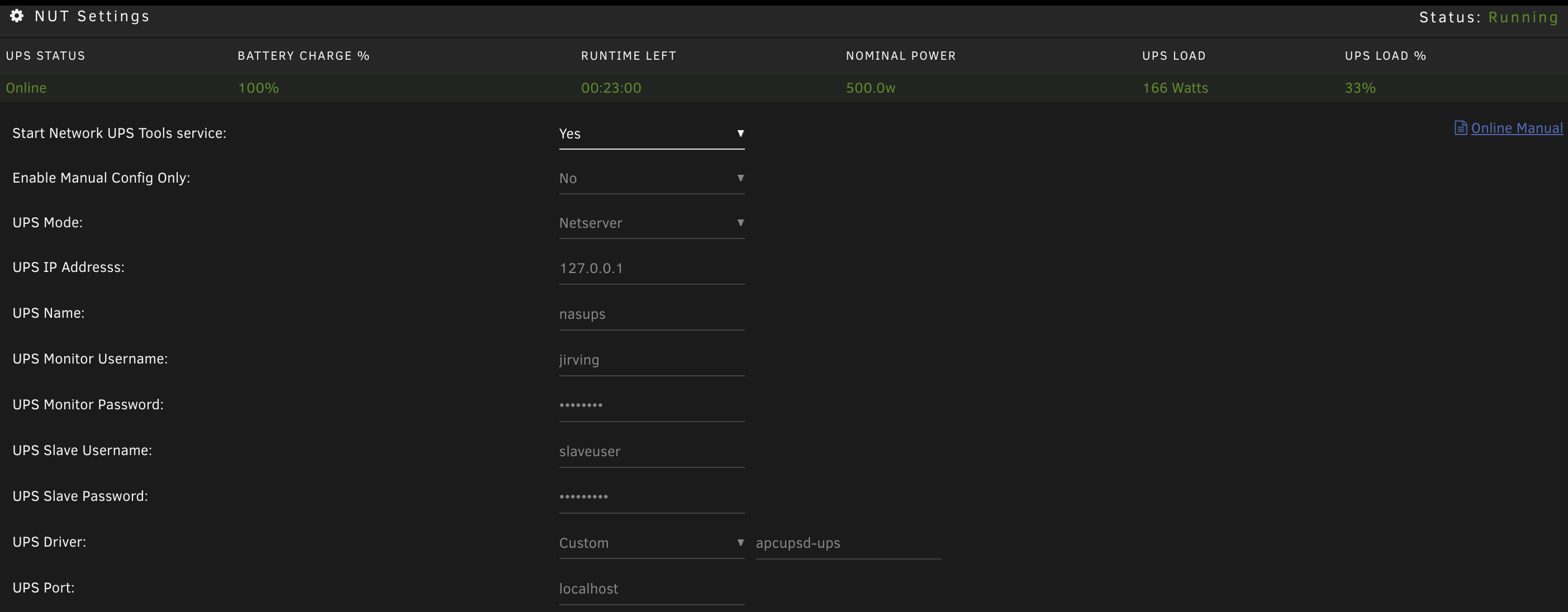

On 4/6/2023 at 5:08 PM, FUser said:
I installed this and it's working via SNMP in Standalone mode. It pulls in all the typical tings, but for Nominal Power it just shows a red W and UPS load is showing a hyphen (The UPS Load % does show a number however) and the status on the bottom shows the wattage (2358w).
I have a similar issue. When I run apcupsd, I get all information, including load, nominal power, etc. With NUT, I get a red W for nominal, and no data for load or load%. I'm trying to run NUT so I can scrape it with prometheus, since I'm already running it on an RPI hooked up to another UPS.
Which nut version are you running?
Can you provide output of config screen
I just installed your plugin (which is how I found this thread). I'm trying to use the `apcupsd-ups` driver, but I guess it might not be installed. I can't find where the NUT version would be:
858746518_Screenshot2023-04-20at15_15_25.thumb.png.00cdd21e4e048c1c00cd6c5fa4b51fd5.png
Apparently, the apcuspd-ups driver pulls from the apcupsd daemon. So I can run APC, and pull the data in, which is working. Works for me, for now:
1389035305_Screenshot2023-04-20at15_25_29.thumb.png.cee8f1cebcae73ea8efdb76e9469a066.png

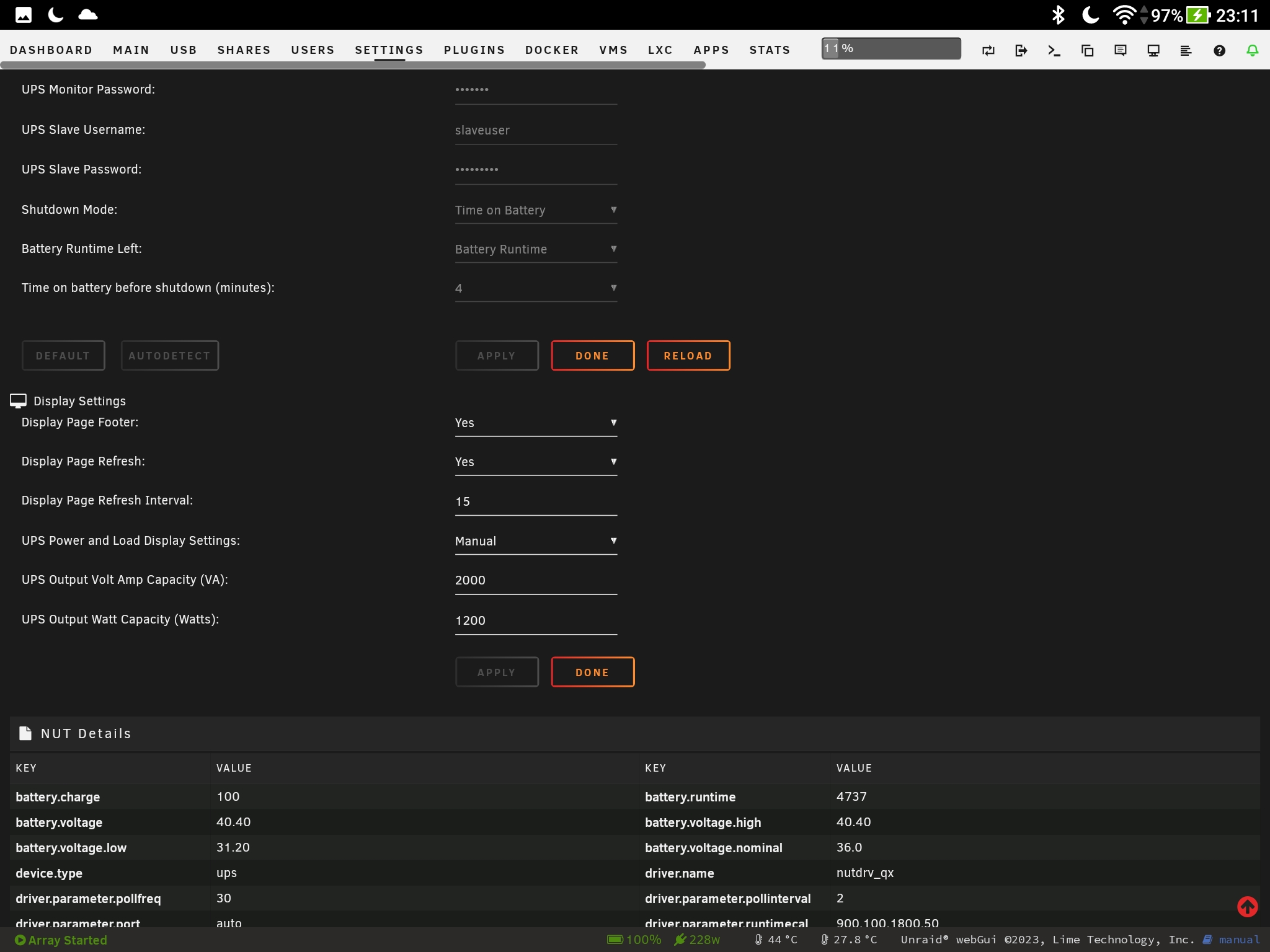

If you want just to use nut you may need to change power and load settings to manual in display settings with 750va and 500w may provide loadi etc
It showed nominal, but no load information.
Mine are set like this but my ups is not apc

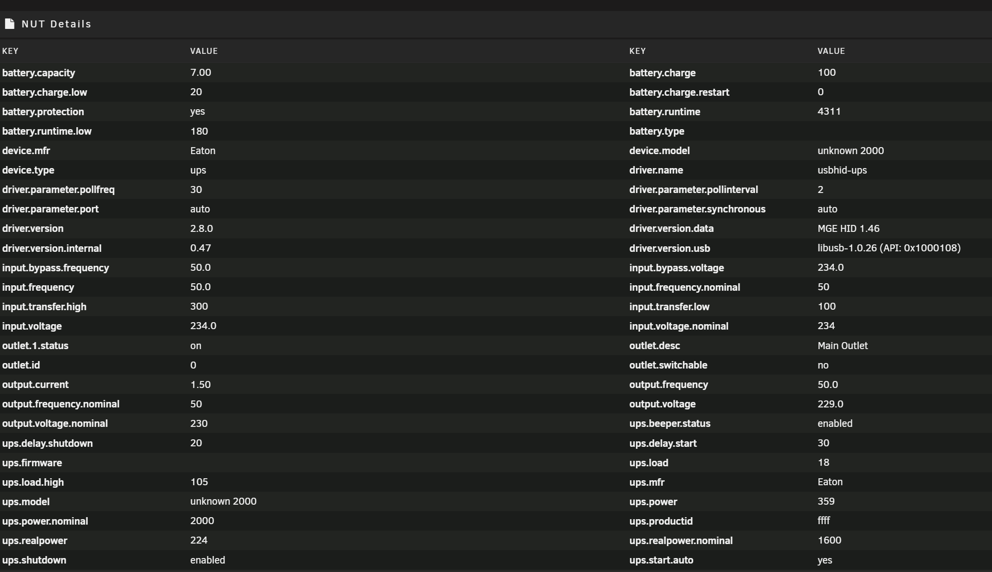

Finnaly got Eaton 9E2000i and its working fine with Apcd , but wanted to check NUT ,and some details missing like serial number
device.model = unknown 2000, ups.model = unknown 2000 , i wanted to set  apcupsd-ups(8) for more compatible but didnt fined it .... can i fix those  (unknown data?)
checked 2.8.0 but still have unknown ups and model and no serial number :(
The values are likely to be denpendant on info the UPS sends.  this is the command that is run  upsc ups where the send value is the defined ups name.
So i cant change it or fix it? i also opened the issue on github for it https://github.com/networkupstools/nut/issues/1925
and having some suggestion from authors:
attempt to start the driver with higher debug verbosity -DDDDDD on command line, which should print out many "Path" lines from basic USB report descriptors that it finds. From those we can try to estimate IDs that are missing in current driver.
If it is possible to try building NUT from source to the extent of trying to make an usb-hid subdriver (see docs directory in github), that would even parse such findings into C mapping tables that we can merge with existing subdriver.
https://github.com/networkupstools/nut/issues/1925#issuecomment-1519636488
