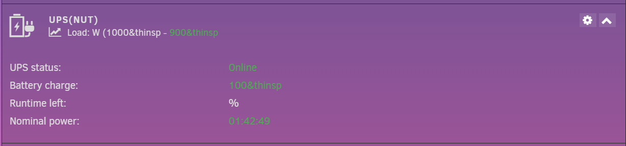

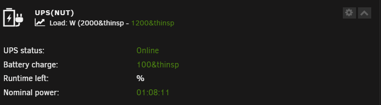

FYI: I've updated to 24a but am still seeing the Dashboard issue in @SimonF's post above. Even in a private window/another browser. Not urgent but let me know if you need any logs/info from my setup to help troubleshoot. Thanks!
Which version of Unraid are you running and what browsers are you using?
Also can you post a screenshot to see how it looks?
Thx
Thx
I'm having the same issue even with 24a. Windows 11, both Firefox latest and MS Edge, Unraid 6.12.3.

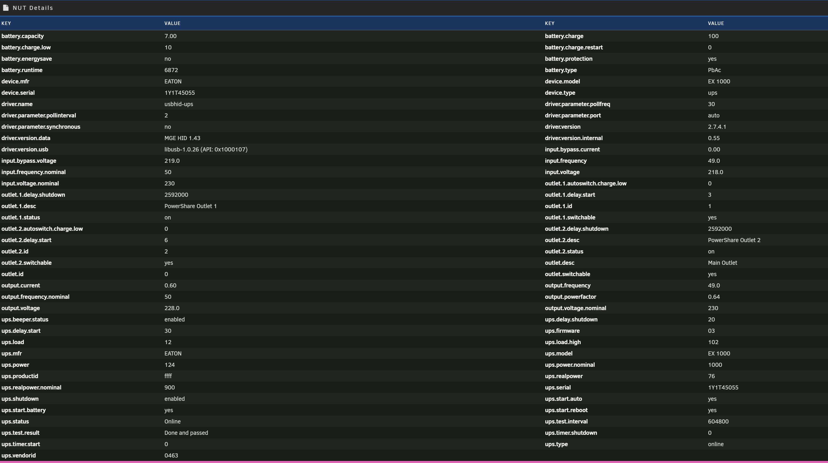

I can't reproduce this, could you screenshot the UPS' reported variables under "NUT Settings" => "NUT Details" so we can test this with the variables your UPS is returning to NUT? I mean the table where there's all the UPS information.
Did you try clearing your cache or pressing CTRL+F5 on the front page so a full refresh of the page is done?
Edited by Rysz
Having the same issue.  I'm on the latest UnRaid version and using chrome and Opera.  And latest NUT-version.image.thumb.png.924c0e96347074cb7df2247b225f10b8.png
Edited by Meniak

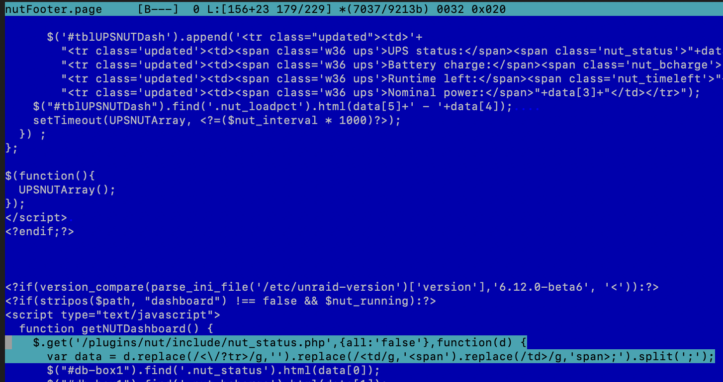

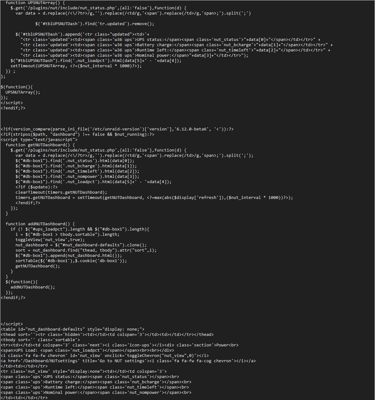

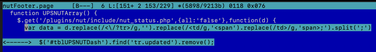

@AgentXXL @carthis @Meniak
Strange behavior, please can you check if these changes (L153-155 and L179-180) have been applied in this file?
/usr/local/emhttp/plugins/nut/nutFooter.page
It continues to split string on semicolon ";" even if it's no longer in code.
I'm not having the problem myself - it works here, but I've added a pull request for a function to be able to export a UPS diagnostics file to help us diagnose such and other problems better.
Sorry, my code review skills are a little weak, but both 153 - 155 and 179 - 180 still show the sections in red from that link, vs the updated code shown in green. Note that the NUT settings page and the footer itself are still showing the correct info, just the Dashboard component that's messed up. I'm using NUT on both of my unRAID servers with one physically connected to the UPS via USB cable and configured as the netserver, and the other as a slave.
EDIT: I'm currently finishing a parity rebuild on the server that's connected to the UPS via USB, but will try rebooting it once the parity rebuild completes (about 4 hrs remaining). I have just rebooted the slave system and the Dashboard error seems to be resolved. I suspect the changes weren't applied to the running plugin, but a reboot seems to have fixed that.
Edited by AgentXXL
Added info about reboot fixing it on my NUT slave.
@Meniak @AgentXXL As I thought, this file wasn't changed when you updated this plugin (maybe locked by a process?). Reinstalling it or restarting your server will fix it.
It seems quite likely to me now that for the users experiencing those problems the relevant PHP files didn't get reloaded when upgrading the plugin (could be locked files due to still running services during patching) and that a reboot would fix those display issues on the front page and the dashboard eventually - I've submitted a pull request to reduce the chance of this happening again with future upgrades of the plugin.
