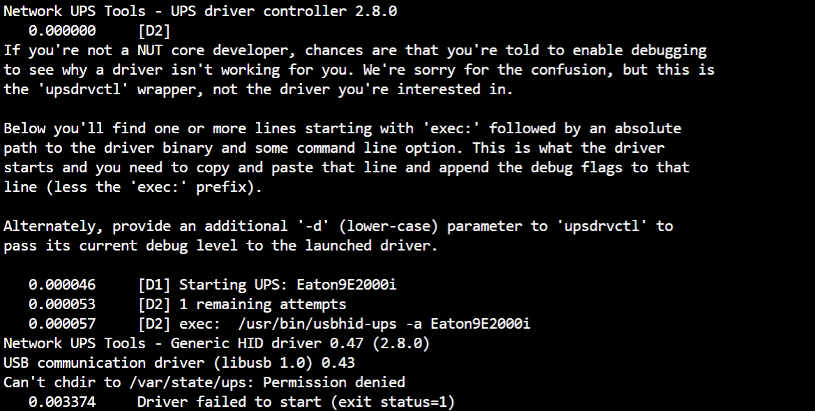

On 4/25/2023 at 9:07 AM, SimonF said:
You can edit the rc.nut in /etc/rc.d/ or if you need to run from a command line /usr/sbin/upsdrvctl -DDDDDD -F start

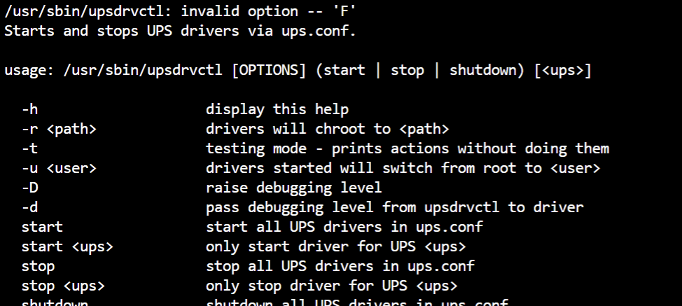

-F not working :

if you can help with run from command line for debug , so i can send for Developers for debug to find why my device is unknown ...
and add it .then ...

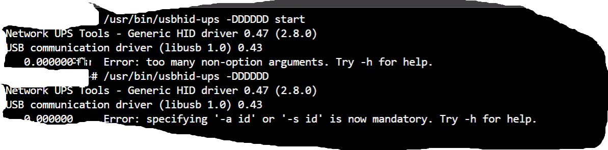

2 minutes ago, Masterwishx said:
@SimonF
without -F :
ok looks like you need to run /usr/bin/usbhid-ups line with the -DDDDDD options.
maybe -F is for 2.8.1 as it in the manual. https://networkupstools.org/docs/man/upsdrvctl.html but did not check the version.

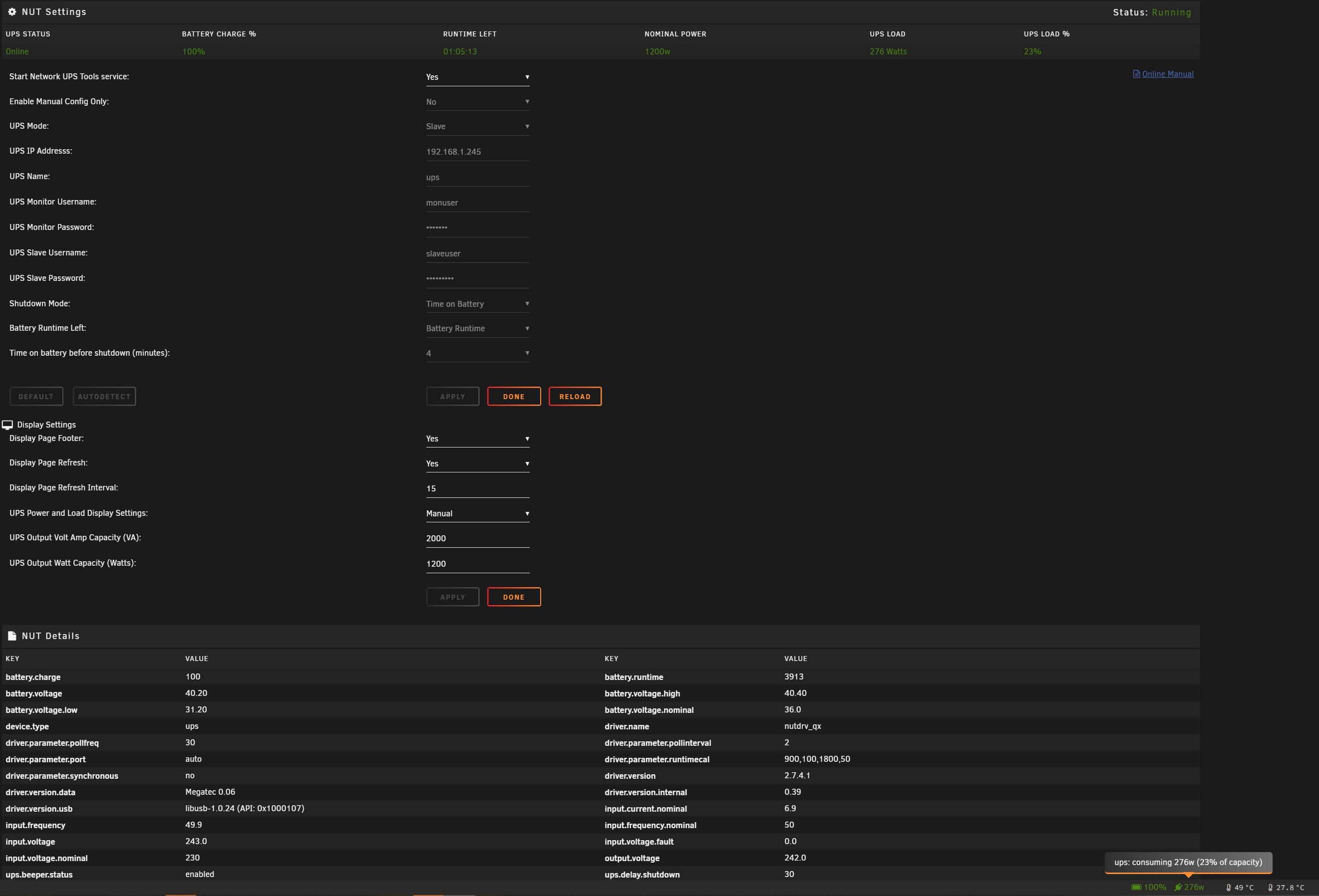

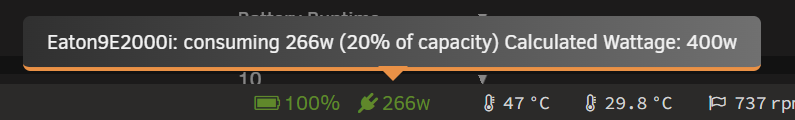

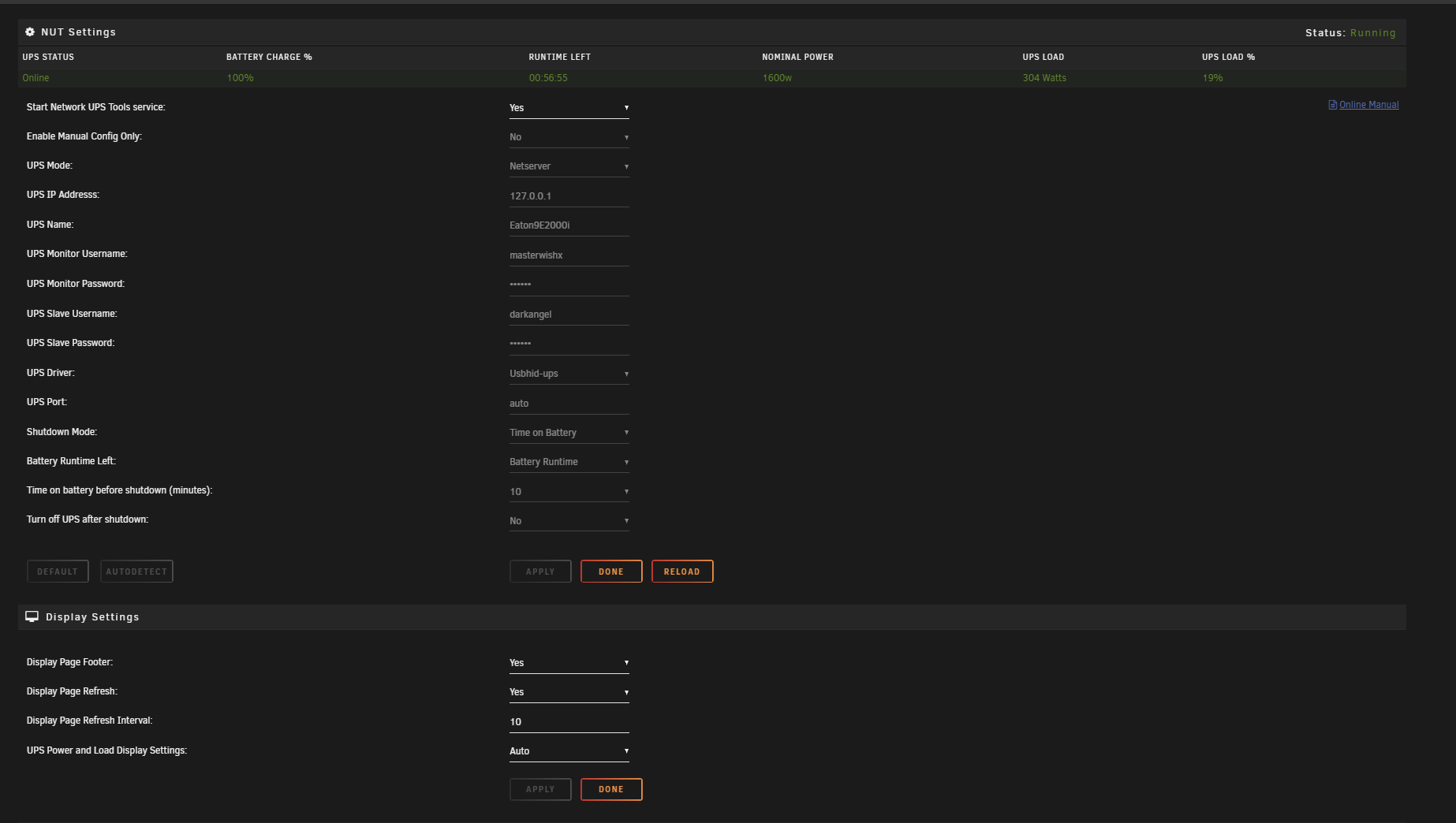

@SimonF is it OK that i have in NUT Setting : that is Right
but in bottom page footer NOT same value ?!?
They should match. Can you supply the display settings bit?
Sure :
22 hours ago, Masterwishx said:
Sure :
I am not sure why the footer is using realpower value rather than realpower.nominal but will need to look into it futher. If the ups does not provide realpower then the output is different.
Strange in my case its provided ....
Only footer uses it not the status part. I did a PR for the footer to the original plugin, but did not apply to status. Will look to change that also. Footer is showing the real value.

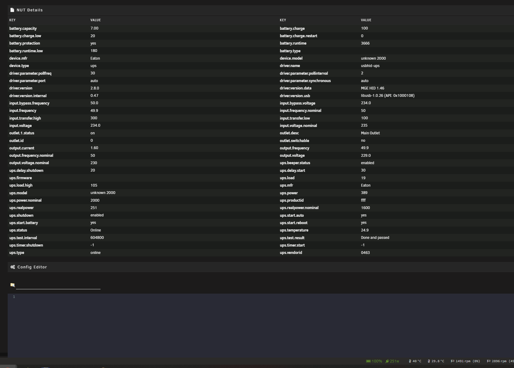

im a little confused , we have ups.power.nominal in my case 2000 ups.realpower.nominal 1600 .
ups.load =19% when 1600*.19=304 UPS Load=304w
output.current 1.6*229=366.4w
also we have ups.realpower=253 ups.power=385
So what is more real power watts ?

@SimonF Also trying to find out about my device.model why its 'unknown 2000' so founded when typed in console : lsusb -vv
all info is exist product and serial number that missed in NUT Setting page ...
Spoiler
