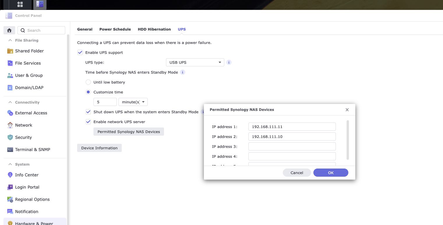

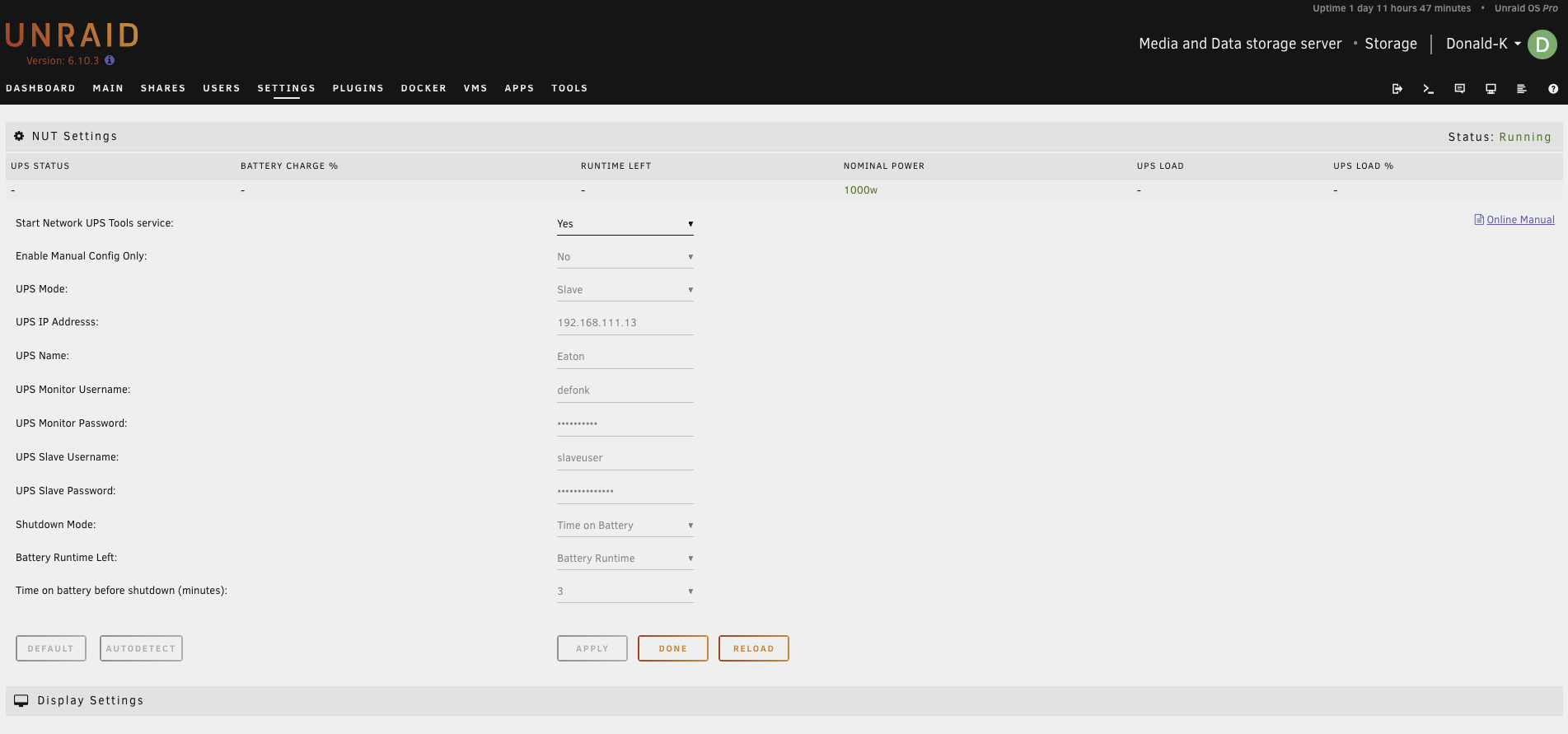

This is my first question post. If there is anything rude or awkward, I think it's because I'm not from an English-speaking world, so please forgive me.
I searched for "synology unraid nut", "unraid ups slave", etc, but couldn't find a way.
Is there a way to set Synology as a UPS server and Unraid as a slave to make it work properly?
Unraid IP address: 192.168.111.10
Synology IP address: 192.168.111.13
In addition, Synology and the UPS are connected via USB, and the Windows PC is working fine with WinNUT.

Does anyone know how to change the IP address of the nut plugin when running as a netserver?
I'm trying to connect my synology nas to it, but it wont accept 127.0.0.1 as an ip
The "netclient" machines must use the IP address of the "netserver" machine, not 127.0.0.1.
Yeah but if I input the correct address it cant connect, bc the netserver is setup with 127.0.0.1 and is greyed out so I cant change it.
Edit:
Got it working!
Followed this and pieced it together!
