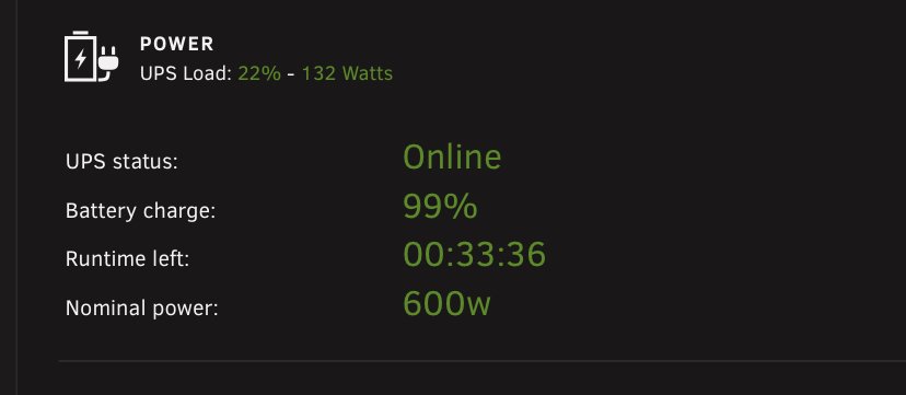

entered what you said but it still doesn't display anything in Runtime Left.
i've tried runtimecal=300,100,600,50
then i thought, go further with runtimecal=450,100,900,50 [based on 15 minutes]
but it still doesn't display anything. :(

3 minutes ago, Jammy B said:
@SimonF
Works for me
This is my config. I have Powercool 2000VA. Guessing you did update once you change the ups.conf and it takes a min or so before it appears + you need to refresh page.
[ups]
driver = nutdrv_qx
port = auto
default.battery.voltage.high = 40.40
default.battery.voltage.low = 31.20
default.battery.voltage.nominal = 36.0
6 minutes ago, SimonF said:
Works for me
[ups]
driver = nutdrv_qx
port = auto
nice! just logged back in and it has it now.
What do you think to my 450,100,900,50?
should I reduce it to match yours?
Guess should be 900,100,1800,50 for 15 mins full load. but i would go with values you are hsppy with.
thanks, the figures don’t make sense. I’m glad I asked.
Don’t worry. I’m not going to hold you to figures. UnRAID will power off 5 minutes after being told it’s on battery.
I just didn’t want it to panic it only had 5 minutes of capacity when the load is only 20-25%!
Edited by Jammy B

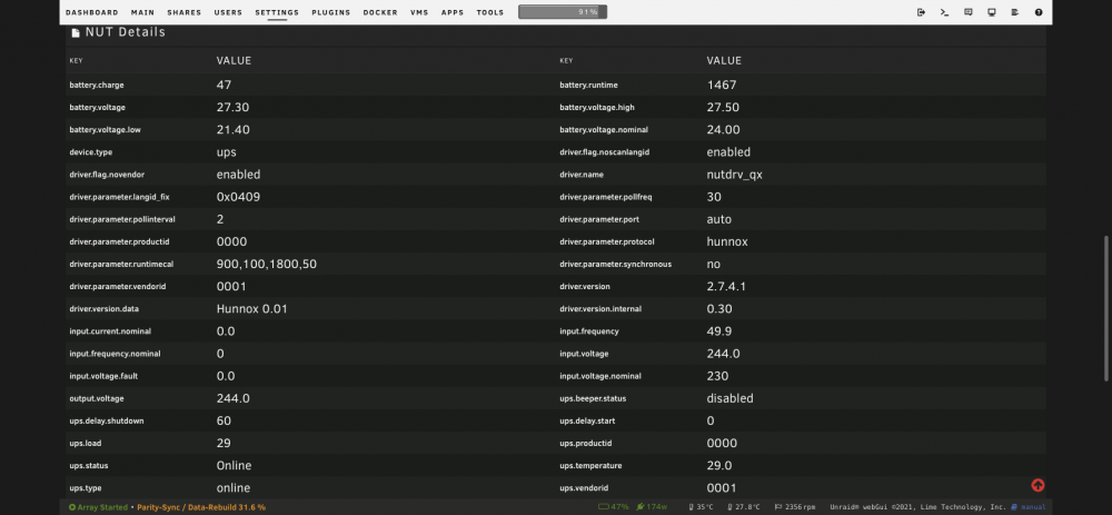

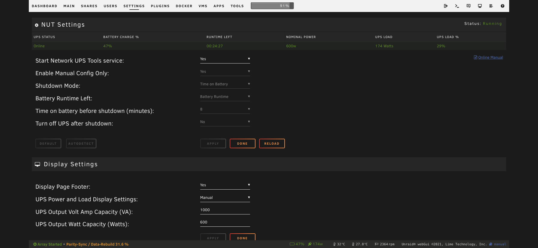

@SimonF
had read errrors last night so done the usual power off, pull the drive, power up, start/stop array. turn off, reconnect and power on and re-build.
but i noticed NUT reporting 0% and charging. [its now on 1%]
i didn't touch the UPS, nor turn it off.
any ideas? normally a power cycle wouldn't mess with that.
11 minutes ago, Jammy B said:
@SimonF
None that I can think off what does the NUT detail show?
nothing jumps out at me.
Looks like the ups is reporting charge as 47%
/usr/bin/upsc ups
