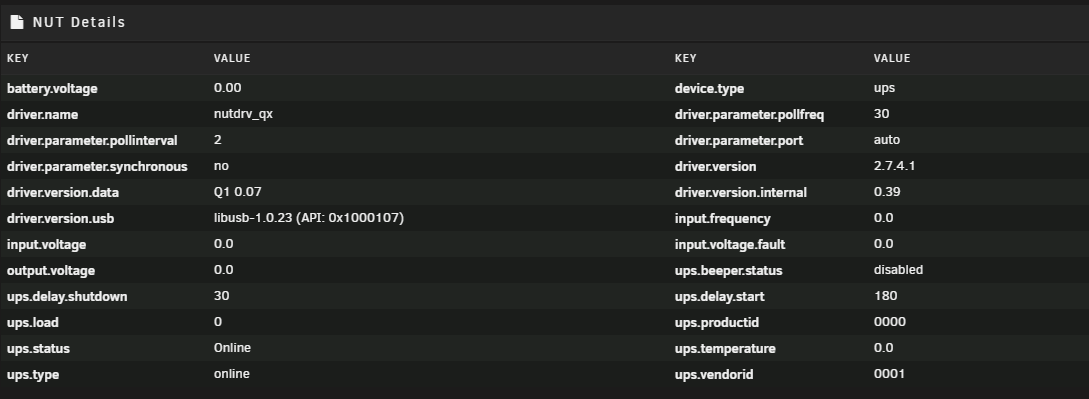

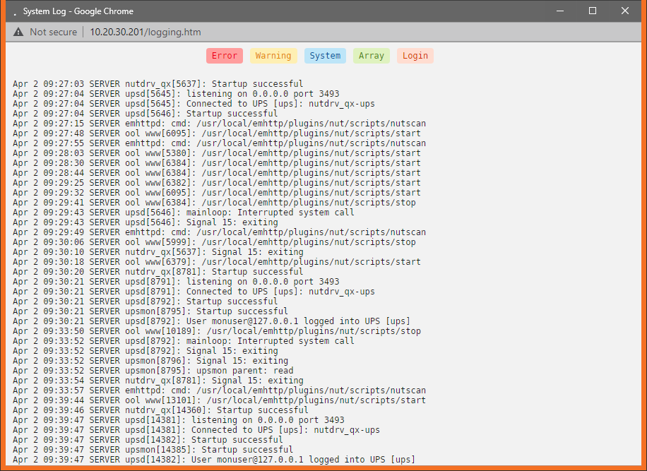

i've posted this in General Support but it might get a bit more NUT attention in here:
ok, so against my better judgement [i just wanted UPS protection that i currently lost from the broken down one] i ordered the PowerCool 1000VA
plugged it in and used AutoDetect in NUT and it detected:
but it kept setting the driver to blazer [which reading in the NUT manual - LINK is what is it], but then further reading and googling found this:
Discussion on the Powercool and the nutdrv-qx driver
GitHub
so put this [without quotes] into the ups.conf in the editor at the bottom of NUT settings and set USB driver to custom nutdrv_qx
and that is the limit of capabilities.
has anyone managed to get Powercool UPS to work with NUT?
a little surprised as its such a budget/cheap UPS in the UK that if it were to work easily, it'd be a no-brainer for UK users to get one!
any advice anyone can offer, i'd appreciate it!

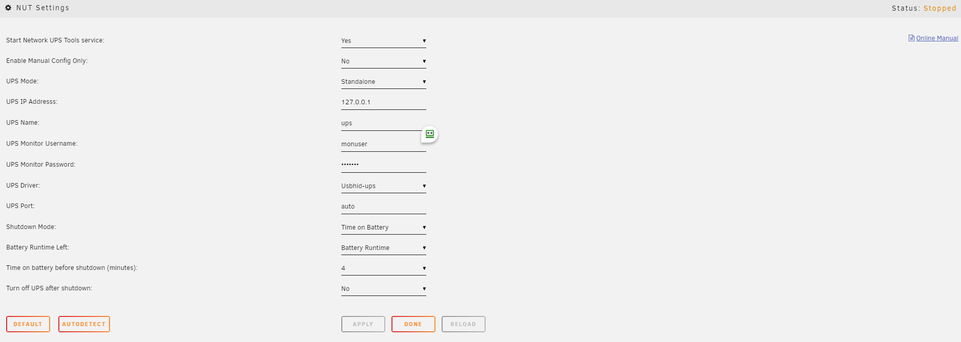

I have a CyberPower 1600 UPS. 'VP1600ELCD' which is connected via the supplied USB plug.
It worked fine in the built in UPS section.
I want NUT so I can also tie it in with home assistant.
Anyway.. I have it up and running and can see it in home assistant.
My problem is that it seems to just die randomly.
Usually a reboot will fix it however sometimes it again just dies.
Basically it it is working as intended and then it just stops reporting anything and shows all '-' and N/A in the little page footer bit.
I try a 'reload' using the button in the NUT settings but it doesn't come back.
I have set the built in UPS settings as noted in the fist post.
Anything else I can try? Any ideas

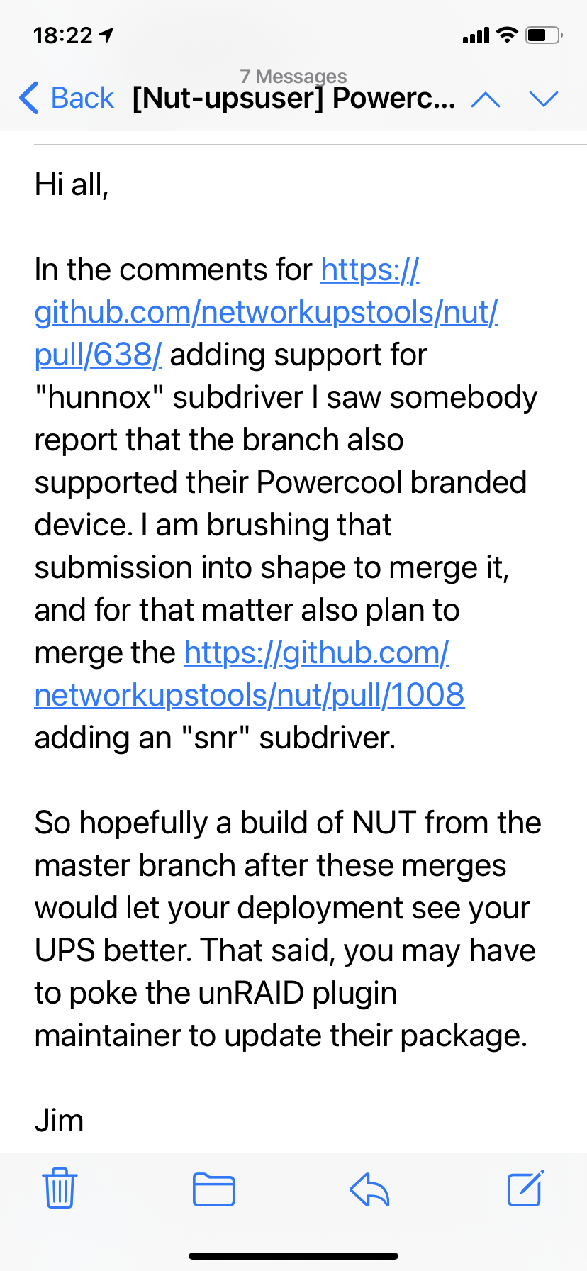

since @dmacias doesn't seem to respond to PMs or mentions in this thread.
how does one update NUT to incorporate latest driver additions that the NUT makers have made?
I'm keen to get the Powercool UPS i have working with it and from the NUT mailing list, they have done some development that could mean that unRAID would be able to communicate with it with a new driver without me having too much issue.
i just don't know where/how to begin adding in the relevant bits to enable this possibility.
any ideas?
