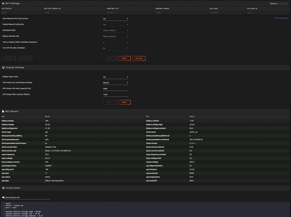

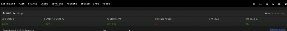

hi, I just get used to Unraid and installed the NUT plugin. I was wondering about the red "w":
306624537_Bildschirmfoto2021-06-28um13_10_34.thumb.png.6fb7243e7bc53e7a67b8e6172c3073d2.png
any hints how to get it working without any red warning signs? ;)

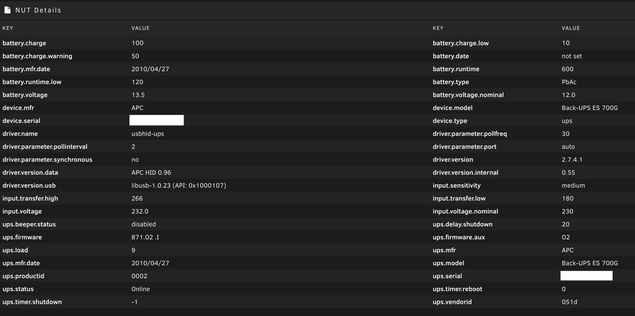

In Addition here are the automatically detected details of my APS UPS:
1903180557_Bildschirmfoto2021-06-28um13_10_16.thumb.png.eb6125fb39d90dc30285664783515e3c.png
I have looked at the code. The red W is showed if the ups.realpower.nominal is not reported and hence no value.
If you change options to manual and specify VA and Watts values will be shown and calculated.

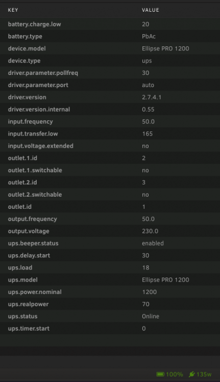

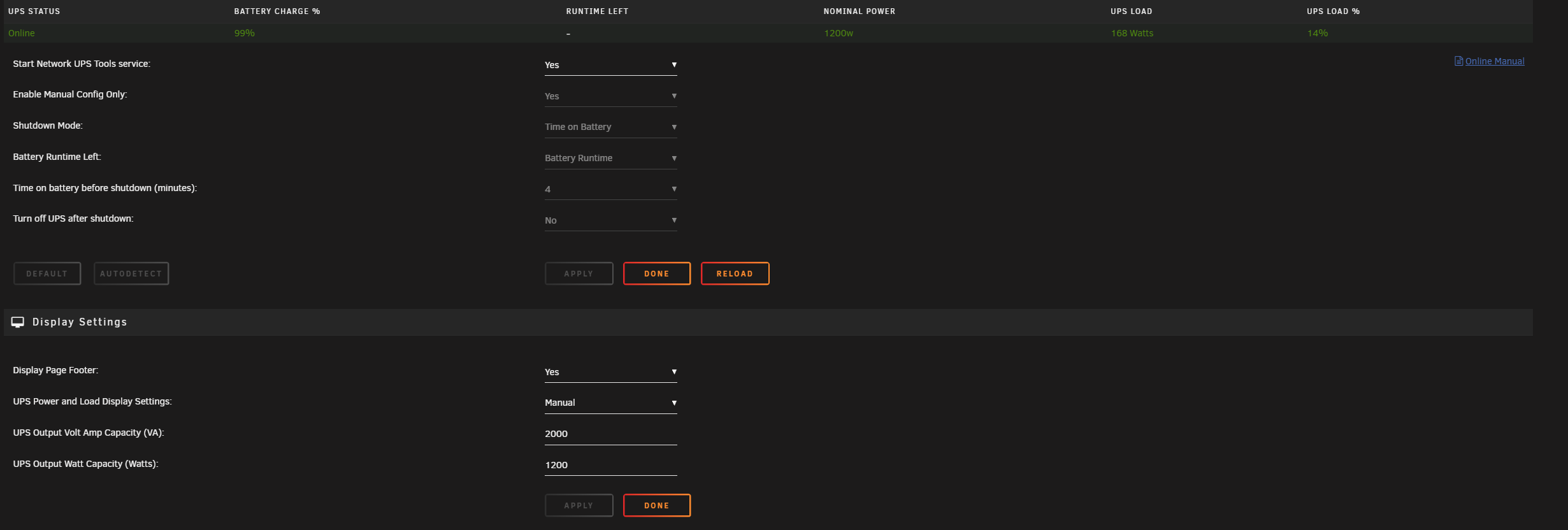

11 minutes ago, SimonF said:
What value shows on the status in the nut settings.
If you change the power load value to Auto does it show 95?

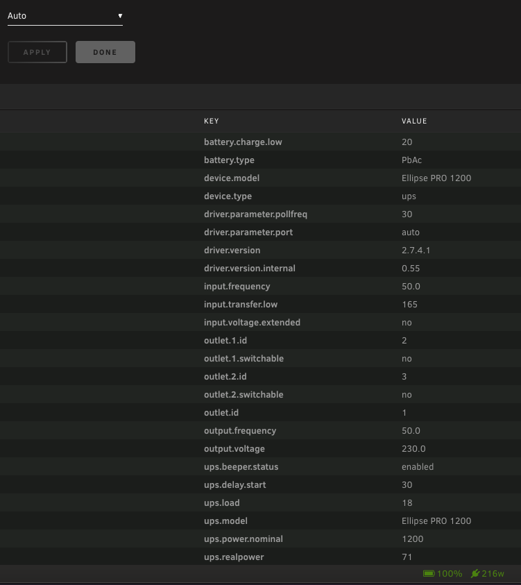

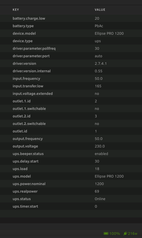

As said with Auto it is even worse:
Power consumption is at 69W and it shows 216W within the footer.
622189796_Bildschirmfoto2022-02-15um20_07_01.thumb.png.bc808d380076e7cc6bc7809bac6f7a63.png

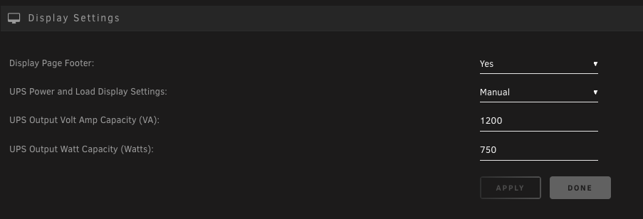

Here with mentioned manual settings:
1964344039_Bildschirmfoto2022-02-15um20_06_40.thumb.png.0b4599684c4f5fb3a6713c43effd725b.png
1638348613_Bildschirmfoto2022-02-15um20_06_45.png.3ffa77c728384d6670943e0d826f8349.png
What do you get if you zero VA and Watts apply. Then change to Auto?
Changed to manual, set both to 0 and then back to Auto. Doesn't change anything. :(
1746983190_Bildschirmfoto2022-02-15um20_16_56.thumb.png.a7c8425e2bf71befe24fc71d9cc3d3b3.png
1586875571_Bildschirmfoto2022-02-15um20_18_21.thumb.png.7f661f741c411237516d6879ed18b45c.png
FYI @Ford Prefect

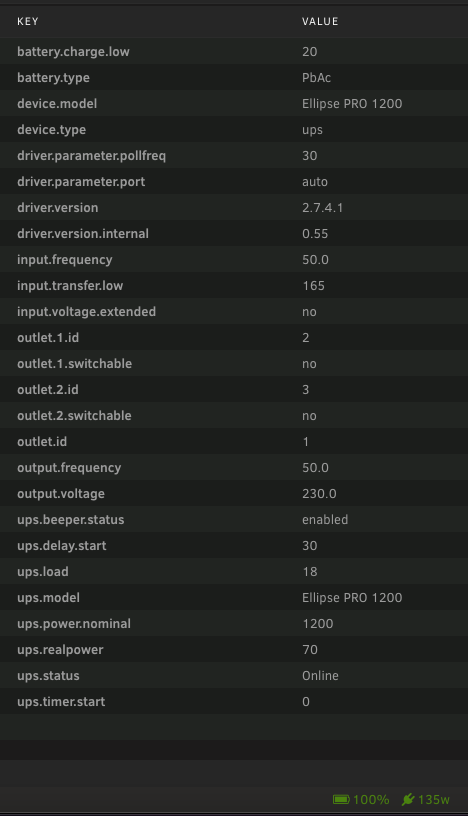

50 minutes ago, Skylinar said:
Thanks, let me know if you need further input!
Ok I can see the issue it is taking 1200 * 18% which gives the 216 but unit should be VA not watts.
if you set watts to 750 manual it will be 135 for 18%.
It doesnt read the realpower, not sure why not used and why there is a big difference been calculated and real as 18% for 750 is not 71.

Does your ups report ups.realpower?
Seems to me, that there is something wrong or mismatches with values from Eaton USV's calculated in the backend but nonetheless we don't need it to be calculated because the right value is already in place with ups.realpower.
Is there a way to force the footer to use the value of ups.realpower? If yes that would be a great workaround atm.

Yeah not saying the values are correct just how the code is calculating. And the reason for the red W on the status line.
Yes, it does and that value given is in the right ballpark...just now - external: 143W  vs. ups.realpower: 150W
...although being higher than external where I'd expect the opposite🤔

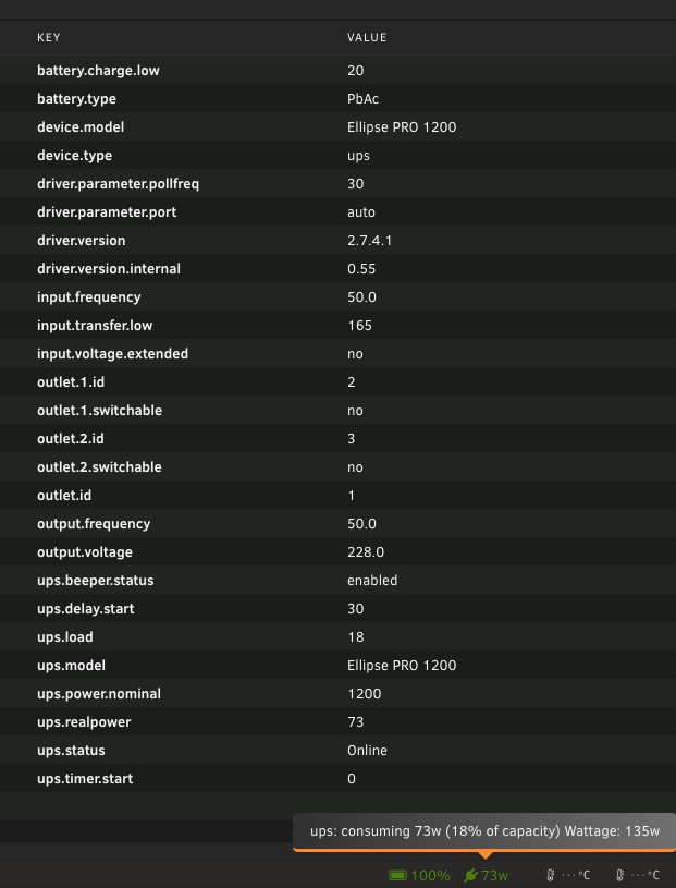

I will look to change the nut_footer.php and post a revision. But you will have to do a manual change to replace the file. and it will not be persistant at reboot or plugin update. I will then create a PR on github. Will look at the status values also. I have found the issue for the watt calculation as not adjusting by 0.6 power factor when set to auto. Gets closer to the real value if you use *.6 on the result.
Sounds good to me!
@Skylinar
Make a backup of the orginal file.
root@computenode:~# cd /usr/local/emhttp/plugins/nut/include/
root@computenode:/usr/local/emhttp/plugins/nut/include# cp nut_footer.php nut_footer.old

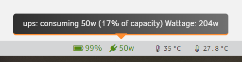

Copy the attached into the same directory. My UPS does report real power so not sure if it will work correctly. I have test output by setting the value and include the existing Wattage if you hover over.
To revert you can just comment out the lines with realpower in the php with a # or copy the old file back.

@SimonF
thanks for looking into this. This workaround works for me.

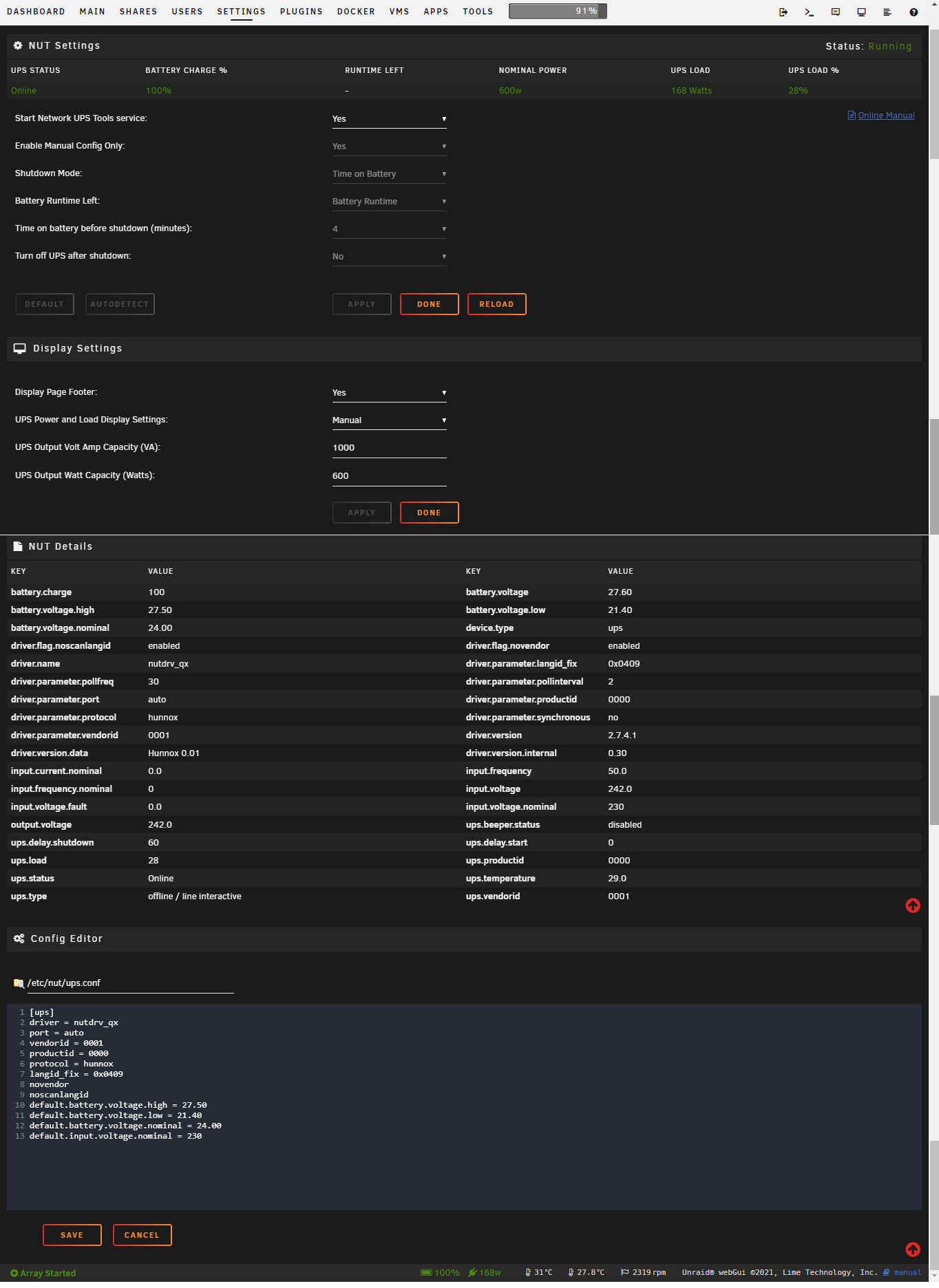

@SimonF
this is my NUT config.
re-reading your question, no. i haven't got "Runtime Left" working.
its the last part of my puzzle to enable my Powercool 1000 to be fully displayed.

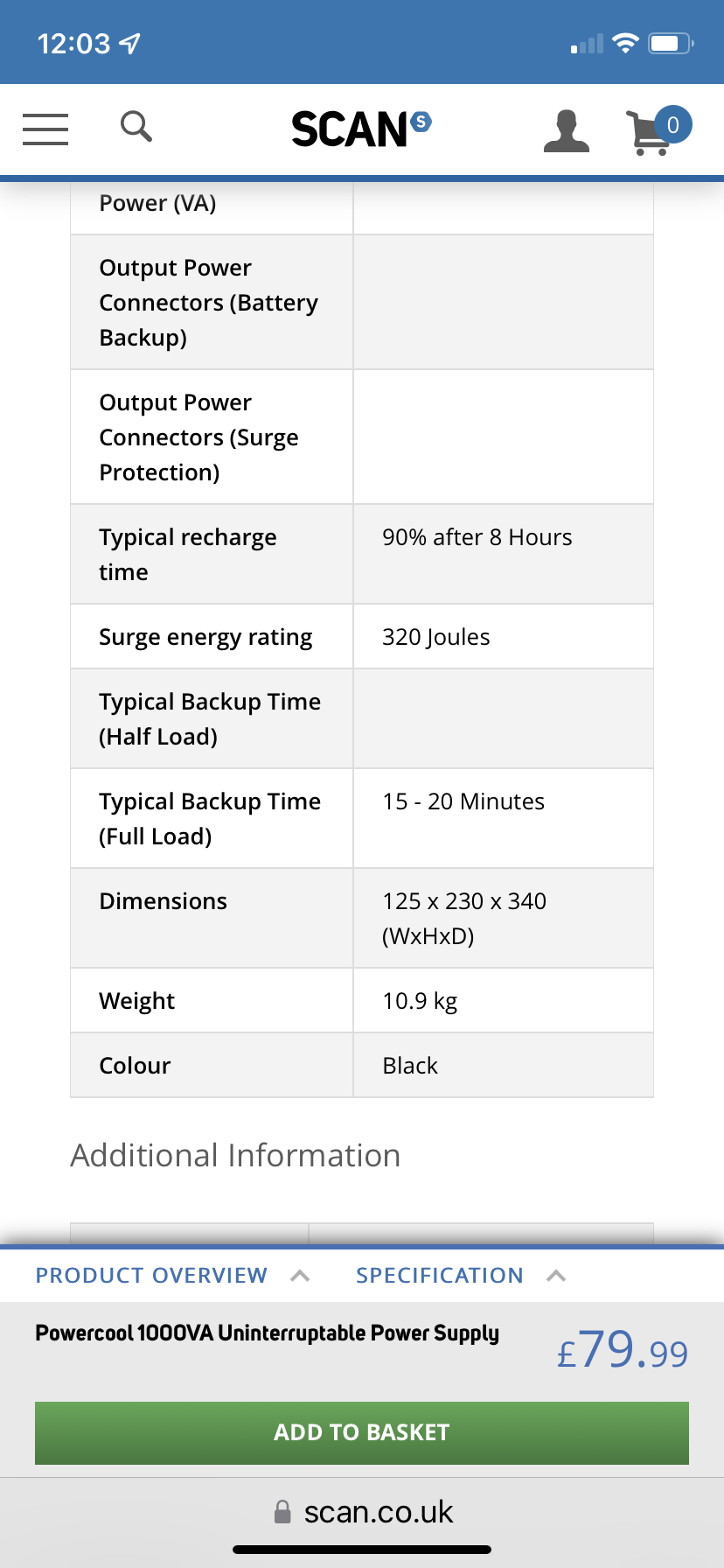

Looks like Powercool doesn't report runtime so it needs to be calculated, So I looked at the driver source and documentation and found the way to get it display. I am struggling to find estimate runtime for the UPS on full load and half load. as does seem to be in Powercool documentation.
You need to add this to ups.conf
runtimecal=300,100,600,50
First number is duration in seconds, next is load 100%, Value for next load value in Seconds and finally load, i.e. half.
@SimonF
if it helps. It says 15-20 minutes at full load on battery.
