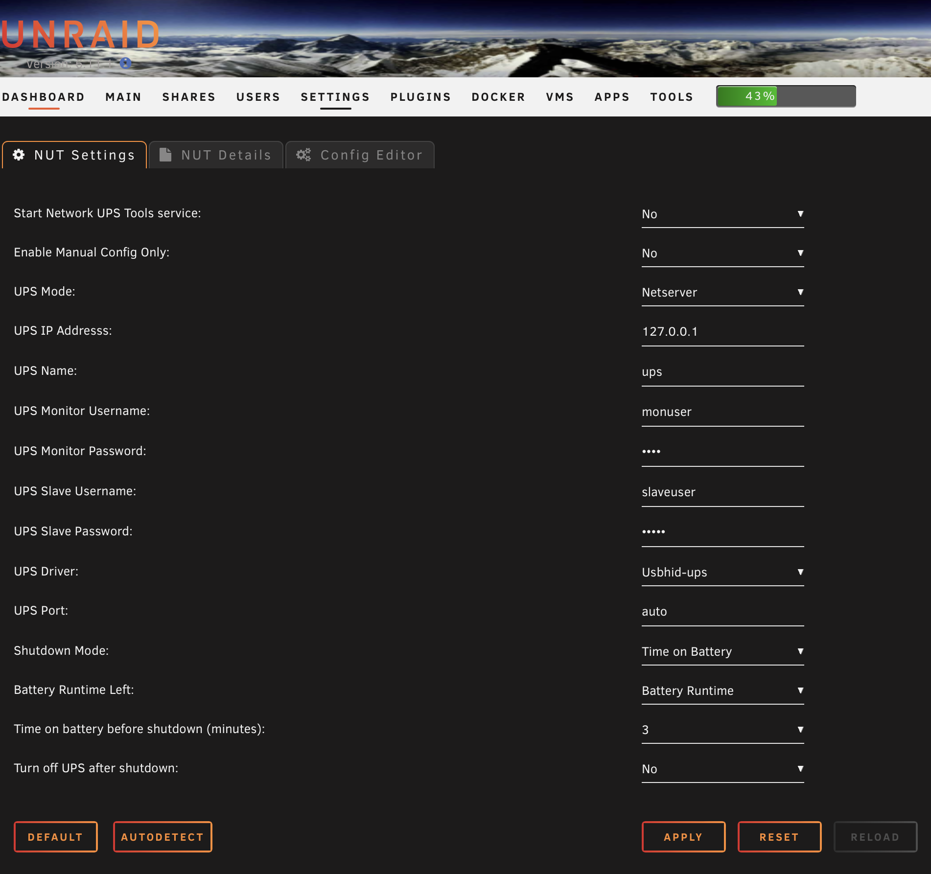

How do I setup my UnRaid as the NUT master. I change the UPS mode to net server but I can't change the IP from 127.0.0.1 to actually the IP of this UnRaid?  I need this to be the master so I can have a client setup to this master.
I use the manual config. but the IP address is not used for the master as far as I can remember. My two slaves have the master IP.

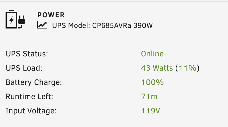

For anyone interested I did a quick-and-dirty tweak to match the display formatting to 6.12's default:
Requires changing two files, presented below in diff format.
nut_status.php:
Spoiler

You just need to update to my version of NUT in CA for 6.12
Unraid 6.12 introduces an API for adding elements (tiles) to the dashboard.
Besides the new layout, plugins need to be updated to use the API, the old way of hacking in to the dashboard does not work anymore.
Right these tweaks are to your plugin (thanks by the way, works beautifully.)
Did I post in the wrong thread?
Ah so your changes are to make it match the APC stock dashboard. May look to have as an option so people can choose.
Thanks for the Diffs I will review.
I thought the changes you posted where to fix old plugin version on Dashboard, hadn't looked at the code.
Looking at your changes, With nut I think some of the devices will not report model mine doesnt as it will be dependant on the Vendor
Ah. I only have the one UPS so I can't test what's particular vs generic.

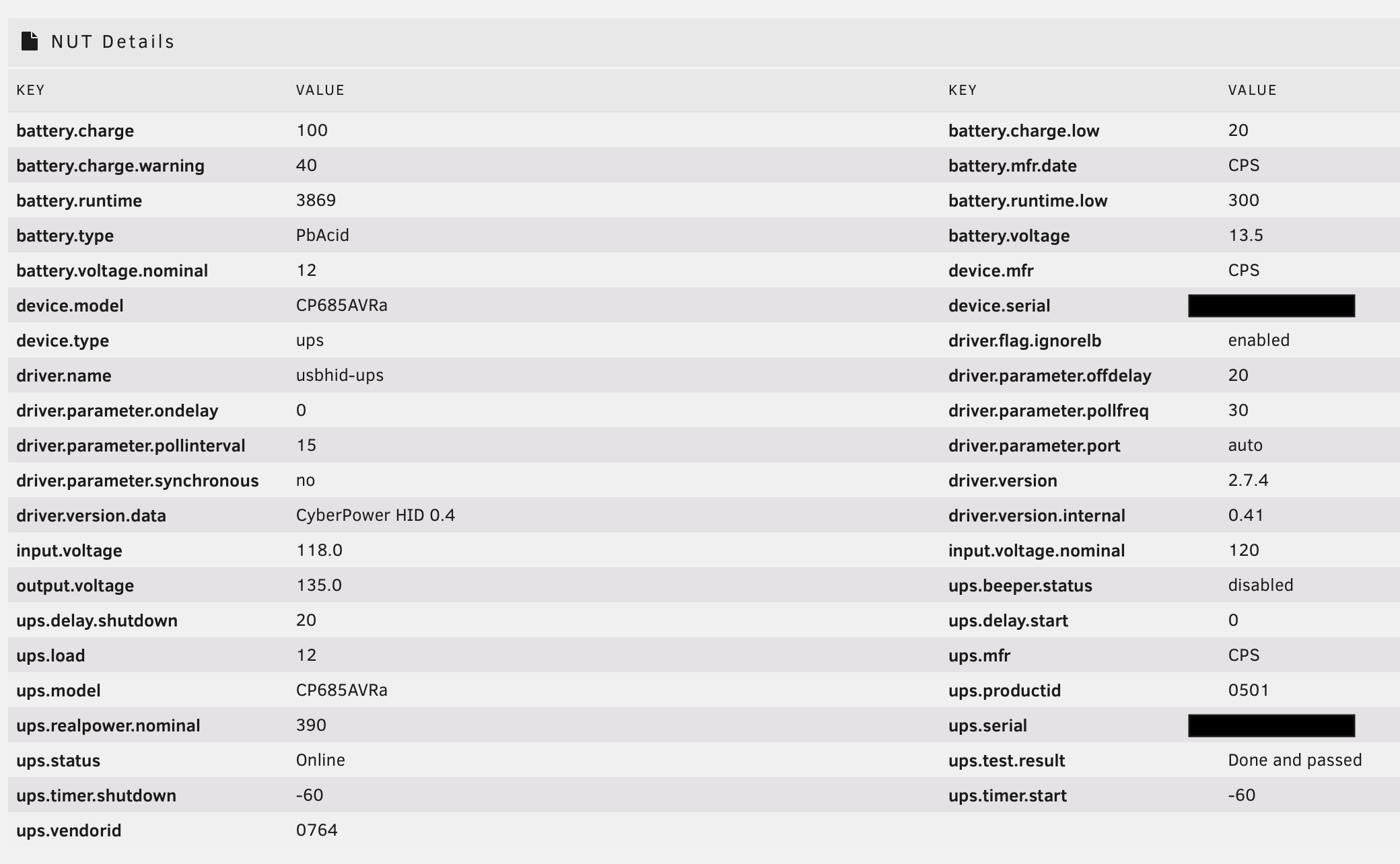

Here's my details page for reference:
444670466_Screenshot2023-03-21at8_06_11AM.thumb.png.471894ee7ad90ad1f19464df7a77783f.png
