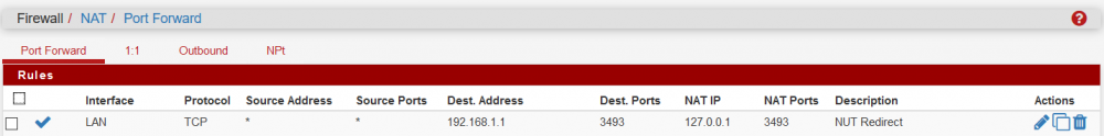

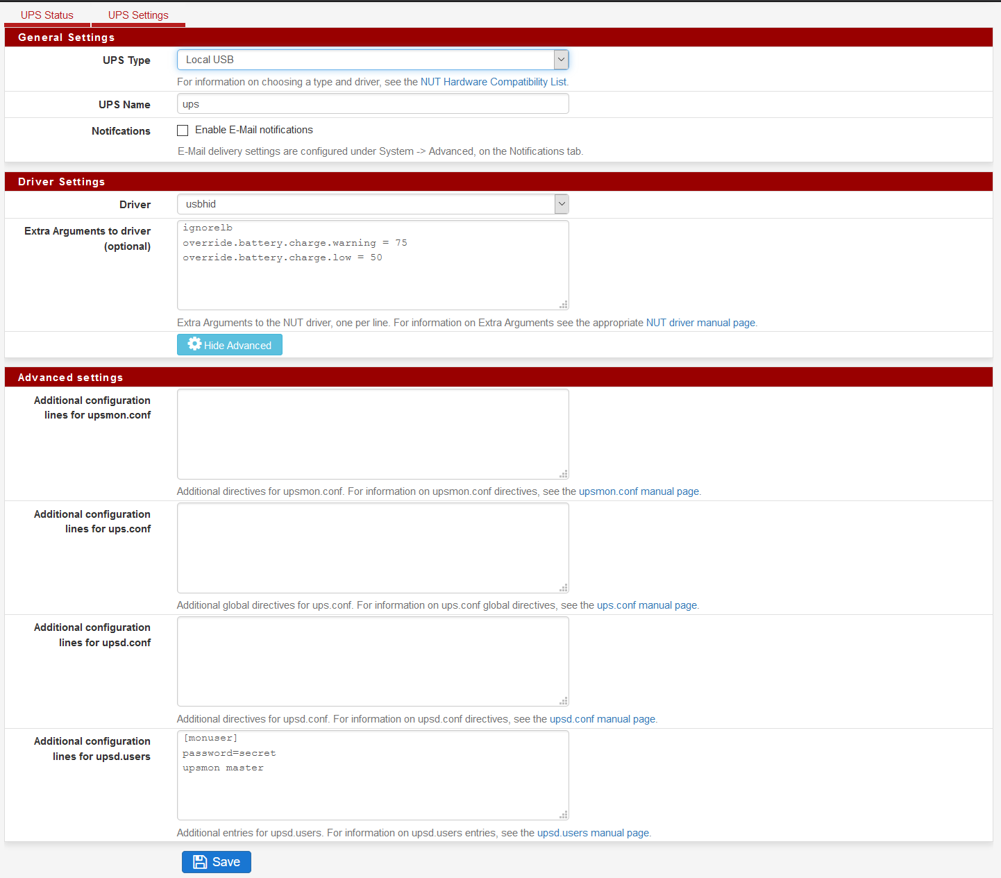

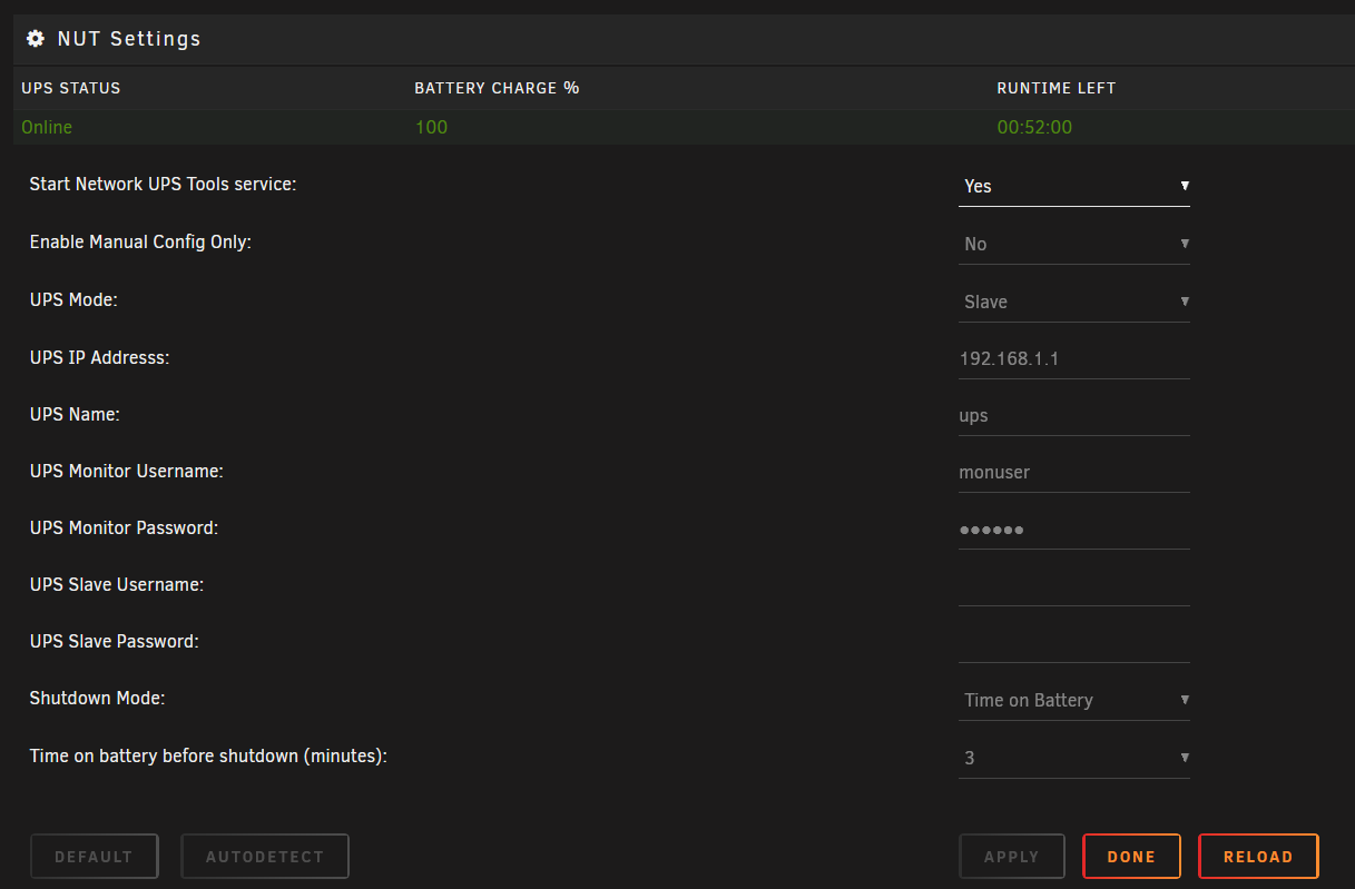

3 hours ago, mikegeezy said:
@cybrnook can you please explain the steps required to setup NUT on pfsense?  I've got NUT running just fine and talking to the UPS, but I can't manage to get unRAID to connect as a client.  I've added a slave user to upsd.users.  I was thinking maybe it needs a LISTEN directive to allow an incoming connection from unRAID, but that just breaks the connection between pfSENSE NUT <-> UPS.  I was thinking it needs a MODE=netserver in nut.conf, but seems I'm missing a step there.
I would love get them talking, seems like I'm overlooking something simple.  If you've got the Synology connection working too, I would love to see that as well.  Seems like that needs to be routed through SNMP?
THANKS
I added a firewall rule for the redirect from IP (pfsense as 192.168.1.1) to localhost (127.0.0.1). Not sure it's %100 needed, but wanted to be safe:
pfSense settings ( I am using the ups/secret combo as I have a synology on my network, and they are hard coded for that):
Unraid client settings:
For Synology, choose "Synology UPS server" and then just point it to the IP of pfSense and it should connect since all the prerequisites are already met.
Edited by cybrnook
@cybrnook  My dude thanks very much for the post, that got it going!
The hangup on my end was the firewall rule, once I put that in place the unRAID box connected immediately.  Synology didn't connect right off the bat, so I started digging around in /usr/syno/etc/ups and realized there are configuration options that aren't really exposed in the control panel GUI (like the UPS name)

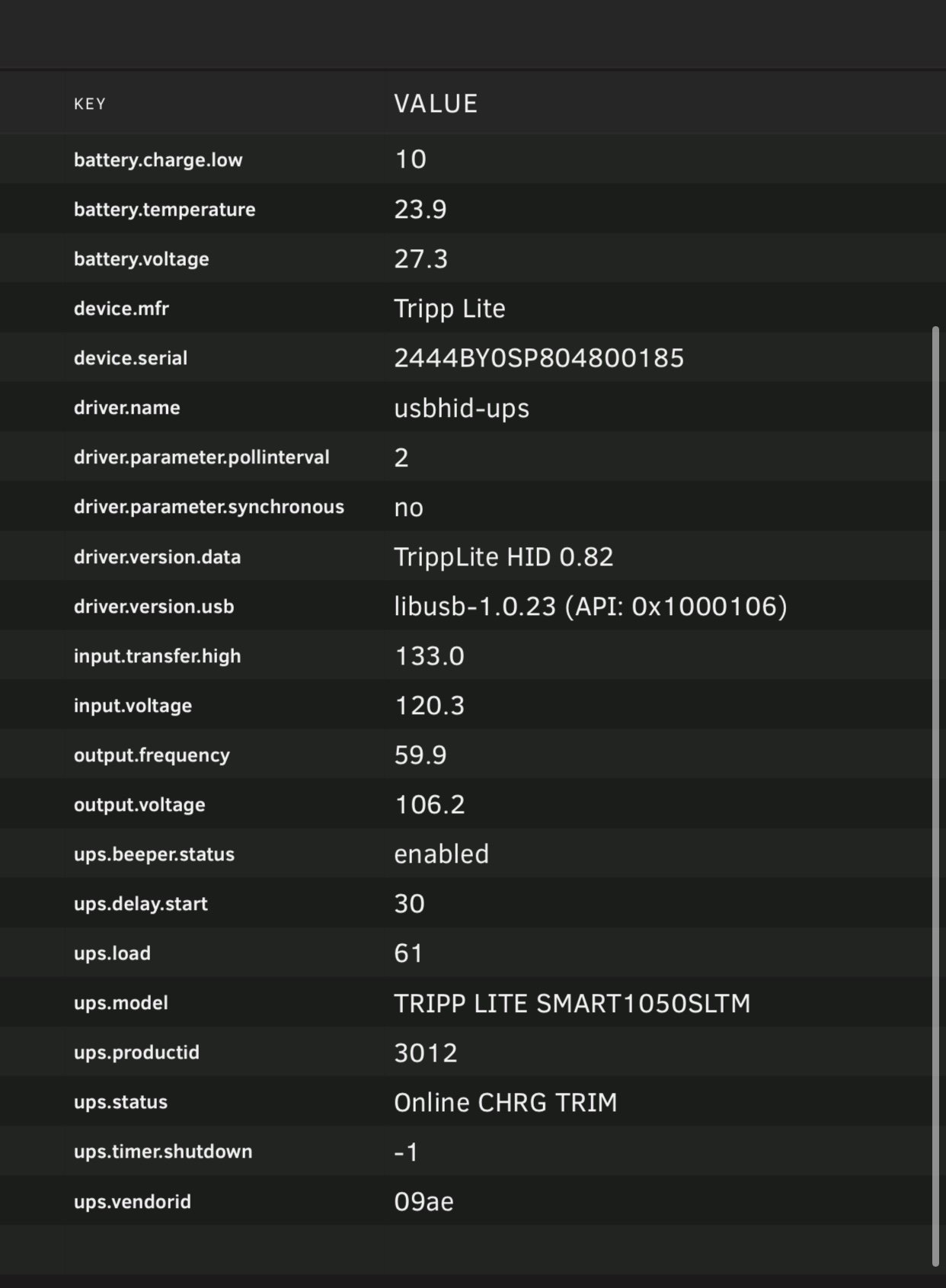

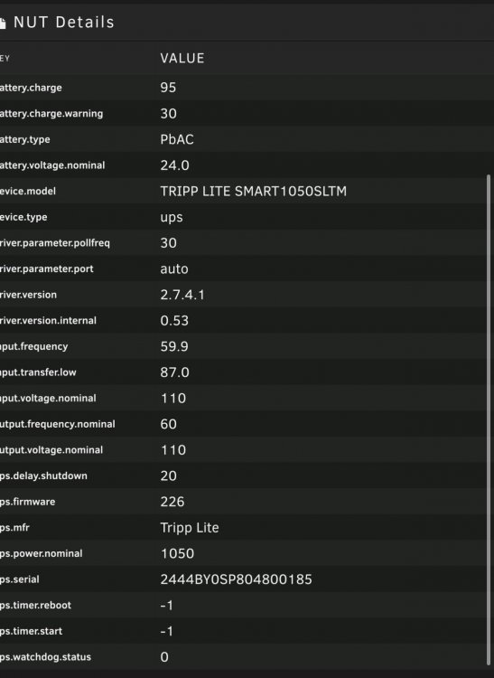

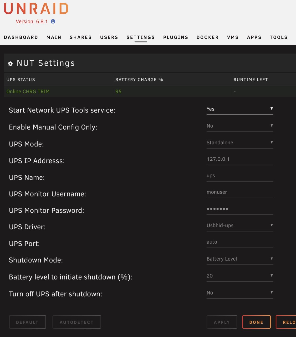

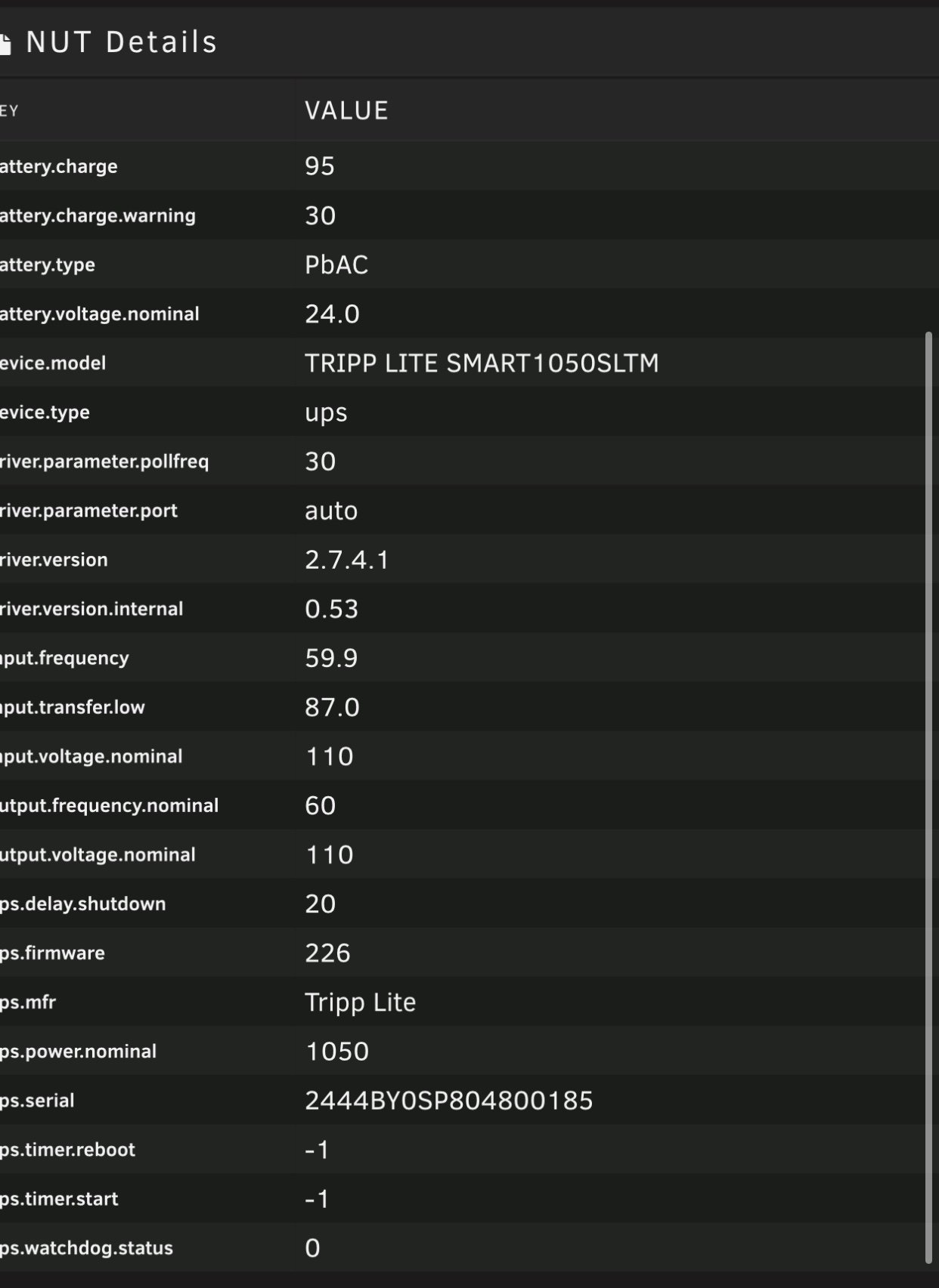

Any ideas on how or where to begin troubleshooting NUT randomly saying that server is on battery backup and shutting down? It’s a Tripplite 1050SLT UPS. I’m positive power isn’t being lost. Did this once last week and once this week. Good news is it’s safely shutting down system; bad news is erroneously and randomly LOL.
If battery level always 95, then you should check / replace the battery. And problem may relate mains unstable which trigger UPS on battery too.
No it normally sits at “100” [emoji848][emoji2373] I may try another Battery Backup; same model Tripplite though. Need to buckle down and buy a APC I guess but $$$

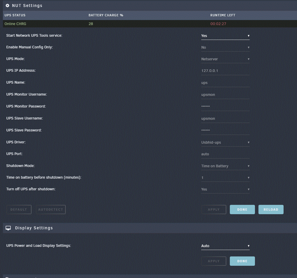

Any idea why a NUT shutdown of Unraid would take 10 minutes +, when a normal manually induced shutdown from the GUI takes 1/2 minutes? I have an Eaton 5P plugged into a Synology. UnRaid and PFsense are slaves and getting all the info. Pfsense box shuts down fine before battery dies but Unraid server (R210ii used for VMs and Docker) takes too long loses power ungracefully; meaning parity checks etc.
I have tested 8 to 10 times this afternoon and GUI shutdown can be accomplished quickly, NUT induced shutdown takes forever. I have a monitor plugged into the UnRaid server and can see it has begun shutting down 5 seconds after going onto UPS power but still takes too long.
"Waiting 90 seconds for graceful shutdown" then shows "Forcing Shutdown" for an eternity before usually losing power. UPS has ~15 minute battery.
I'm just trying to work out what happens differently between a GUI shutdown and a NUT slave shutdown to cause this undesirable behaviour?

This morning I have tested the following, Unraid (R210ii) as NUT master, Synology as NUT slave, PFsense as NUT slave.
Same issue occurs, if not a few minutes worse. Setup NUT on unraid to shutdown after 1 minute on battery. pfsense seems to start it's shutdown sequence at the same time. Synology, I set to after 45 seconds on battery.
Synology and pfsense automatically go off nicely within 2 minutes of power being lost to UPS. UnRaid hangs at both the "Waiting up to 90 seconds for graceful shutdown..." and "Forcing Shutdown". For around 12-15 minutes before powering off. If I "Shutdown" in the gui, the R210ii is off within 2 minutes.
I can try pfsense being the NUT master, but with similar experiences being had with synology being the NUT master, and now same with unraid server being NUT master, I'm inclined to believe it wont make a difference. Something in the NUT unraid plugin shutdown sequence is causing the delay.
Anyway I can troubleshoot this lengthy delay?

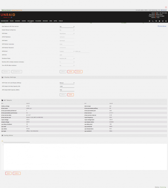

Hello,
Im trying to configure NUT to connect to my Networked Eaton 5P 850 using SNMP. But when i configure it and try to start the service i see this:
Writing nut config
Updating permissions...
Network UPS Tools - UPS driver controller 2.7.4.1
/usr/libexec/nut/snmp-ups: error while loading shared libraries: libcrypto.so.1: cannot open shared object file: No such file or directory
Driver failed to start (exit status=127)
Any idea?

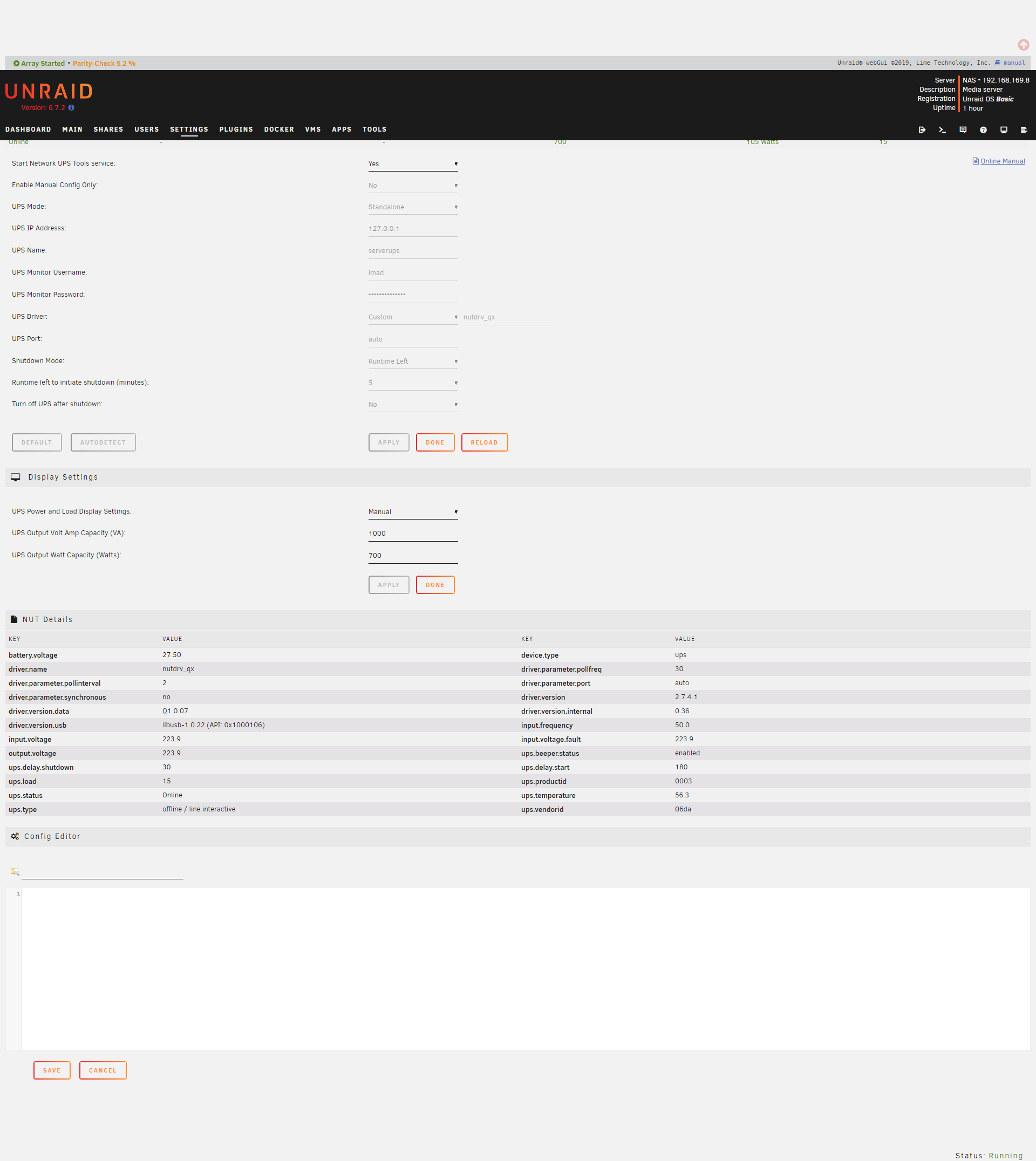

Hello good, could you tell me why the NUT service does not start me, the autodetec detects the sai well but I do not want to start the service and put the generic UPS configuration as indicated and tried to restart the server and nothing attached screenshot
PS Excuse me my inlges I use the translator
Thanks to the end I tried with another sai that I have salicru and with that I worked the first time I already have it working
