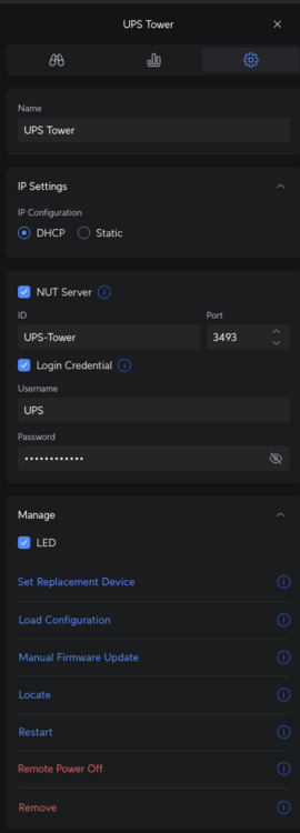

Here you go.
The unifi log doesnt show anything blocked.

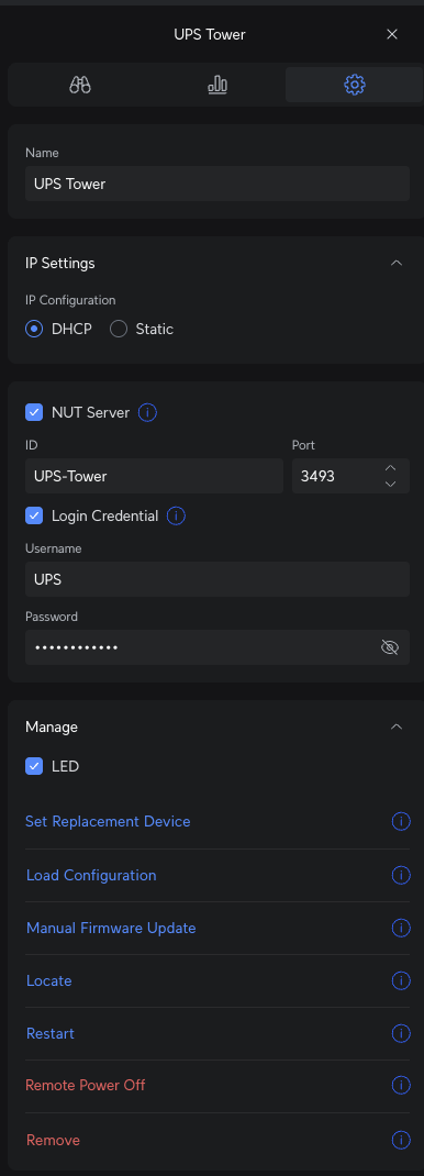

11 hours ago, dam_j said:
Here you go.
Well it seems you got "UPS Name" in Unraid configured to "Tower" but to "UPS-Tower" within UniFi.
Also you should try disabling "Login Credential" as other people had problems with that (see above).
If that doesn't work, try changing as follows:
  • Name to "unifi" (without quotes, in UniFi settings)
  • ID to "unifi" (without quotes, in UniFi settings)
  • "Login Credential" to disabled (in UniFi settings)
  • UPS Name to "unifi" (without quotes, in Unraid settings)
I didnt get the part with "no credentials" in ubi...
Sorry and thanks now it works!!

Just commenting to say that my Unifi UPS Tower connected perfectly when I disabled the credentials on the UPS but used dummy credentials. Thank you!
I case anyone else is having trouble with their Unifi UPS, here are my settings
So helpful, thank you! I was trying forever to get login credentials working and the logs reported a successful login, but kept saying "Current power value: 1" and the plugin didn't report successfully finding the UPS in the unraid GUI at all. Glad it's working without login creds! Within unraid, it seems like you can put anything for user/pass, but there does need to be something (cant be blank).
One difference on my end is that I did enable static IP for the UPS instead of DHCP though
