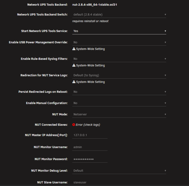

Are there any plans of supporing the new Ubiquiti UPS or is this already available as a custom configuration? When searching the network, it is not found.

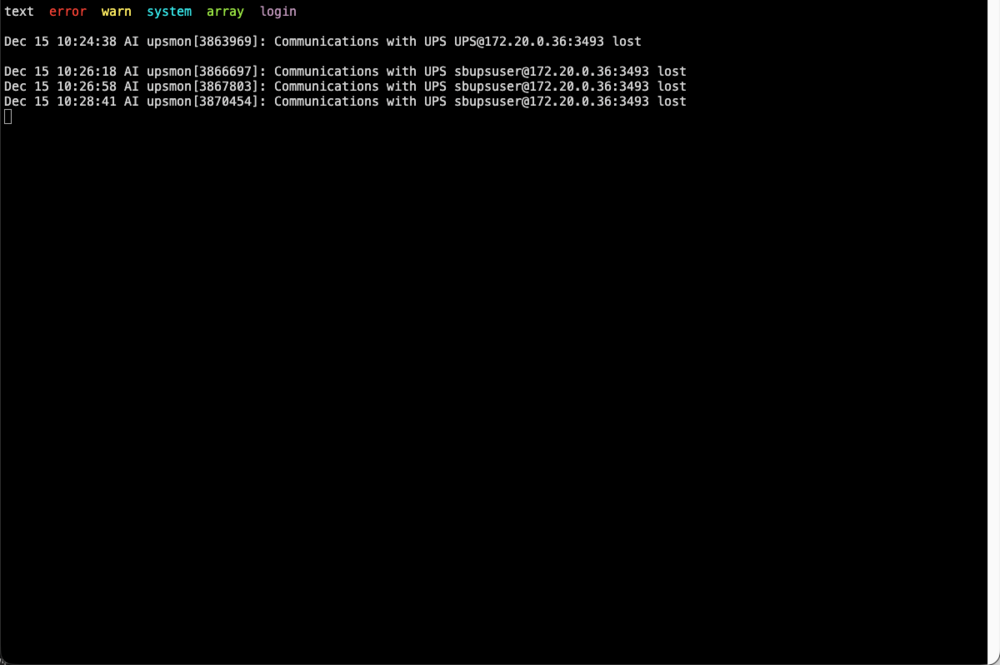

On 12/12/2025 at 4:49 PM, Rysz said:
Thanks. I am able to connect now, but it is not retrieving any informaiton.
Only error i get in the log is this:
I have changed the ID to match the username, and now i don't get the error anymore. But the Unraid server does still not retrieve any information. Its says retrieving information for a short amount of time, and then returns to the same screen again with no data in the dashboard

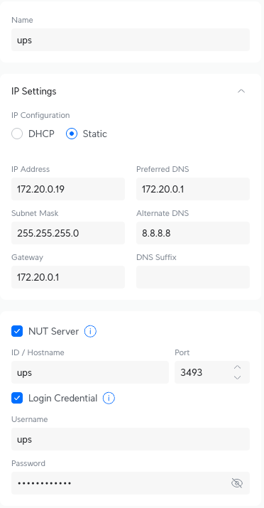

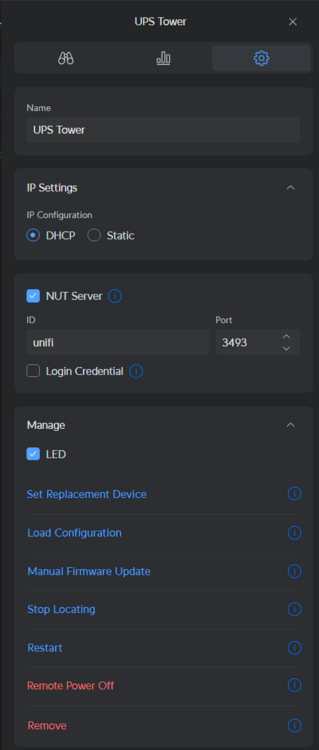

Post a screenshot of the UniFi UPS Settings (in UniFi web interface) and the NUT debug package (can be found in NUT Settings in Unraid web interface).
here you go
Edited by swipbox

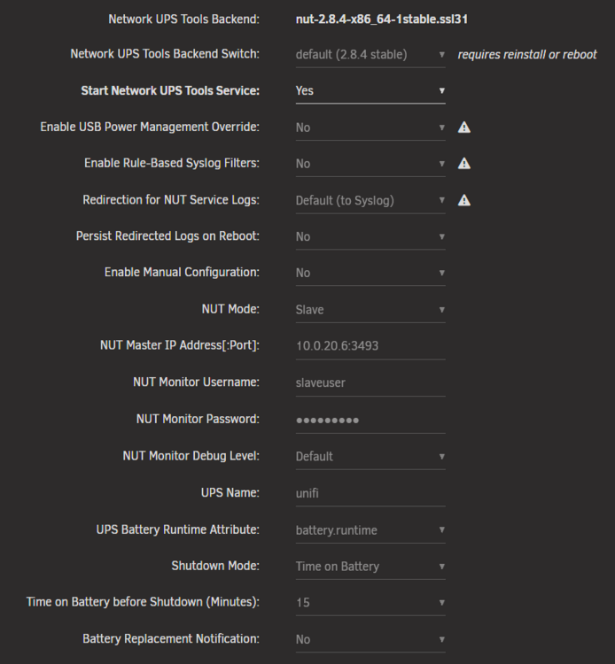

40 minutes ago, swipbox said:
Please try to set it up exactly as in the screenshot (except for IPs):
https://forums.unraid.net/topic/60217-plugin-nut-v2-network-ups-tools/page/82/#findComment-1589967
You need to disable "login credential" as both screenshots show, this is likely the issue here.
Then for the username and password in Unraid NUT just use "slaveuser" and "12345" or something (some bogus values, but not same as UPS name).
On 11/11/2025 at 4:33 PM, mcreekmore said:
I case anyone else is having trouble with their Unifi UPS, here are my settings
Thanks. Now it works.

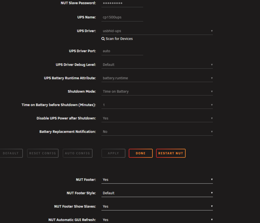

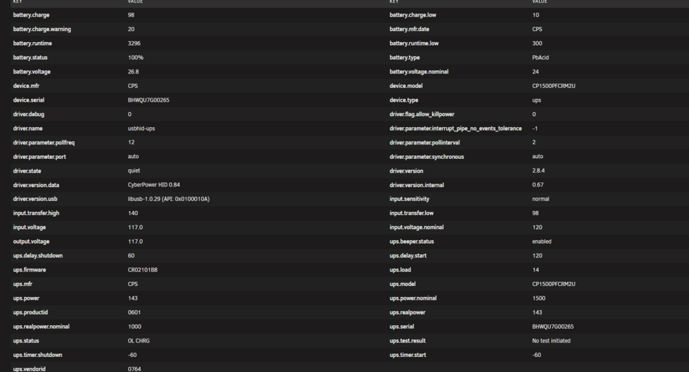

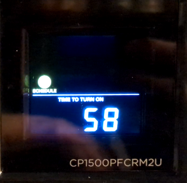

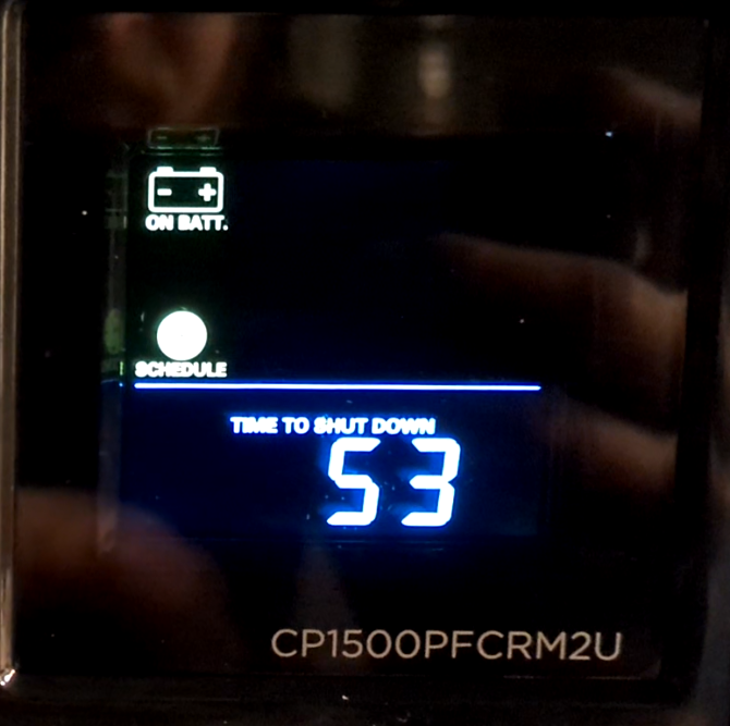

I recently purchased a CyberPower UPS (CP1500PFCRM2U) and got it hooked up to one of my Unraid boxes for testing. All seems to work good, except that the UPS powers back on immediately after powering off (post graceful shutdown of the Unraid box) prior to power being restored. Sequence of events:
  • Cut power to the circuit the UPS is on
  • Unraid NUT is configured to perform shutdown after 1min on battery, this works fine, Unraid gracefully shuts down
  • After graceful shut down, NUT is configured to power off the UPS, this works as well. UPS gives a 60sec countdown and shuts down:
  • Immediately after the UPS turns off, it goes into start up mode with another 60sec count down, then turns on as if power was restored (it was not):
Feels like I'm missing a setting somewhere. Anyone have any suggestions?

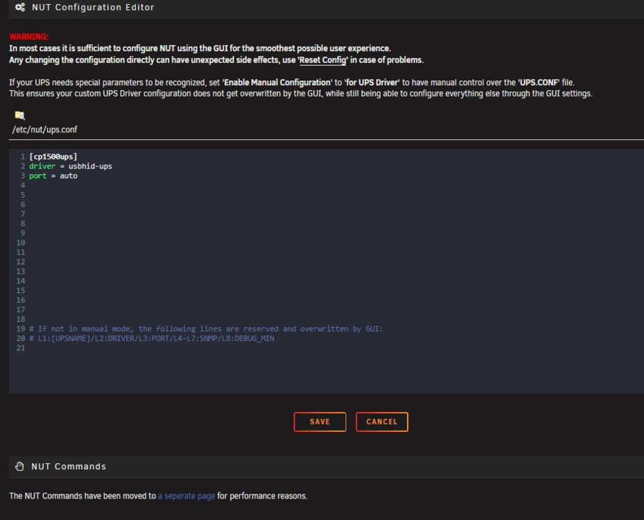

Current NUT config:
Edited by 6stringdesigns
After more digging through the NUT repo, seems this is a CyberPower specific issue, particularly with the ups.delay.start default value in the driver config. Default value is 60 and anything greater than zero seems to cause this issue. To resolve, in the plugin's config, set Enable Manual Configuration to for UPS Driver, then add a new line with ondelay = 0. Save the config then restart NUT. UPS will then behave correctly after it's turned off: will only turn back on after power is restored.
Ref: https://github.com/networkupstools/nut/issues/578
