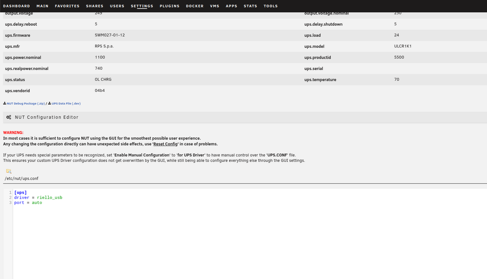

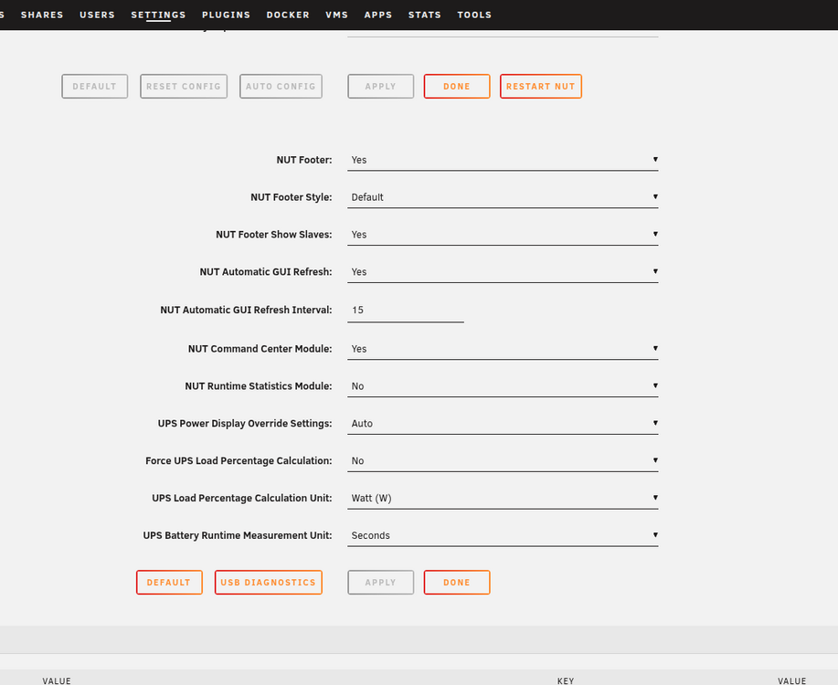

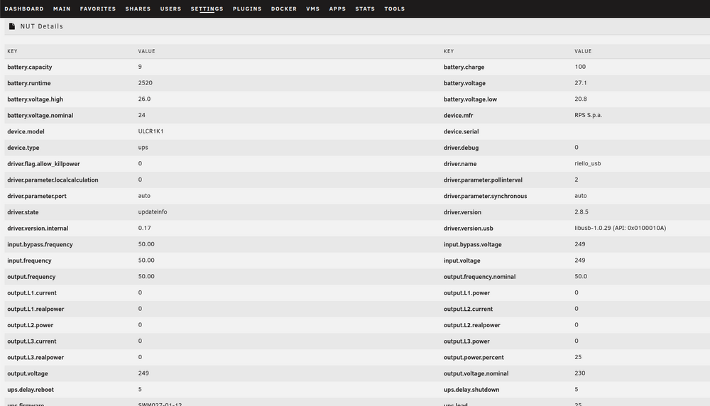

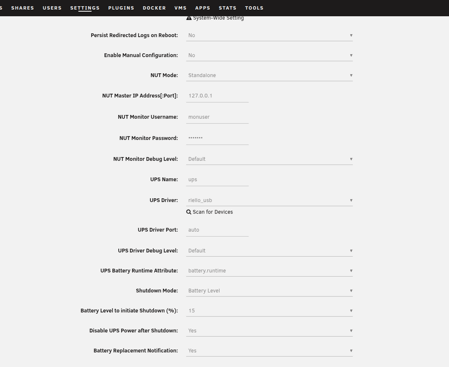

Just curious, I've installed the app, and each morning I'm finding NUT has shutdown my UNRAID Server. I don't see anything that might be causing it, was curious if anyone might have any idea's
I noticed this flag is set to 0 could this be why the UPS doesn't switch off? If so shouldn't the GUI change the flag setting?
driver.flag.allow_killpower
0
@NoRaid99 Thanks for the info. I'll check through it all and post back!
