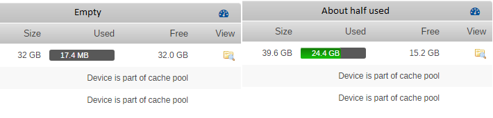

18 hours ago, limetech said:
emhttp/shfs: yet another btrfs free space calculation method
Seems to be much better, at least in a known situation where it was wrong previously, e.g., a 3 x 32GB raid1 pool:
before:
now:
