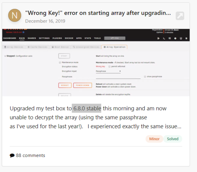

Hello! I hope someone can help me. For the last year my unraid server autostarted the encrypted array automatically by downloading the keyfile from FTP. I used the guide from @SpaceInvaderOne, and it worked well until yesterday. Yesterday the array did not start and showed up the message "wrong key", similar like shown in this thread:
https://forums.unraid.net/topic/87488-new-unraid-server-reporting-invalid-encryption-key-after-reboot/?_fromLogin=1
Unfortunately, I have no idea what went wrong since I did not change anything. I checked the keyfile: With every reboot the keyfile will be correctly downloaded to /root/keyfile as in the guide. I also did not change the password. The password has 11 Characters and only letters and numbers. No special characters. It is very strange because I didn't change anything and the file is in /root.
Any ideas on this?
