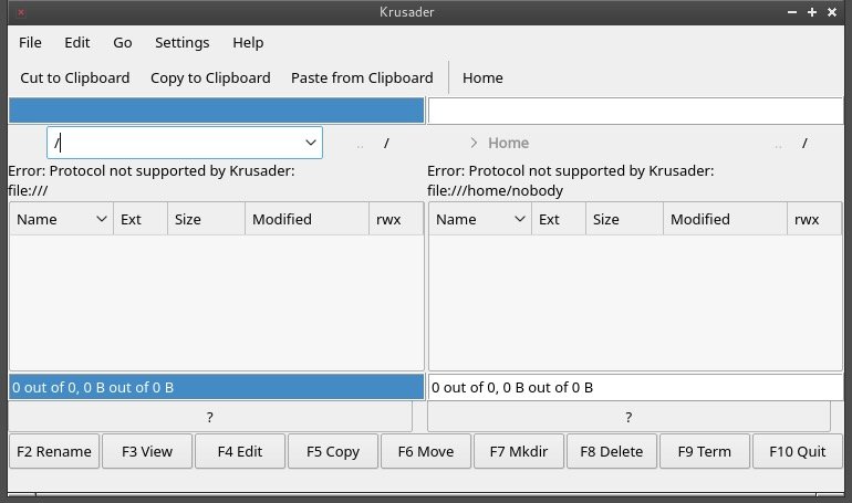

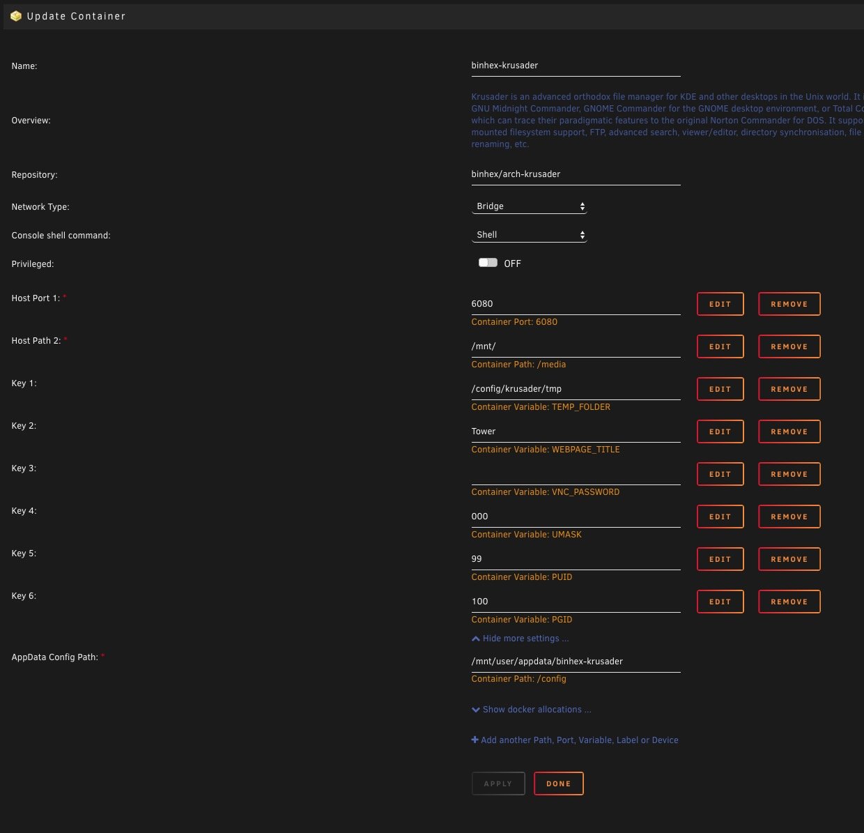

New to Unraid, and I just installed the Krusader Docker and I am getting an error: Protocol Not supported by Krusader. I am using /mnt/ for the /media path.
screenshot / more details might be in order to put some reference to what you are saying

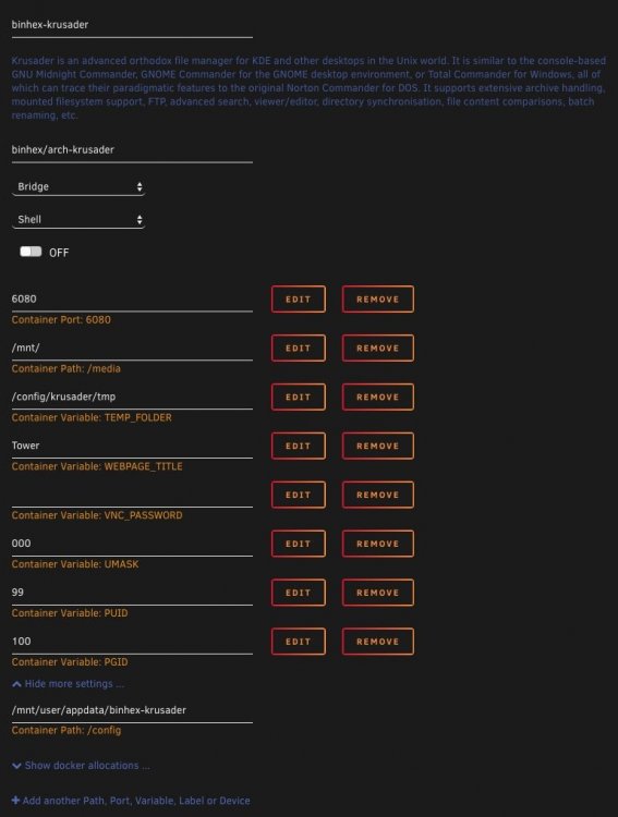

Please see screenshot attached.
This is the Docker setup

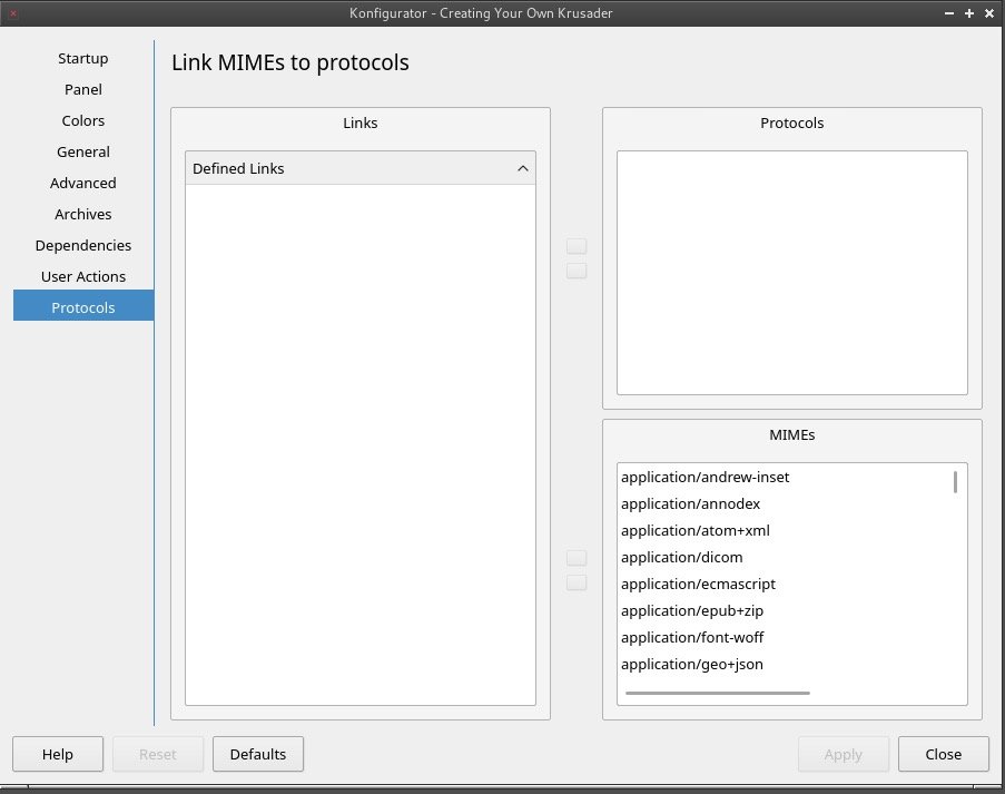

The only place I see anything about Protocols is in the screengrab attached. Not sure where to go from here.

Krusader does not show me any of the shares or files. Just the Protocol error. The screengrab attached is all I get.

This is what I have in the Krusader Settings. It does not refer to the SSD anywhere. Unless you mean some other Setting in another area.

16 hours ago, springsman said:
I unmounted the SSD and restarted Krusader. Still the same error regarding Protocol.

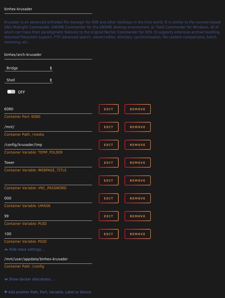

from your screenshot i can see you have switched privileged off, this is required for this container, please set it back to on (the default) and then retry.
Thank you. That did the trick. On the video from Spaceinvader1 (for the older Krusader version) it showed as Privileged as Off. thanks again for the reply.
