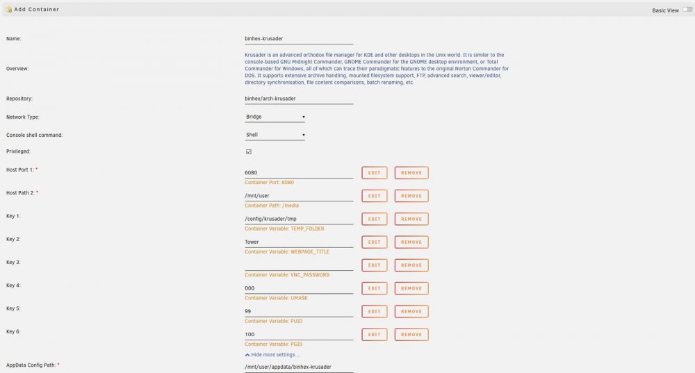

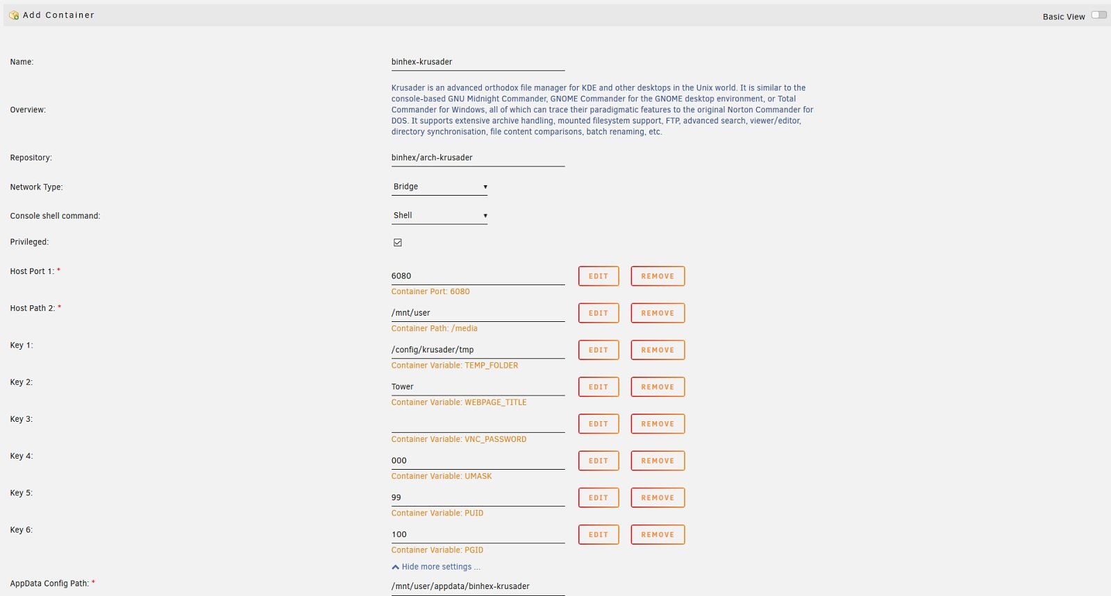

I've been trying to do everything with installing binhex-krusader. I have not seen ever the binhex-krusader Gui to work. And it seems to be 100% useless if the gui won't open. Any ideas?
Docker list when I click binhex-krusader there is only Console option and not Gui.
How exactly did you add it

2 hours ago, JQNE said:
Any ideas?
Since I noticed you had already asked this in the wrong place, I just thought I would mention that you can get to the correct support thread for any docker by clicking on its icon in the Unraid webUI and selecting Support. Or by using the Support link for the docker on the Apps page.
As for your problem, we need more information. See the very first link in the Docker FAQ:

I searched with community applications binhex-krusader and installed it. Used spaceinvaders video tutorial for how to setup krusader.
725466154_Krusaderdockerinfo.thumb.png.d7c4e37292f57aa062bd24e758882ca8.png21603221_ScreenShot2019-02-10at15_19_45.thumb.png.f6a194a77cd6f8dfa1185c9c7c612c12.png809579546_Containercommand.thumb.png.3bac77823a4f6a2425d7b4616e303f43.png
Go to Tools - Diagnostics and attach the complete diagnostics zip file to your next post.
Did you install it via "Get More Results from docker Hub?"
Your screen shot show no icon for it either.  Remove the image, then reinstall it by searching for Krusader.  The template has both an image and a webUI entry set.
Yes I clicked docker hub results when installed on first time. I just removed binhex-krusader and reinstalled it. This time just cliked straight binhex-krusader. Same thing. No icon for binhex-krusader. And also no Gui button.
