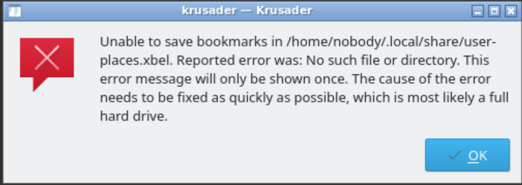

Setup Error:
Hello,
Had to reinstall (deleted ALL parts of previous i.e. appdata entries) but keep getting this error every time I start Krusader container (always acts like it is the first time it is being installed)
(Note: plenty of disk space available)
Then...

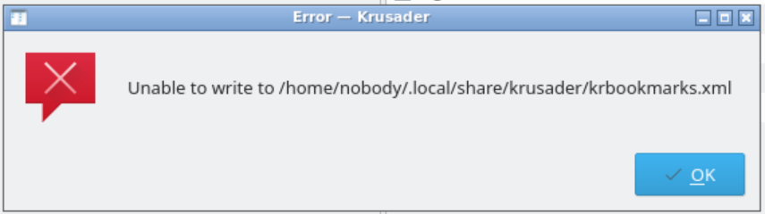

When I try to create a bookmark in Krusader, I get this error.

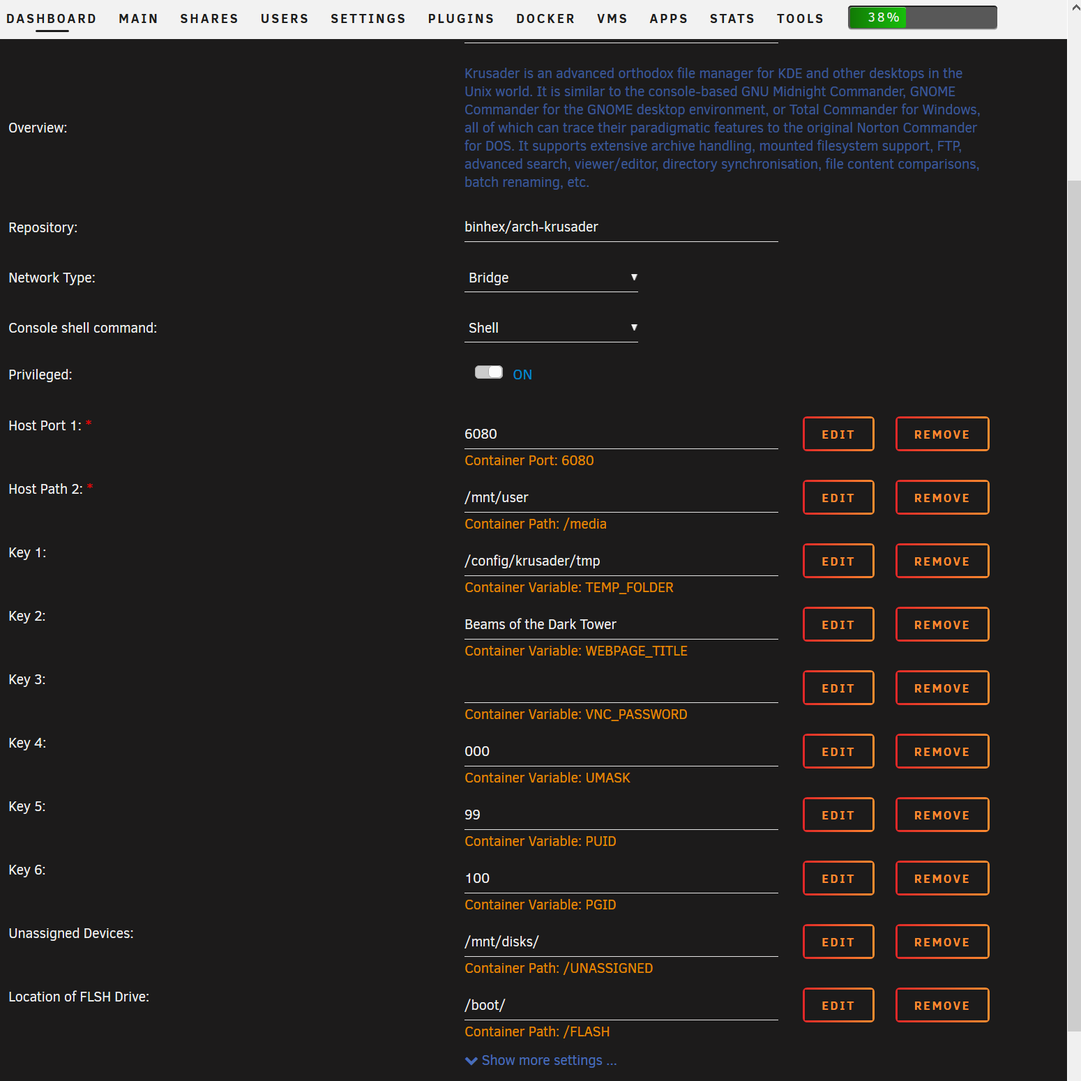

Here is the config:
As always, all assistance/direction is greatly appreciated!
Happy New Year to all!!!

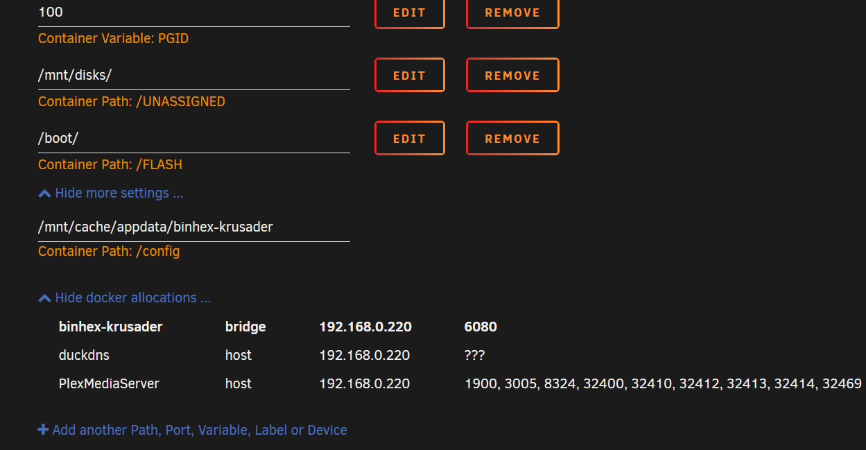

can you click on "show more settings" as i want to see where /config is located, as this is where all krusader configuration is written to.
Edited by binhex
Here you go...
Sorry to bother you on a holiday.
I did try to figure this out via the wiki's and what have you.
1 minute ago, TechMed said:
Here you go...
ok that looks fine, and what are the permissions set for path /mnt/cache/appdata/binhex-krusader/
incase you don't know how to do that, ssh into the host (or use the console screen in the ui) then issue the command:-
ls -al /mnt/cache/appdata/binhex-krusader
and then paste the result here.
