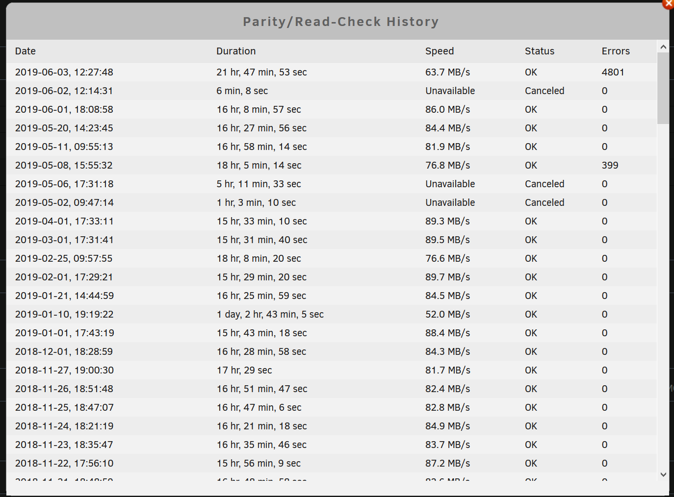

Well just today I ran into some problems with my Parity 2 drive, its disabled now, and it had over 4801 errors after my most current parity check.
So I might have some other serious issues going on, anyone have any direction for me to try and troubleshoot to see what is exactly going on? Here is my latest diagnostic reports. Ty in advance!
~Acps
P.S> I attached my Enhanced Log Viewer results too. If anyone has a few min to look it over for me please. Ty guys!
unraid-diagnostics-20190603-2247.zip unraidenhancedlogviewer-02JUN19.txt
It has 64 pending. After replacement you can try to preclear it to see if those get reallocated and maybe reuse it for something but I wouldn't trust it in my array.
If you look on the Dashboard it should show you that disk has SMART warnings. You shouldn't ignore these, and in fact, you should setup Notifications to alert you immediately by email or other agent when this sort of thing is detected.
Are any of your other disks showing SMART warnings on the Dashboard? I notice you had an earlier parity check that had errors, but you didn't immediately try to resolve that problem and then get another parity check. The only acceptable answer for a parity check is exactly zero sync errors.

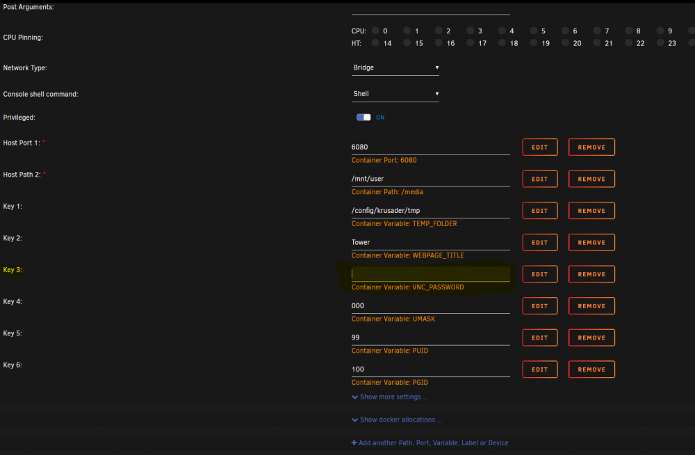

Trying to install binhex-krusader from the Community Apps plugin.
root@localhost:# /usr/local/emhttp/plugins/dynamix.docker.manager/scripts/docker run -d --name='binhex-krusader' --net='bridge' --log-opt max-size='50m' --log-opt max-file='1' --privileged=true -e TZ="America/Los_Angeles" -e HOST_OS="Unraid" -e 'TEMP_FOLDER'='/config/krusader/tmp' -e 'WEBPAGE_TITLE'='Tower' -e 'VNC_PASSWORD'='' -e 'UMASK'='000' -e 'PUID'='99' -e 'PGID'='100' -p '6080:6080/tcp' -v '/mnt/user':'/media':'rw' -v '/mnt/user/Docker/binhex-krusader':'/config':'rw' 'binhex/arch-krusader'
Unable to find image 'binhex/arch-krusader:latest' locally
/usr/bin/docker: Error response from daemon: Get https://registry-1.docker.io/v2/: dial tcp: lookup registry-1.docker.io on 172.18.1.1:53: read udp 172.18.1.123:53167->172.18.1.1:53: i/o timeout.
See '/usr/bin/docker run --help'.
The command failed.
Any thoughts?
SOLVED _ nameserver shenanigans; changed them to cloudflare and google and it works fine.

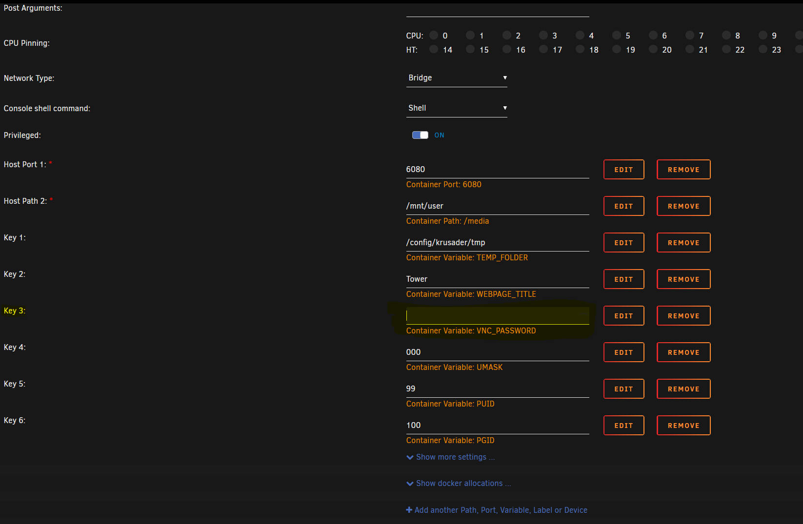

@binhex Is it perhaps a leftover that your template for Krusader comes down with a VNC_PASSWORD default key:
[mention=11148]binhex[/mention] Is it perhaps a leftover that your template for Krusader comes down with a VNC_PASSWORD default key:
image.thumb.png.6f001ad0690d39f313defe3a7dac6327.pngimageproxy.php?img=&key=00b562fcac28e7276d3fb7876ace0f5eef200a4d9770c2ae33e154b3b37fa5cd
Nope, it's a way of setting a password for the web ui
Sent from my EML-L29 using Tapatalk
Ah, that makes sense seeing as it's using noVNC, thanks for the reply.
