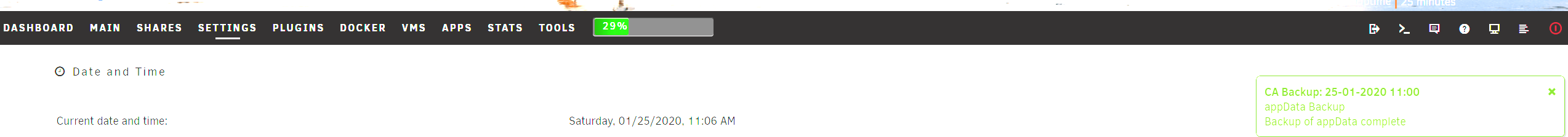

Is there a way to fix this in Krusader.  My date and time format on unraid are correct.  The directions weren't clear on how to change the date format.  It's getting confusing to try to reverse it from European format.1369544886_2020-01-2511_06_53-Tower_DateTime.thumb.png.5c4e5875adaadbd21426a7cdd3b28d5f.png

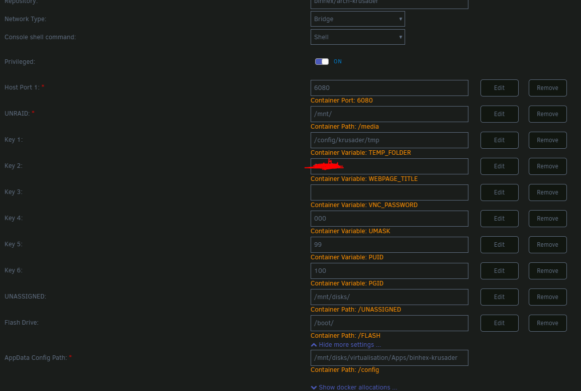

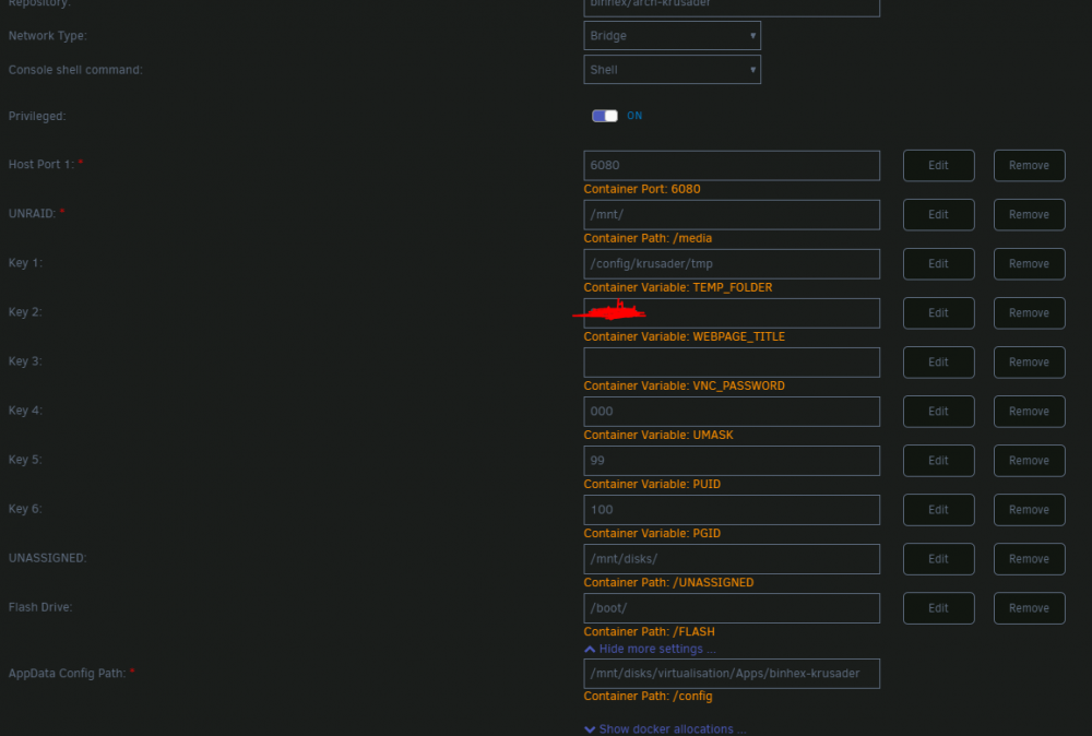

Hi everyone.  Was wondering if someone could do a sanity check on my config.  I've had some weird issues with my docker image filling up, and I believe this only happens when I leave krusader running for a long time.  Probably worth noting, every time I start krusader I get a notification that I can't save bookmarks to the home/nobody location.  I am wondering if this is resulting in tmp files being written elsewhere within the docker image.
