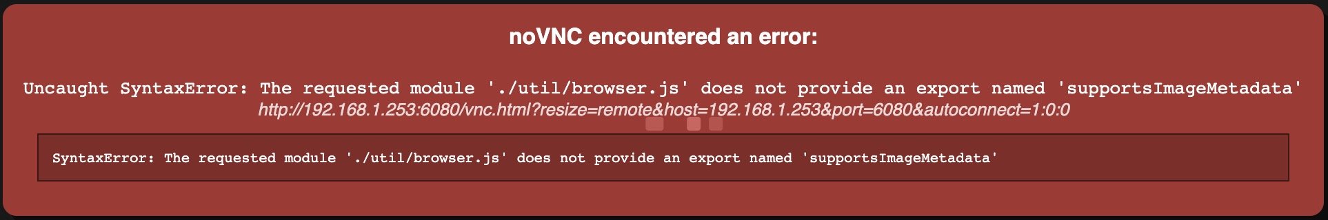

Since the last update, Krusader won't start or don't work. The problem seems to come from chrome. It works well in Safari.
1930196400_Capturedecranle2020-07-10a16_17_47.thumb.jpg.52d2a19eb49582d84e256d42392f696d.jpg
I just tried Chrome (Windows latest update) and it worked.  You might have to have a look at the settings in Chrome and what chrome apps you have installed.  You could also try Firefox...
I get the same with a fresh copy of chrome on macbook.
Samething on Mac
I believe it's a caching issue, clear your cache on your browser.
Sent from my CLT-L09 using Tapatalk
I should have tried that to begin with, yup all good again thanks.
i just F5 on the site and it loaded up just fine after getting the above error.
