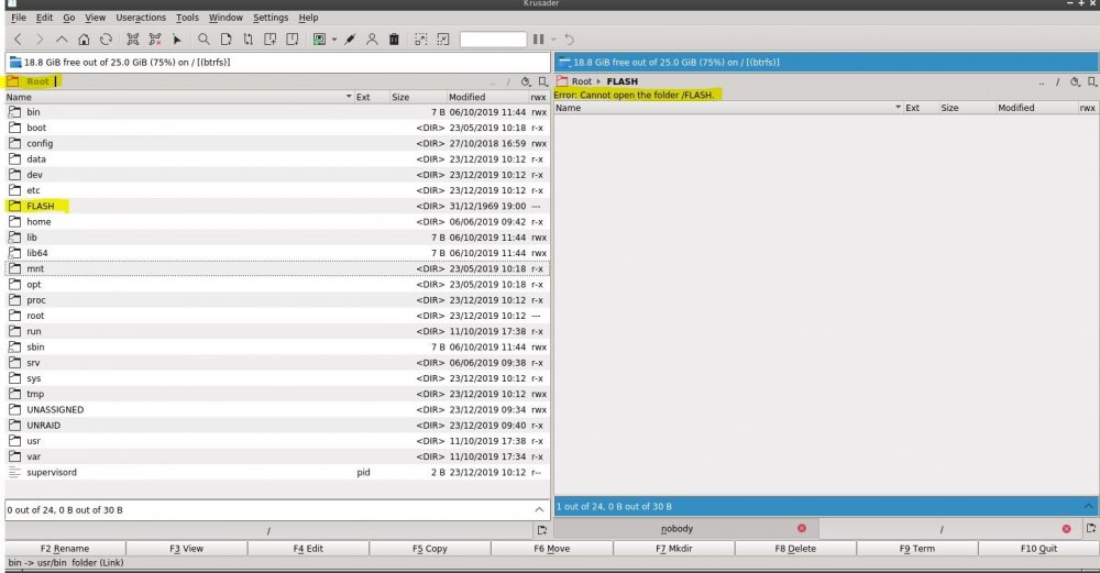

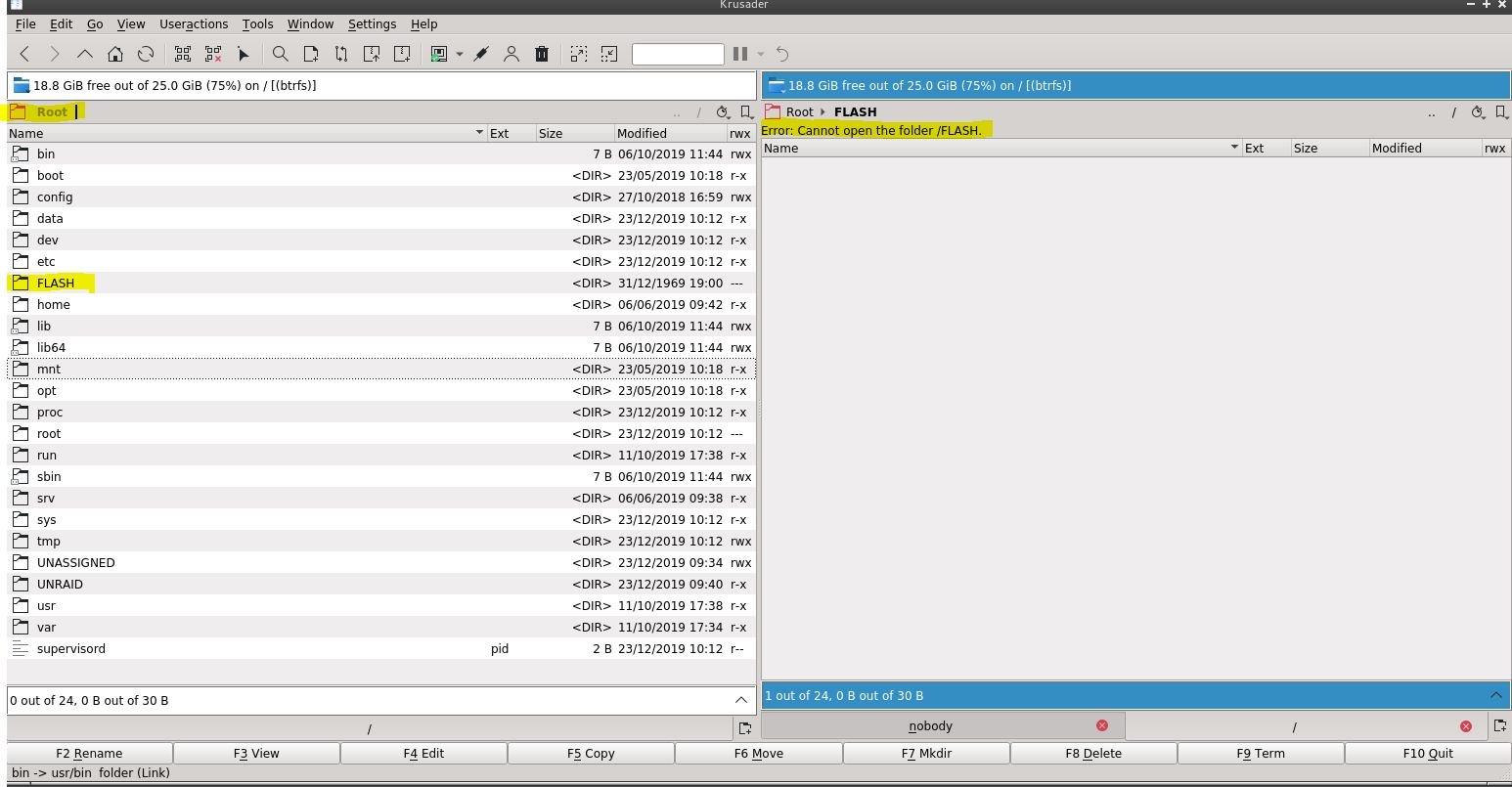

I have been running this docker for quite some time, after following SI's tutorial, with no issue.   However, today, I updgraded my Unraid license to "Pro" and started receiving the too many registry keys error.  So, I went into Krusader to delete the old key and I suddenly cannot access my boot drive (mapped as /FLASH per SI's video).  I am uncertain as to what I've done incorrectly.

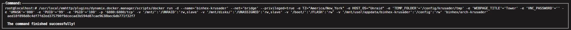

Below is my docker run command and a screenshot inside Krusader when I try to access the /FLASH folder.
Any assistance is much appreciated.
You can't do that anymore with 6.8 unless you edit Krusader and check off the "privileged" box
Ah, so I need to turn "privileged" off?
[EDIT: I just turned privileged off and tried again. No luck.  So, I re enabled privileged again, still no luck.  I'm certain I'm making an error somewhere here...]
Edited by ChappyEight
Add more info.

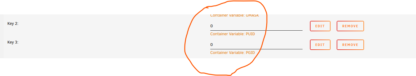

I had to set Krusader to run as 'root'.  You can do this by editing these two variables as shown below:
Remember that being user 'root' gives the power to do just about anything when anyone is using Krusader!
Worked perfect.  Many thanks, @frank1940 .
My bad...  Serves me right for giving advice off the top of my head...
Haha.  Well, even off the top you have more advice to give than me.  :)

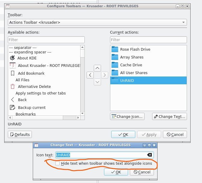

Mine are staying there through a restart.   Try this:    Right-click in the Panel where the icons with test under are. Select 'Configure Toolbars' and you will see this setup.  Select one of the Toolbar items and click 'Change Text'.   Now make sure that the indicated check box is not checked.
I  have also have turned  'Lock Toolbar Positions' to  "on" in the first right-click box.
I checked the entry for each bookmark and made sure the checkbox in the screenshot above is UNchecked. And I have Lock Toolbar Positions turned on.
Still no luck. Every time I restart the docker, I go back to having only a row of folder icons with no text.
