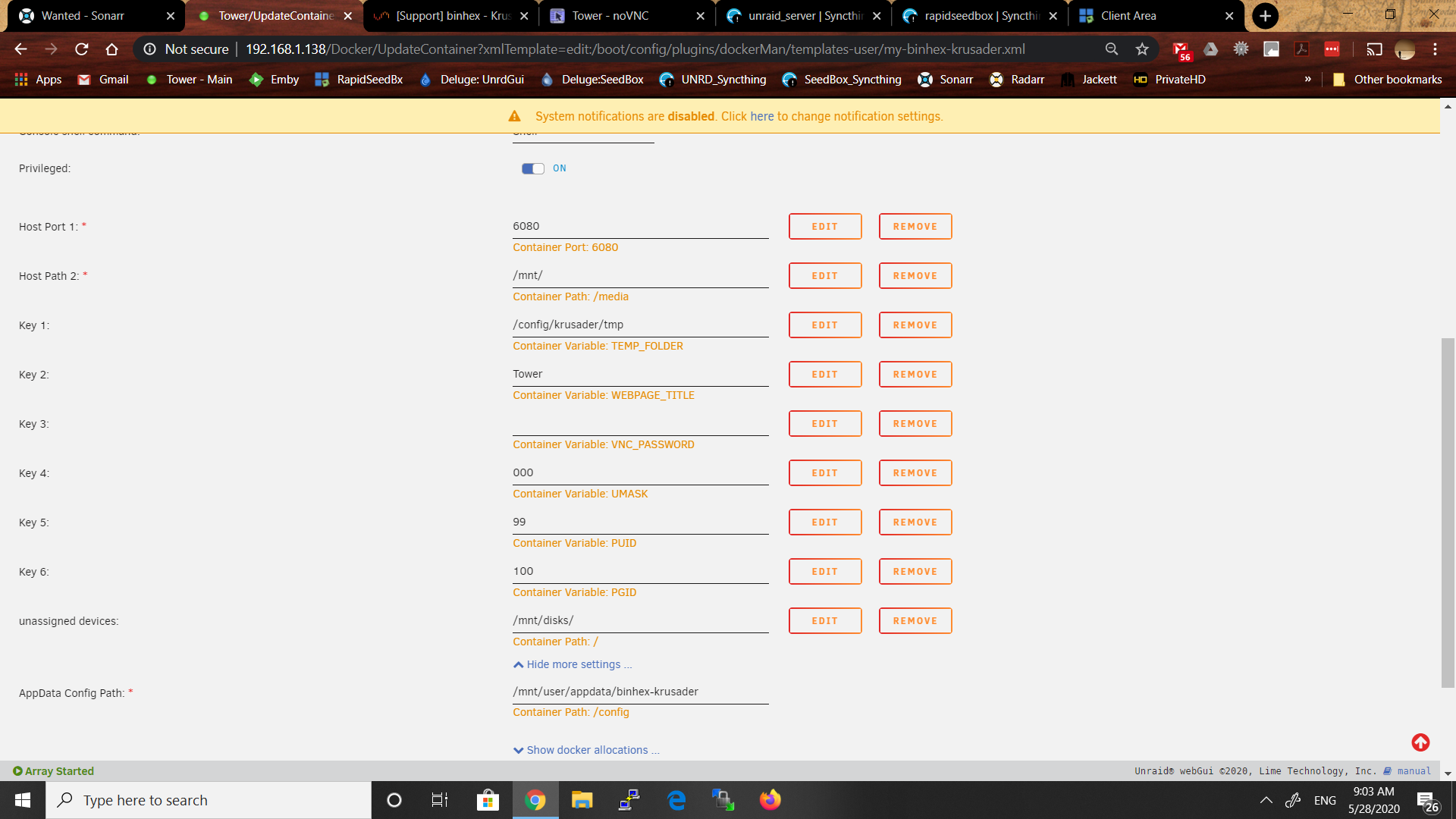

I just installed this and must have done something wrong with the paths as I can't see any of my drives.  I've included my settings and what I see...any assistance would be appreciated
Remove the unassigned devices entry and see what happens.
Looks like that worked. I can browse up to my disks now.  Thanks

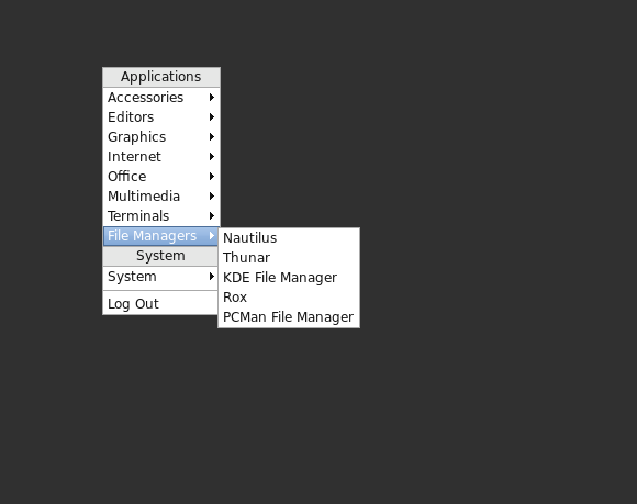

Hmm now I seem to have another problem.  I clicked quit and closed the webpage...then wanted to go back but only get a blank screen.  I disconnected, closed the screen, tried going back in and still just get a blank screen.
Is there a specific way to close the app?
If you close the app from within it's UI, then it's off, and you would have to restart the container via Docker / Dashboard.
If you no longer want to use it, then just stop the container.
not strictly true actually, you can right click the desktop using right mouse button and you will then be able to re-launch krusader again.
IF you close the Krusader window and right click on the desktop, this is what you get:
I have been unable to find a way to restart Krusader from here.  I have to close the Krusader GUI tab, stop the Krusader Docker, restart the Docker and relaunch the WebGUI.
