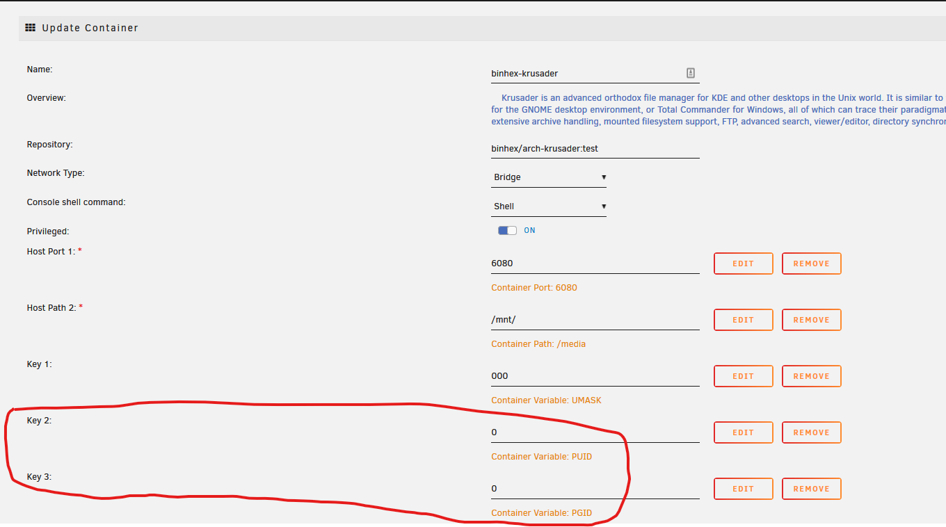

How do I get krusader to run as root user?
I'm getting access denied errors for folders and files that are not nobody:users, and I need to manipulate them.
Thanks!
Thanks!
Change these two variables and the user will now be root.
Thanks.
Am I on a different version or something? mine are
51 minutes ago, sota said:
Thanks.
Yes, those are the ones!
thanks!
