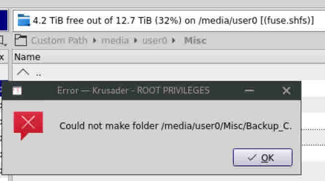

1 hour ago, Asteel said:
Hello, I am unable to use this to delete an sql database that was left behind when I deleted nextcloud and mariadb. I have tried to find a solution and just cant figure it out.
See the Recommended Post at the top of this page.  That will allow you to delete any file on the system since you will than have root privileges.
kk thank you I will look again.

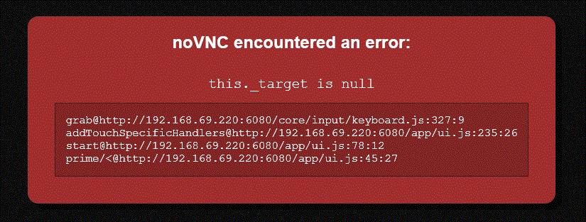

Hi All & @binhex,
Trying to run Krusader, which has been working fine for years, and now I get a noVNC error when launching.
Attached is the error message and the various logs.
Oh, and tried uninstalling an re-installing and it did not help.
Thanks!!!

This is the Installation text:
root@localhost:# /usr/local/emhttp/plugins/dynamix.docker.manager/scripts/docker create --name='binhex-krusader' --net='bridge' --privileged=true -e TZ="America/New_York" -e HOST_OS="Unraid" -e 'TEMP_FOLDER'='/config/krusader/tmp' -e 'WEBPAGE_TITLE'='Tower' -e 'VNC_PASSWORD'='' -e 'UMASK'='000' -e 'PUID'='000' -e 'PGID'='000' -p '6080:6080/tcp' -v '/mnt/user':'/media':'rw' -v '/mnt/remotes/192.168.69.240_black_hole/':'/UNASSIGNED':'rw,slave' -v '/boot/':'/FLASH':'rw' -v '/mnt/cache/appdata/binhex-krusader':'/config':'rw' 'binhex/arch-krusader'
ff310e57f7441946724d3990a7c83d129beae3935009d20454874c97526374be
The command finished successfully!

i think from memory this is a browser related issue, try a different browser, or incognito mode for your browser, if it fixes it then clear down cookies and try it again.
Hi @binhex,
Cleared all of the cookies as suggested, but still kept getting the error.
So I uninstalled and removed everything, even in appdata, and reinstalled.
Works like a champ again!
As always your work and assistance are greatly appreciated!!!! (Beers 🍻 to come at Christmas :) )

Error -- Krusader - ROOT PRIVILEGES
Could not make folder /2_Unraid_Unassigned/Kingston128/test
The permissions on the Kingston USB stick are:
Owner and Group: Can View & Modify Content,
Others: Can Only View Content
User:nobody
Group: users
So it looks like I'm somehow not root even though the top banner of the Krusader window clearly states 'ROOT PRIVILEGES' ?
Totally confused - which isn't unfamiliar :) Anyone help?

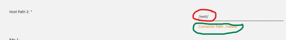

As I understand it:
Go to 'Edit'  of the container.
Look at this:
The portion circled in a Red is the Unraid file directory that Krusader can work within.    The one circled in Green is what that path is called inside the Docker Container.   (Think that the Docker container is a VM that only runs Krusader.    A defined 'Host container path' is the only way that VM can access anything outside of the VM environment.)
PS:  I don't believe this is the default Host container path.  I seem to recall that it is /mnt/user    I modified it so that I could work on the disk shares  BUT I understand the issue of data corruption if one uses Krusader (or any other  file manager) to move files between disk shares and user shares!!!
By the way, you can add in a 'Host Path 3:' to point to another place in the Unraid file structure...
