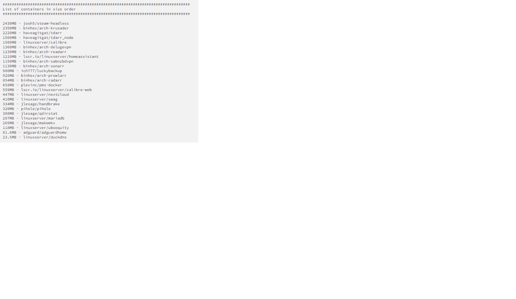

My krusader docker size is over 2 Gb.  This seems large; I've set everything up according to the spaceinvaderone video (e.g. docker mappings).  Is this normal and is there a way to shrink it?

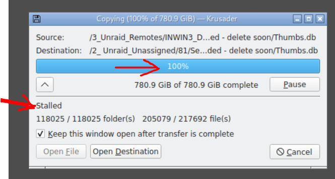

I got this weird result with Krusader - 100% completed, but also "Stalled".
I am having increasing "reallocated sector ct" warnings.  It started lower, but as the copy progressed the reallocated sector ct kept going up to the latest which is now 125.  Do you think that is why the copy of only 780 GB took 4 days, and why it says stalled?
Edited by xrqp
