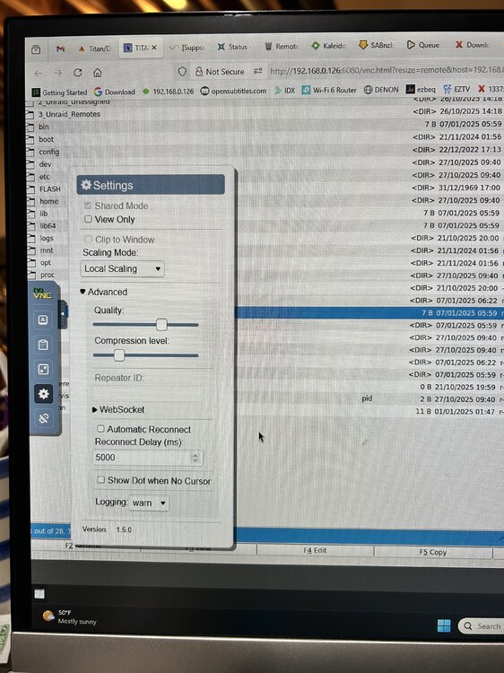

  • Well that was super frustrating but i found a way of moving the window around:- press and hold ALT then use left mouse button and you can then drag the window around and resize it correctly, once

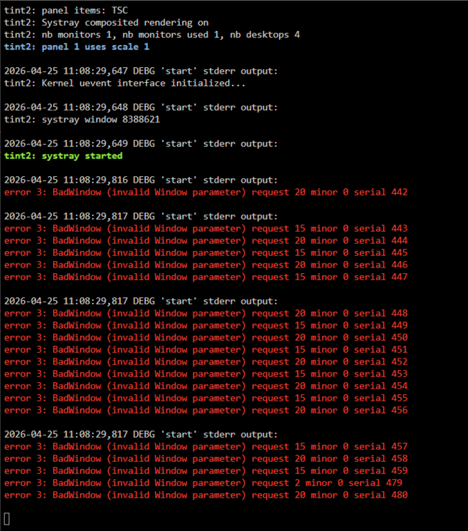

I have the same issue.  Fresh install but multiple windows.

15 hours ago, ph_ said:
I just updated Krusader,
unfortunately the update seems to have introduced some problems, see below logs. The app does not work any more, the WebUI shows another error. Help would be appreciated.
I am running Unraid 6.12.4.

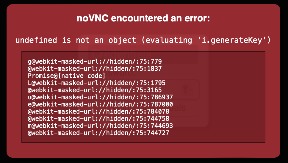

10 hours ago, binhex said:
this looks like the classic caching/cookies issue, try clearing down cookies/cache, try another browser, try incognito mode, one of those should get you going.
FWIW i can confirm the latest image is working for me
Hi @binhex ,
I tried another browser .... it works there instantly. In the initial browser clearing cached images and files and did the trick there. I did not know that a vnc could not appear to work because of some cookie / cash issue. Will keep it in mind.
Many thanks,
ph
Edited by ph_
