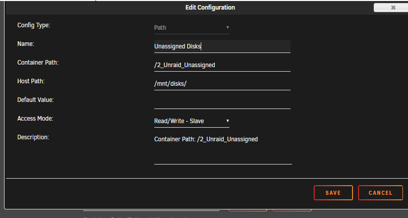

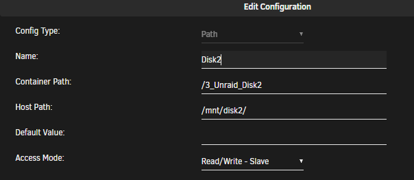

Looking for a little advice here.
I had a 6 TB drive that I replaced with an 18 GB drive.  However, because the 6 TB was formatted as reiserfs, when I swapped them, I got a bug with the 18 GB.  Reading on here, indicated that it was because reiserfs didnt work with 18 GB.  So I changed it to xfs.
I still have the old 6 GB as an unassigned device and I want to copy all of the data over to the 18 GB so parity is good and I can continue with my changes.
My question is how exactly to setup the paths within the docker container to get them to work right.  I watched a video and got the unassigned devices up with this:
But I am unsure how to configure the new disk.  I know the Host Path is /mnt/disk2/, but what about the access mode?
I also assume once its all configured right, it should be pretty simple just to copy all contents from the 6 TB to the 18 TB?
After that, I want to do a parity check and then move over a different 6 TB that is still part of the array onto the 18 TB.  How should that be configured?
leave it on the default mode for an array disk, so 'Read/Write' it's only UD drives that you have to mess with the mode.
