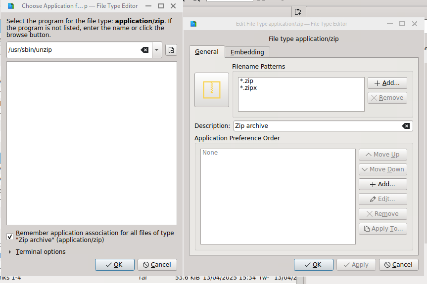

Hi when i try and change the file association, its doesn't keep and the dialog box continues to pop up. How do i fix this please?

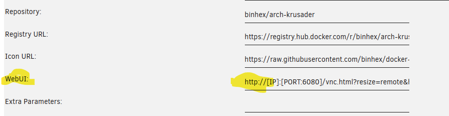

It works using http. When opening the WebUI is there any way to default to opening using http instead of https?
Open your template in Advanced View. What is your WebUI set as? Mine is http:
I completely forgot about advanced view. Thanks it works properly now ;D

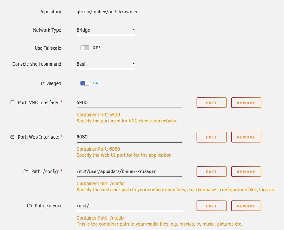

On 7/8/2025 at 11:10 AM, Glonch said:
I'm having the same problem - and Docker is set to Native too.
Not only it will take forever for the GUI to come up, there are many times remote atttached directories will not populate either. I'll have to use MC via command line to move things around.

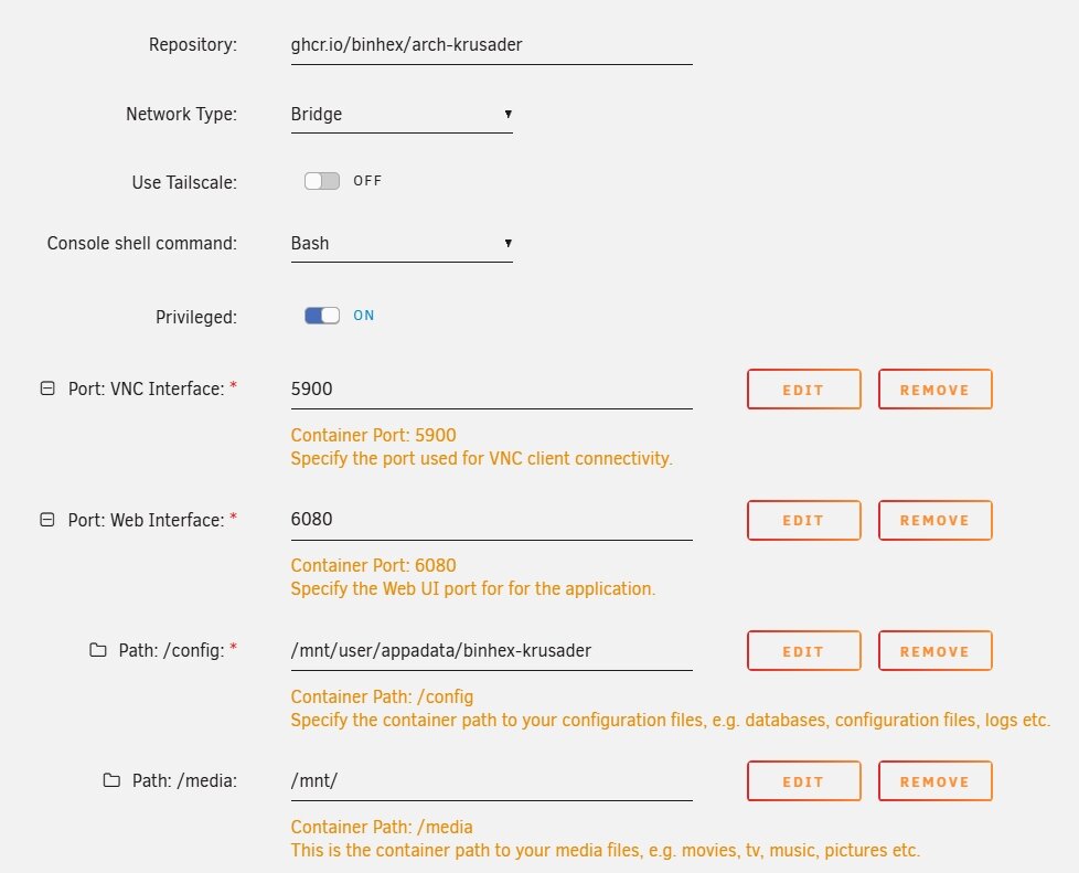

Seems like I'm having the same issue. I accidentally stumbled over the issue because I only wanted to reboot krusader and noticed that its not coming up again since 1,5h.
ok so this is interesting, so it might be that the time to start is due to remote mount points or shares being retried until a timeout is hit. if you remove all remote attached directories does the startup time improve?.
FWIW - The link to the remote share was somewhat new and the delay to get into Krusader was already happening.
As a test, I removed the share, stopped Krusader, started Krusader - took ~8 mins for noVNC to display Krusader (stopwatch timing while refreshing).
OK two more test for you:
  • Set networking to default - if the networking is not set to 'bridge' then please set it back to this then test and report back
  • Try with new config - can you edit your existing container and change the host path for /config to something else, then click apply, test and report back
FYI - As you may be able to guess i cannot replicate this issue, krusader starts within 2-3 seconds for me, as i assume it does for most people.
