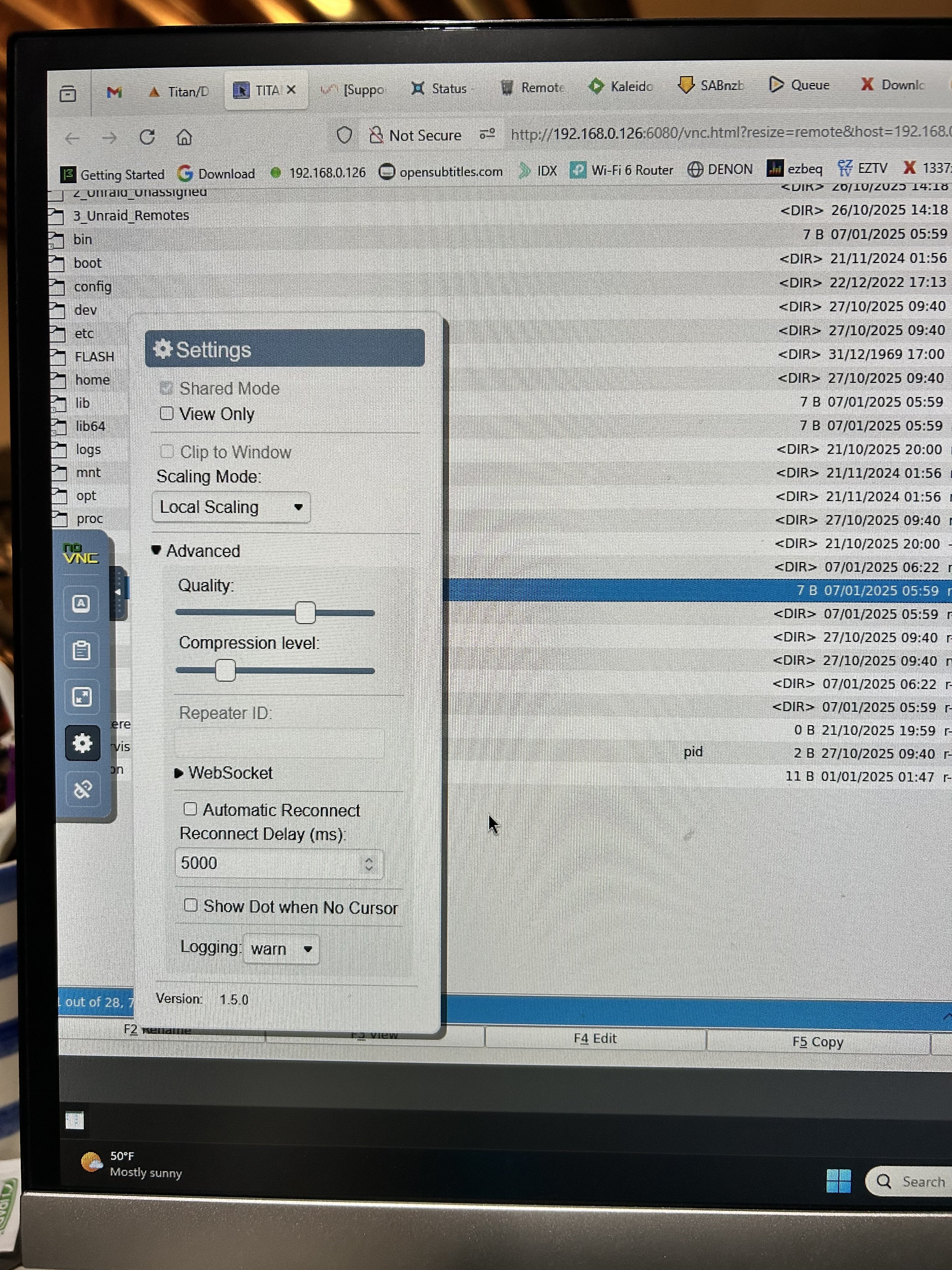

Hi i installed this but when launching webui i get
2025-08-30 17:37:29,471 DEBG 'start' stderr output:
x.x.x.x: SSL connection but '/self.pem' not found
nevermind, find i need to reach it using http instead https
I just deleted the container by mistake, I reinstalled and it will not launch. The container starts but the GUI will not load. I made sure the ports were not conflicting with other containers but still nothing.
UPDATE: just needed to remove the "s" from the URL for the "WebUI:" so it was not trying to use SSL. (http://[IP]:[PORT:6080]/vnc.html?resize=remote&host=[IP]&port=[PORT:6080]&autoconnect=1)
Edited by XDUDE3D
Hi
i am wondering how i can get the HTTPS krusder link to work?
currently when i open the webUI, it directs me to the HTTPS. This cant be reached.
To use krusader i have to remove the S and make it HTTP, then krusader works fine
I am not sure what i have to do to make the HTTPS to work.
Thanks in advance!

i will fix up the template to use http out of the box, as for your query if you do want to use https then you will need to generate a valid key and cert, put them on a path the container can see and configure Variable: HTTPS_CERT_PATH: and Variable: HTTPS_KEY_PATH: respectively.
Thanks for the advice and update. Currently my install of krusader still uses HTTPS. How do i choose between HTTP and HTTPS?
Thanks,
Neil
Assuming what you are trying to achieve is to change the URL whn you left click and select 'Web UI' from HTTPS to HTTP:
Left click container, select edit, toggle 'basic view' to 'advanced view' change the 'WebUI:' protocol from https to http, scroll down to the bottom and click apply.
Thank you that does the trick! learning new things everyday!
