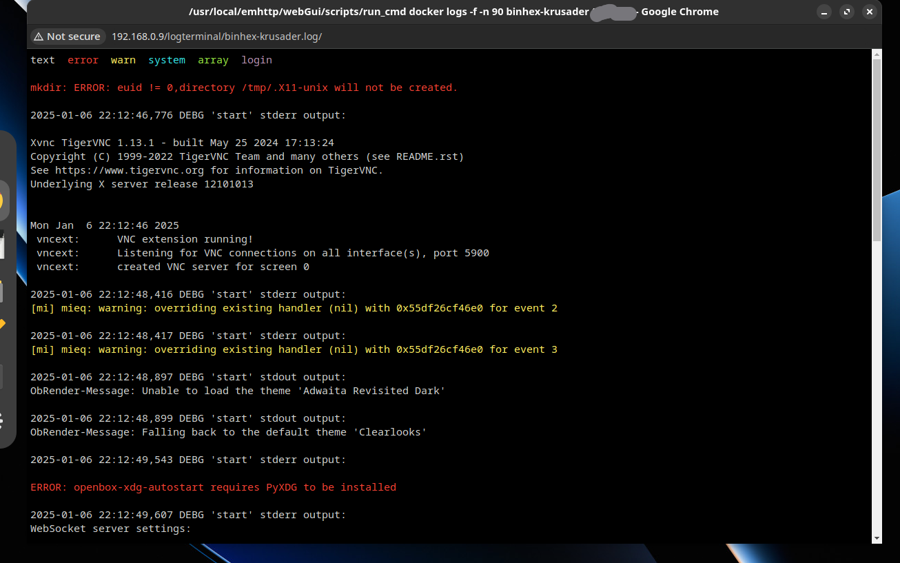

12 minutes ago, Paul_G said:
Howdy, just updated to the latest version. worked just fine beforehand but now getting this ->
Other docker containers are working as usual. Have disabled and enabled docker service. same. have turned the server off and on again. same.
am getting some errors on the logs ->
tried removing the container and the image and reinstalling from the previous apps template.
seemed to make no difference, but slightly different info in logs:>
2025-01-06 22:38:05,313 INFO Included extra file "/etc/supervisor/conf.d/novnc.conf" during parsing
2025-01-06 22:38:05,314 INFO Set uid to user 0 succeeded
2025-01-06 22:38:05,342 INFO supervisord started with pid 7
2025-01-06 22:38:06,352 INFO spawned: 'start' with pid 94
2025-01-06 22:38:06,354 INFO reaped unknown pid 8 (exit status 0)
2025-01-06 22:38:06,706 DEBG 'start' stderr output:
_XSERVTransmkdir: ERROR: euid != 0,directory /tmp/.X11-unix will not be created.
2025-01-06 22:38:06,708 INFO success: start entered RUNNING state, process has stayed up for > than 0 seconds (startsecs)
2025-01-06 22:38:06,710 DEBG 'start' stderr output:
Xvnc TigerVNC 1.13.1 - built May 25 2024 17:13:24
Copyright (C) 1999-2022 TigerVNC Team and many others (see README.rst)
See https://www.tigervnc.org for information on TigerVNC.
Underlying X server release 12101013
Mon Jan  6 22:38:06 2025
 vncext:      VNC extension running!
 vncext:      Listening for VNC connections on all interface(s), port 5900
 vncext:      created VNC server for screen 0
2025-01-06 22:38:07,667 DEBG 'start' stderr output:
[mi] mieq: warning: overriding existing handler (nil) with 0x55d6487ab6e0 for event 2
[mi] mieq: warning: overriding existing handler (nil) with 0x55d6487ab6e0 for event 3
2025-01-06 22:38:07,966 DEBG 'start' stderr output:
WebSocket server settings:
2025-01-06 22:38:07,968 DEBG 'start' stderr output:
  - Listen on :6080
  - Web server. Web root: /usr/share/webapps/novnc
  - No SSL/TLS support (no cert file)
  - proxying from :6080 to localhost:5900
2025-01-06 22:38:07,975 DEBG 'start' stdout output:
ObRender-Message: Unable to load the theme 'Adwaita Revisited Dark'
2025-01-06 22:38:07,976 DEBG 'start' stdout output:
ObRender-Message: Falling back to the default theme 'Clearlooks'
2025-01-06 22:38:08,456 DEBG 'start' stderr output:
ERROR: openbox-xdg-autostart requires PyXDG to be installed
2025-01-06 22:38:10,551 DEBG 'start' stdout output:
[info] tint2 not running
2025-01-06 22:38:10,597 DEBG 'start' stderr output:
tint2: Using glib slice allocator (default). Run tint2 with environment variable G_SLICE=always-malloc in case of strange behavior or crashes
2025-01-06 22:38:10,611 DEBG 'start' stderr output:
tint2: xRandr: Found crtc's: 1
2025-01-06 22:38:10,612 DEBG 'start' stderr output:
[1;34mtint2: xRandr: Linking output VNC-0 with crtc 0, resolution 1024x768, DPI 96
2025-01-06 22:38:10,614 DEBG 'start' stderr output:
tint2: No XSETTINGS manager, tint2 uses config option 'launcher_icon_theme'.
tint2: Loading config file: /home/nobody/.config/tint2/theme/tint2rc
2025-01-06 22:38:10,619 DEBG 'start' stderr output:
tint2: real transparency on... depth: 32
2025-01-06 22:38:10,626 DEBG 'start' stderr output:
t
2025-01-06 22:38:10,627 DEBG 'start' stderr output:
int2: panel items: TSC
tint2: Systray composited rendering on
tint2: nb monitors 1, nb monitors used 1, nb desktops 1
tint2: panel 1 uses scale 1
2025-01-06 22:38:10,730 DEBG 'start' stderr output:
tint2: Kernel uevent interface initialized...
2025-01-06 22:38:10,746 DEBG 'start' stderr output:
tint2: systray window 8388621
2025-01-06 22:38:10,747 DEBG 'start' stderr output:
tint2: systray started
2025-01-06 22:38:13,278 DEBG 'start' stderr output:
error 3: BadWindow (invalid Window parameter) request 142 minor 6 serial 501
2025-01-06 22:38:13,279 DEBG 'start' stderr output:
error 9: BadDrawable (invalid Pixmap or Window parameter) request 139 minor 4 serial 502
error 4: BadPixmap (invalid Pixmap parameter) request 54 minor 0 serial 524
any help would super cool. thanks for looking.

59 minutes ago, binhex said:
Clear browser cache and cookies
bingo. sorted. Thanks for the help just now and also for everything else you do with the apps and repos. appreciated!

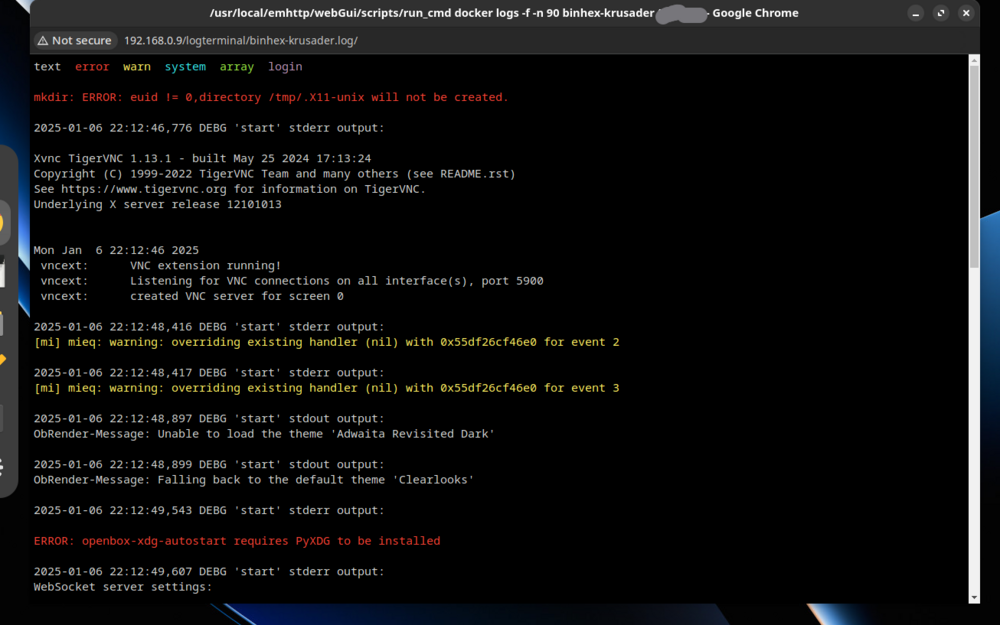

  - Listen on :6080
t

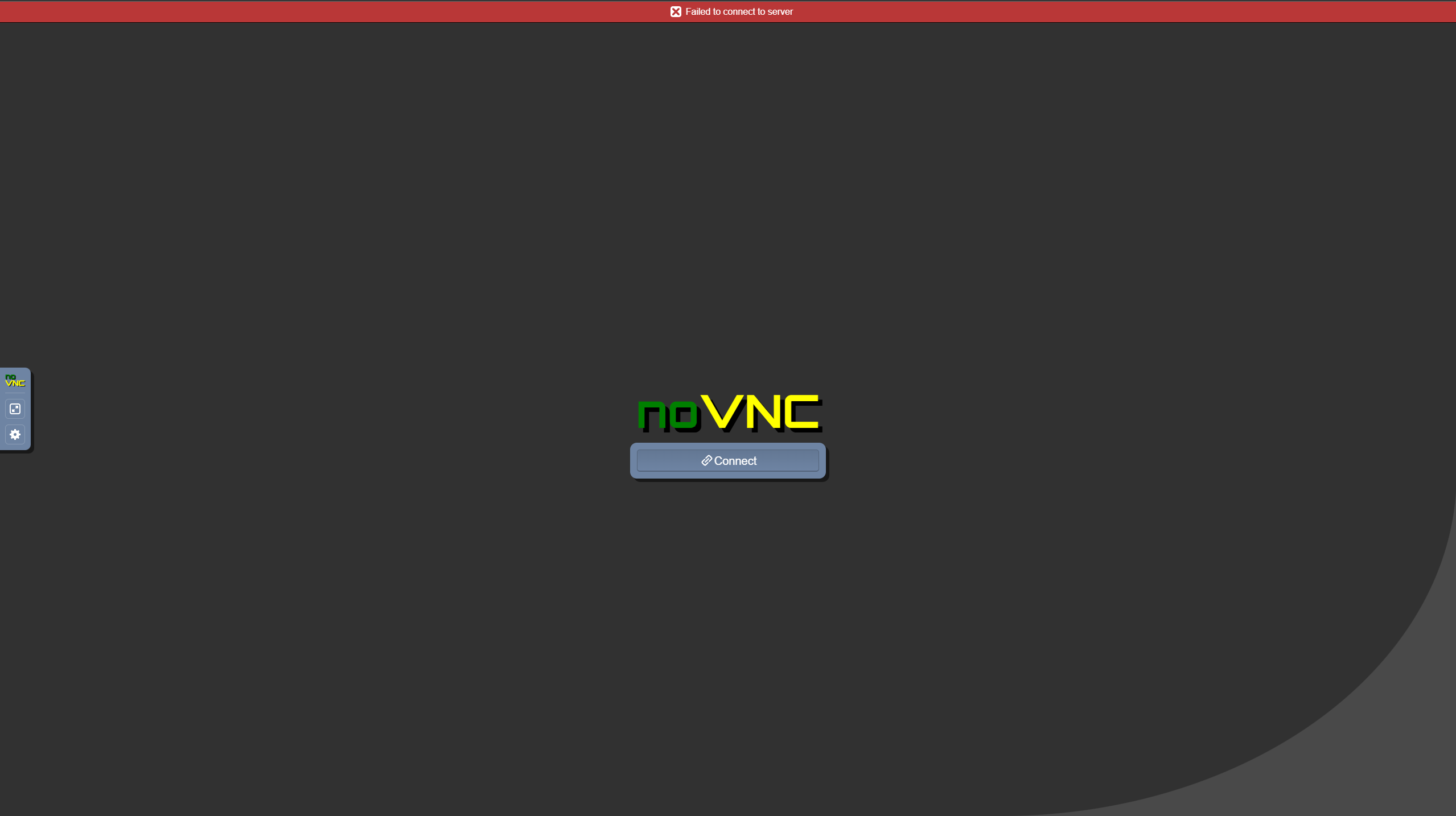

hi just clear your browser data like cookies and cache and you will be all set.
1 hour ago, binhex said:
Fixed, again :-), issue 'force update' or 'check for updates' and apply.
Thank you will do that now.

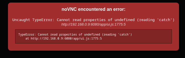

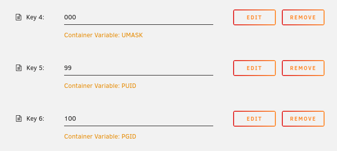

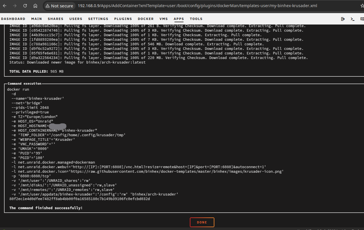

Hello @binhex I am grateful for all the hard work you put in to this. and your replies are fast. thank you.
I was also getting a server error when trying to start the container after update. Upon inspection, I noticed the template added the port 5900 mapping, and since a running VM on my server was already using port 5900 for VNC access the container wouldn't start as a result. I removed the port 5900 mapping and everything was fixed. I've always only had port 6080 mapped and have always accessed the web GUI over this port instead. My question is should I be using port 5900? Is there a reason for both port mappings?
the reason for both is so that you can, if you wish, connect to the ui using a VNC client, you don't have to use noVNC, if you always want to use noVNC then you can safely remove the port mapping as you have done so, or simply change the host port number so it doesn't clash (a more common approach).
