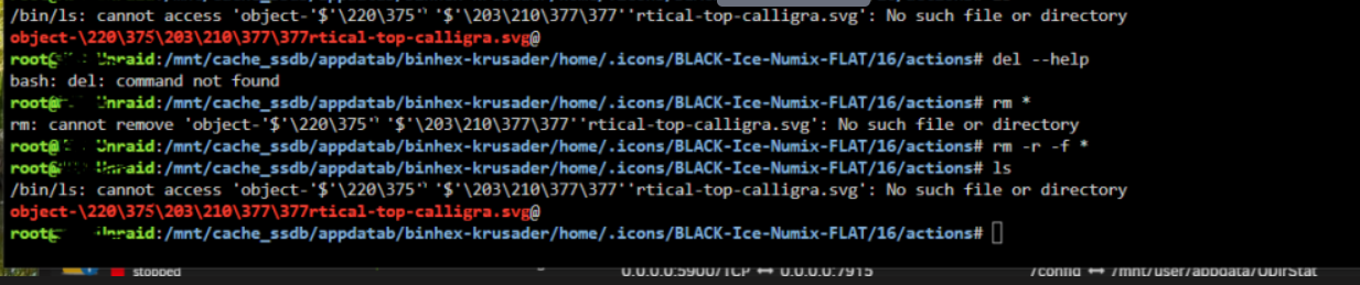

Unable to delete a Krusader folder I used as backup when doing a cache drive recovery. Any help is much appreciated.
I posted my question in the Unraid forum but no one has replied to date:
"Long story short, I had to recreate my cache drive. As backup i copied appdata folder and system. Now the appdata backup folder cannot be delete becuase of a single file. I have no clue how to remove it. Any advice is much appreciated."

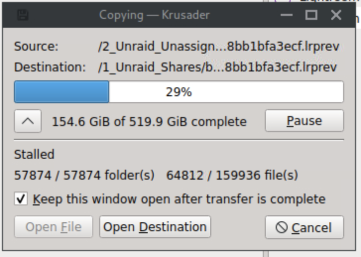

I am doing some transfer of 500 GB data to Unraid using Krusader from unassigned disks to some Unraid shares.
The transfer seems to work well and the speed is good, but I see that Krusader suddenly shows the message "Stalled".
The transfer is not stalled at all - it carries on well.
See attached screenshot.
1. What does this "Stalled" mean? Why does it display it when it definitely is not stalled?
2. I am not connected through VNC all the time when I do the transfer. I close the browser with VNC and connects at some later point to check progress on the transfer. I guess this is fine? I do not need to be connected with VNC all the time?
3. Can I "trust the transfer"? Will Krusader tell me if some files could not be copied?
stalled means transfer speed was/is near or at zero, i see you are transferring thousands of files, so stalling can happen under this circumstance, but it shouldnt be anything to worry about.
yes its fine and no you do not need to stay connected to vnc
in my experience the answer is yes you can trust krusader, but feel free to do a compare once the copy is complete to verify everything is copied across.
Thanks - I did an rsync to verify afterwards and the copy had been done OK!

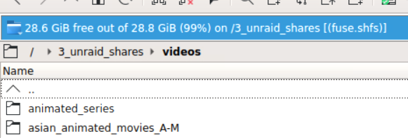

This Krusader app is so confusing. See the screenshot. Why is Krusader showing 28.6GB when I'm 100% certain that this path has like 10 TERABYTES available? The share below is a dataset on a ZFS POOL. This wrong capacity is preventing me from copying a batch of files in excess of 28.6GB.

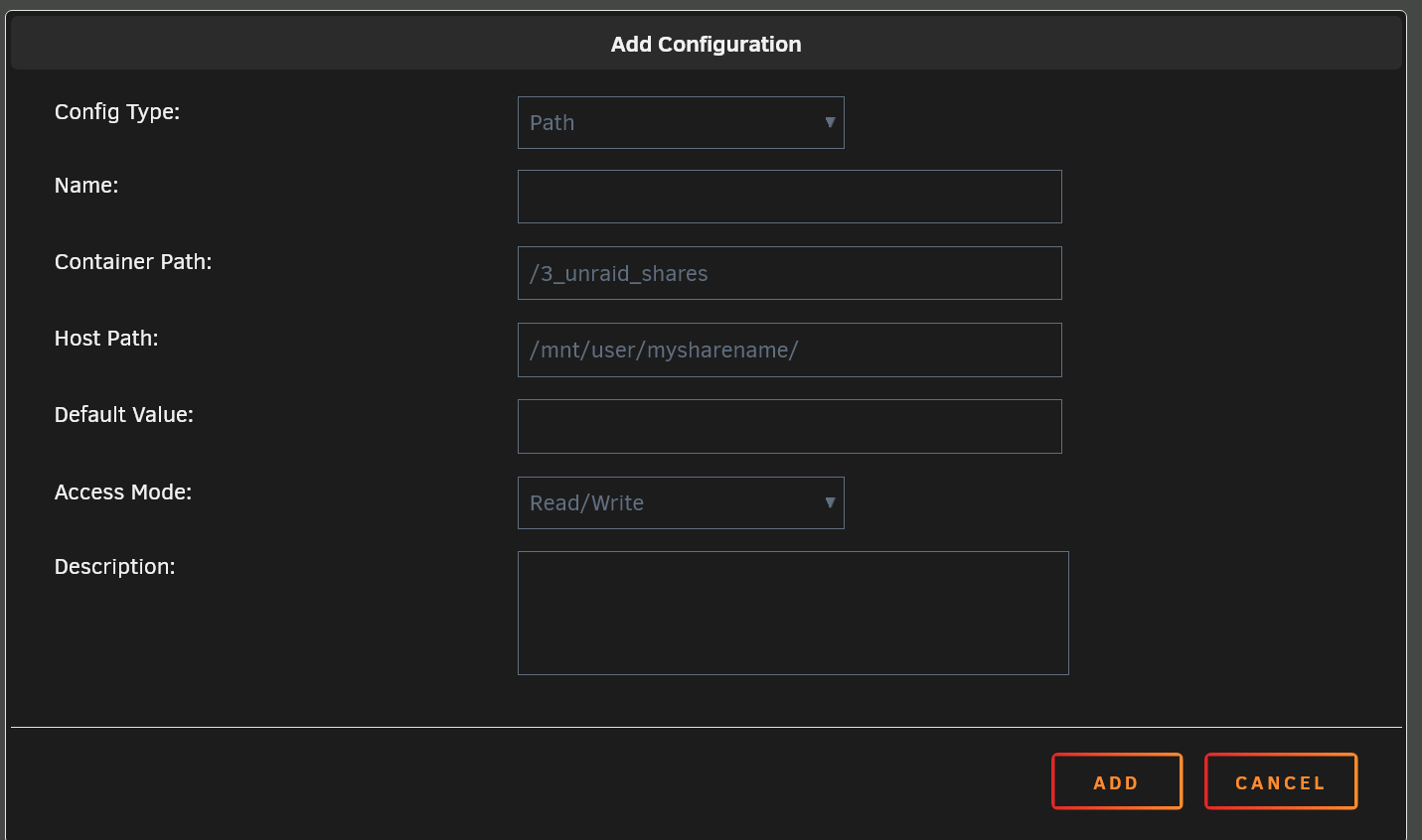

Krusader is correctly showing you the disk space available within the docker image, i would guess you have a 30GB docker image created right?, i would also suspect you are not doing a docker bind mount from your host path to '/3_unraid_shares' and thus its writing inside the docker image and not to your host.
To correct this create a new 'path' e.g.:-
