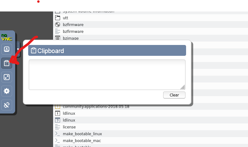

Hi all, is there something I need to enable to allow me to paste text into the krusader windows (such as when editing a text file). Right now I ca copy and paste from within krusader but not paste text cut from any other window on the same computer/browser.
You need to use the shared clipboard of VNC. I have removed Krusader, but it is on top right or mid-left edge of the screen.
That said, after much love for Krusader (and I have no complains), I moved to doublecommander and double commander.
The second one is web based, so copy-paste works directly. The first one is like Krusader, but I found that it has more options (see comparisons online) and the implementation as a container is better (uses another VNC that works much nicer) - plus I think takes less space!
Here is a screen shot:
As I recall, you have to use a right click to be able transfer content to-and-from the clipboard...

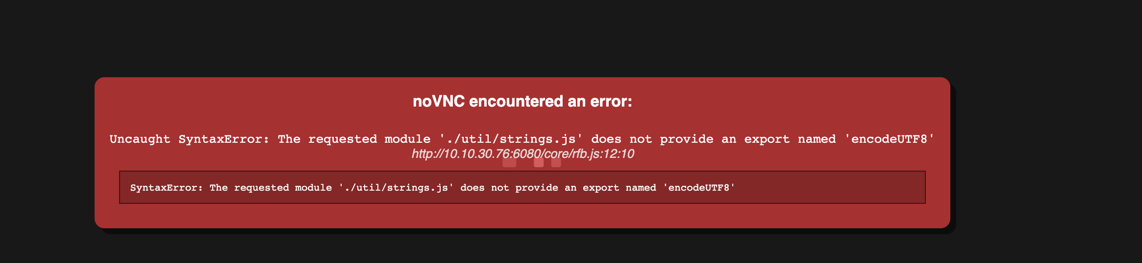

Determined the issue was related to the container updating.
Since the last update, I got this error1634572752_Capturedecranle2022-11-21a19_57_59.thumb.png.bcd1d4fe2427a2e68e1f818dcf2caa11.png
any idea of the problem ?
Thank,

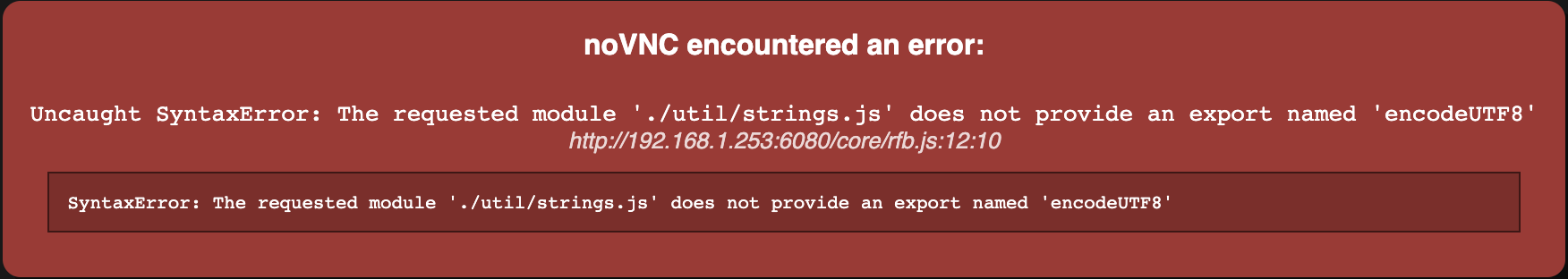

Getting the same error. Started after the most recent docker update.
same thing for me, updated and not working 😕
version 2.7.2-4-01 works
Edited by Nexius2
Thank,
i think this might be a cookies related problem, try an incognito windows, if that works then it confirms cookies is the issue - clear the cookies for the site.
install the latest version of Unraid, 6.11.5
This has not resolved the issue for me still getting .
however clearing the browser Cache did correct the issue. But as I did not do that first I cannot say if the upgrade of unraid os was avoidable
