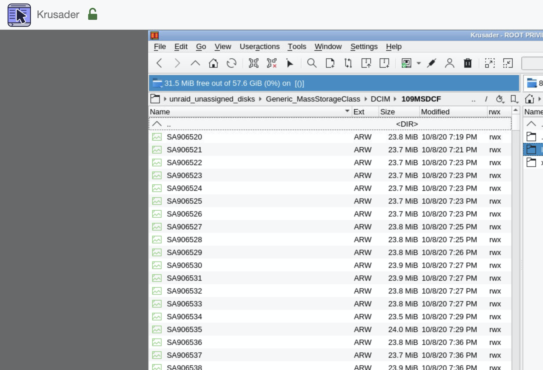

sorry if this is a dumb question but I'm not seeing anything in search ....I use unraid for photography and I want to connect a 4 SD card reader to my system ....I have tested this and I see the cards show up in Unassigned disk and binhex....I am able to copy files over to my photo share just fine..now when its time to change a card ...binhex still shows the files of the last card...I tired to refresh button and restart the docker. I even remove the card reader and I still see the info in binhex...I'm I using the wrong app for what I'm trying to do?

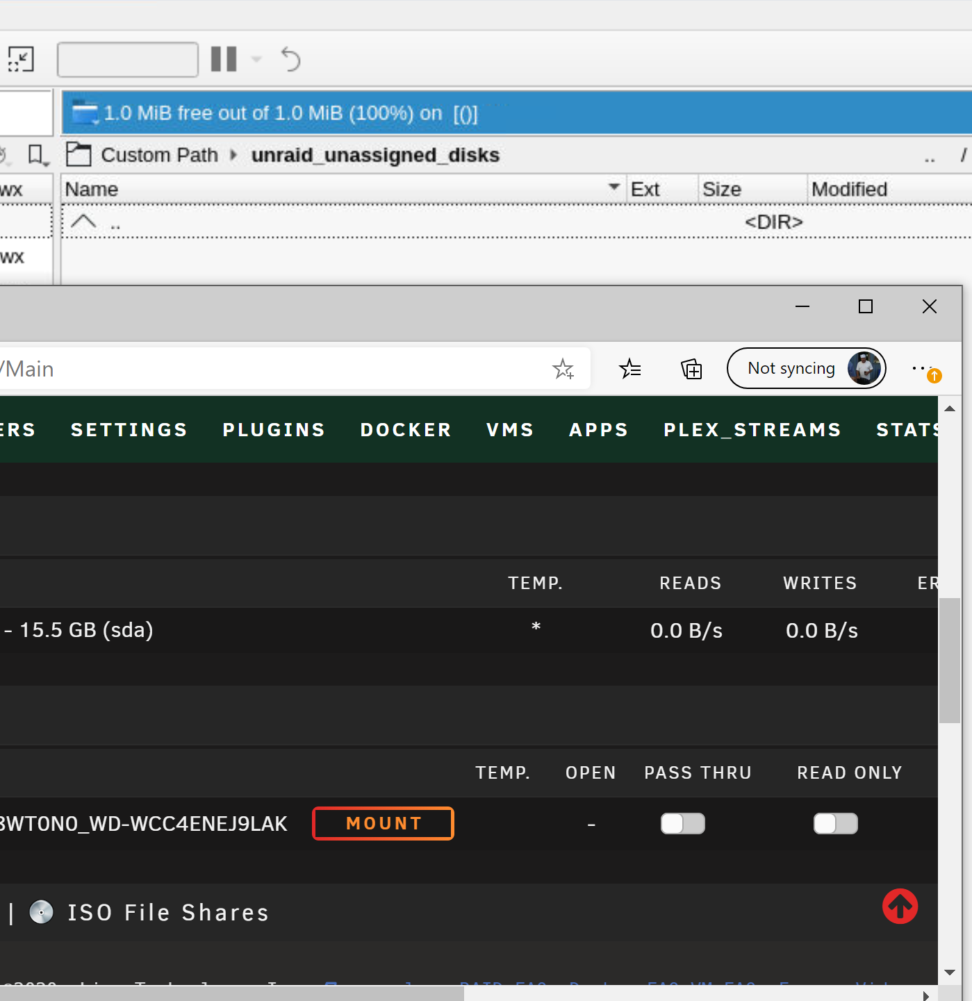

@drichard  i have had similar with 6TB and bigger drives
my resolved issue for now was
1.  for this   Restart the docker each time
2..  use the other Krusader  i found this one had issues.. but the "Krusader"  docker  one  and set the PUID the other P   to 0  the the key 5 6
and that has seemed to to fix the issues your having
give it a try see what happens if it works..
but i fell in same issue  and that worked for me  it was frustrating

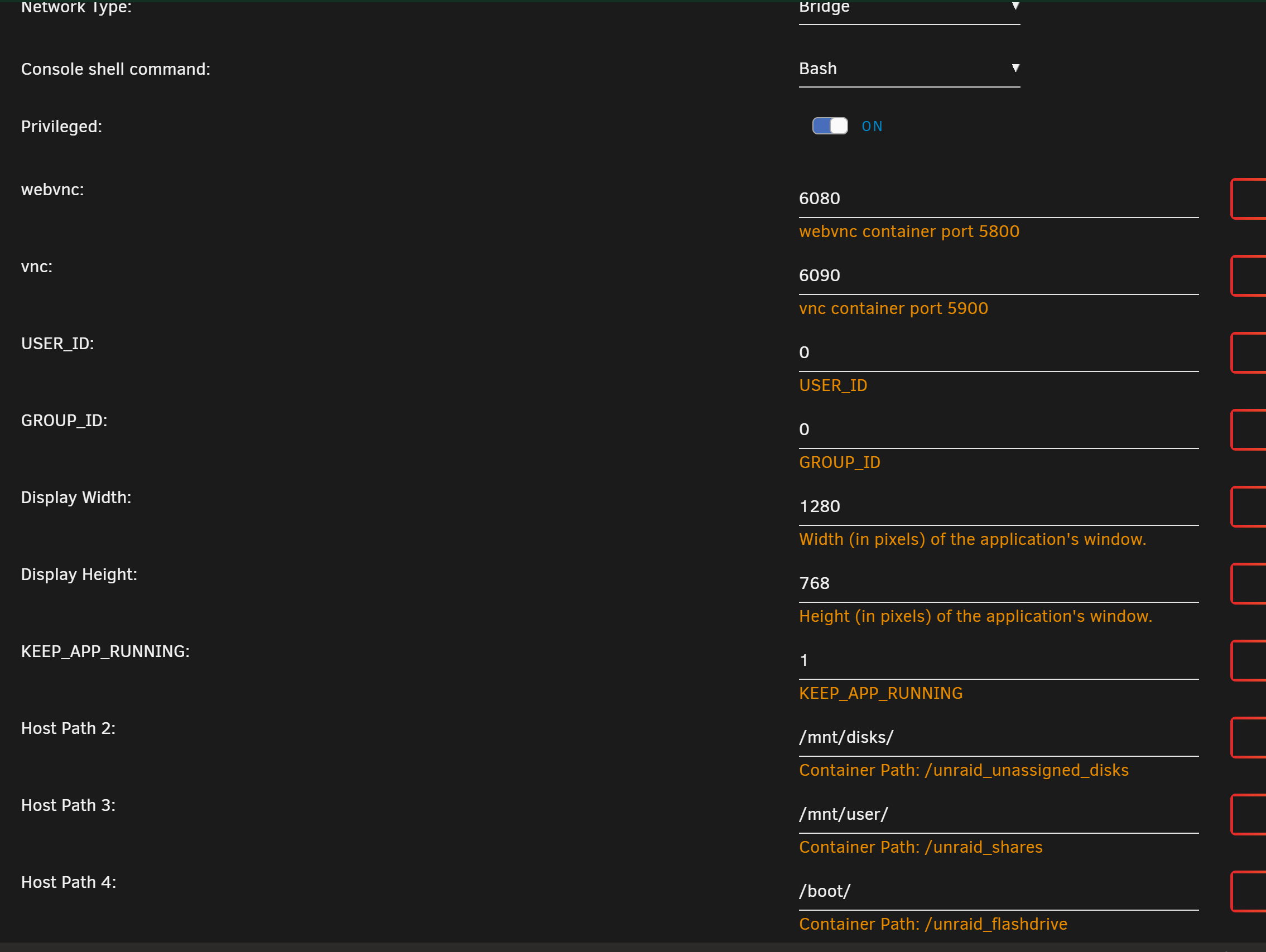

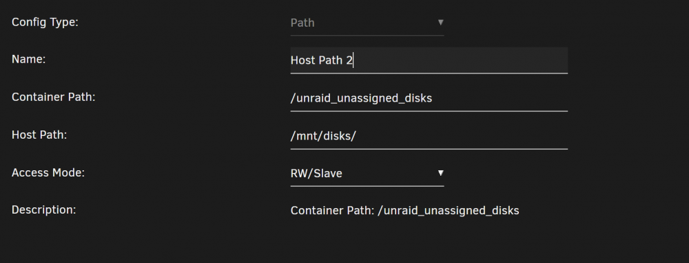

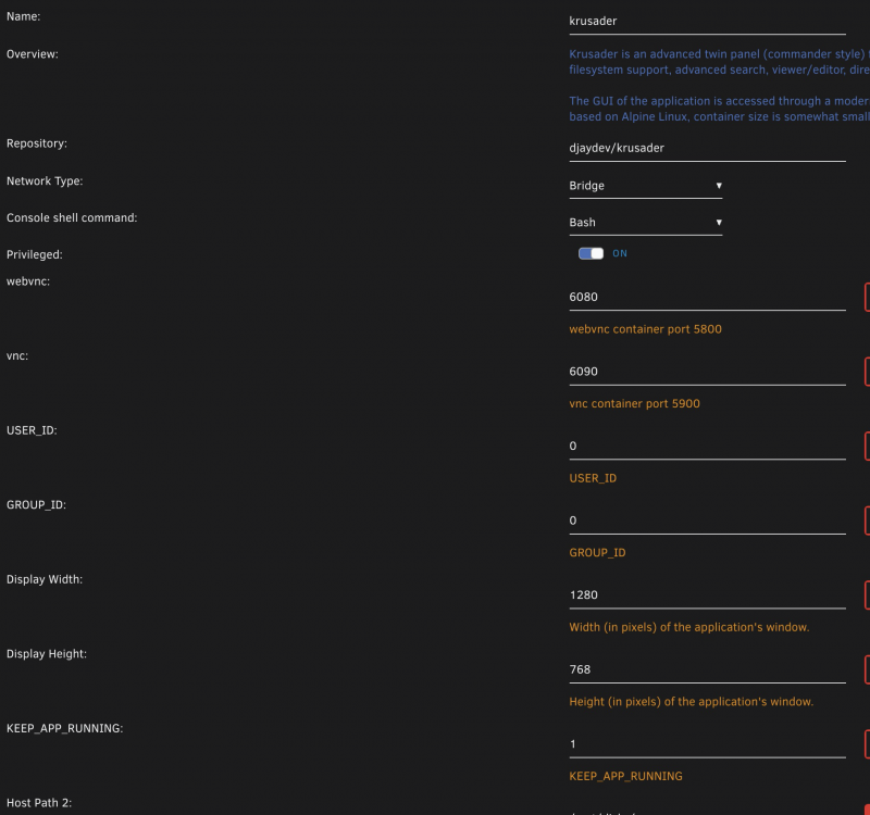

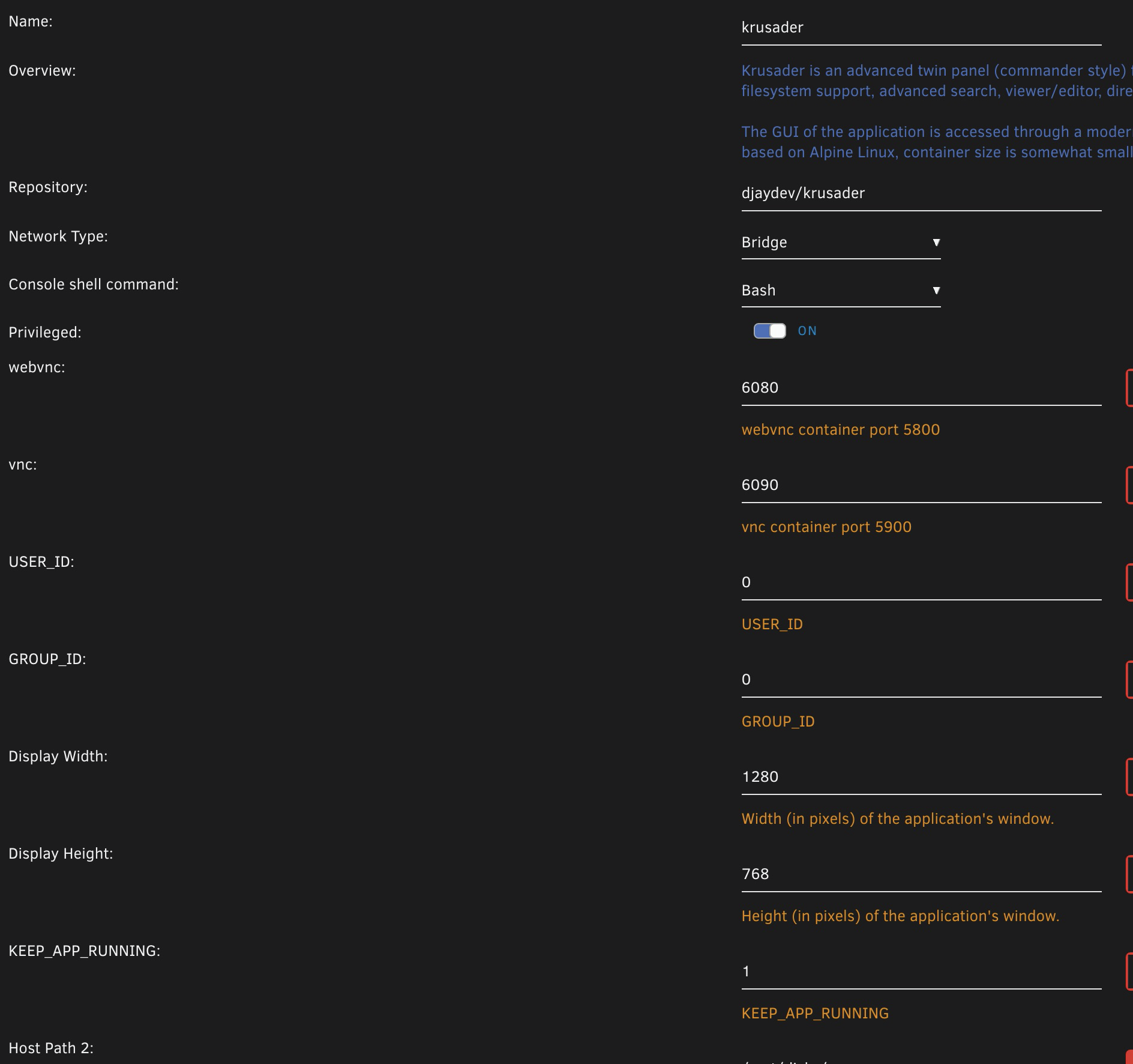

so I installed the other krusader but I'm not seeing puid ....can I trouble you for a screen shot please
my bad its because i remember from the this krusader or other dockers
its USER ID and Group ID  i set them to 0
try that...
sorry about that i wasnt looking at my screen  i just did from remembering..  i not best at this unraid i only been using a couple years now so no expert here

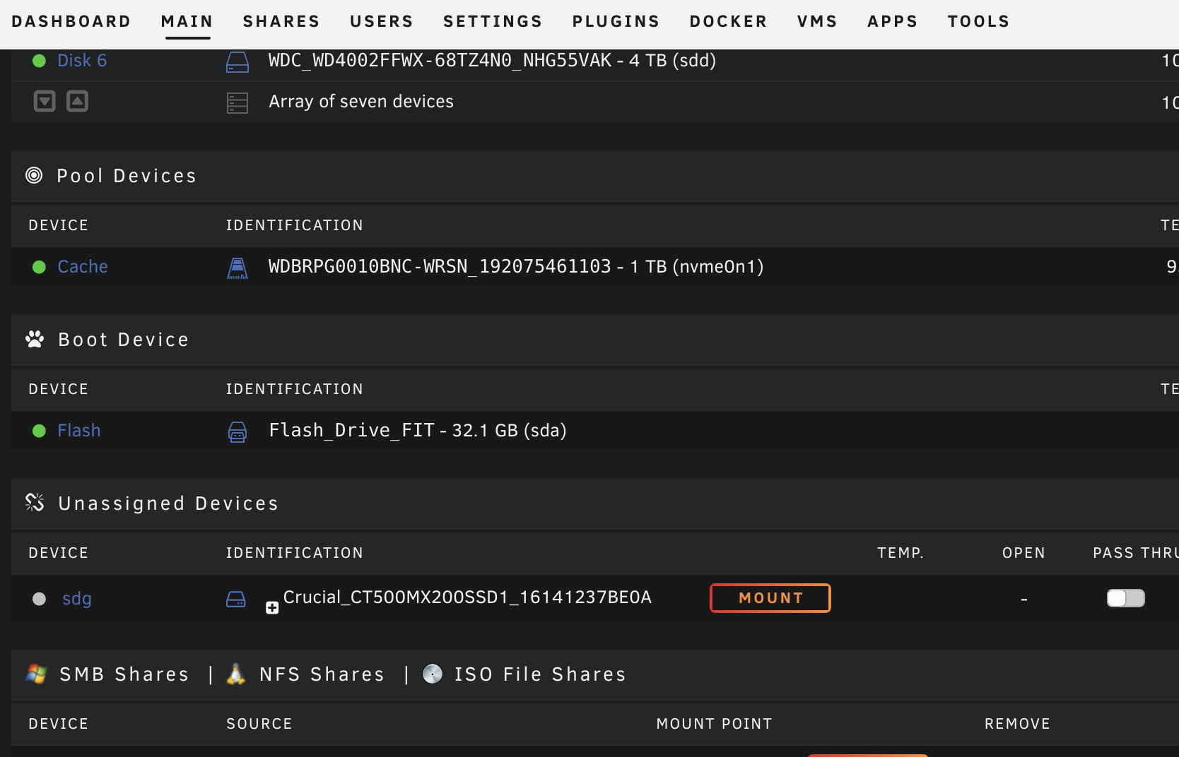

image.thumb.png.46e9559ef49b761810859d46fac45f31.pngimage.thumb.png.5c73ffbb399c20fd4129e3a4e125e8e6.pngStill no luck

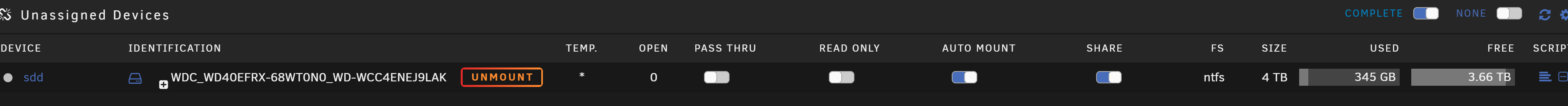

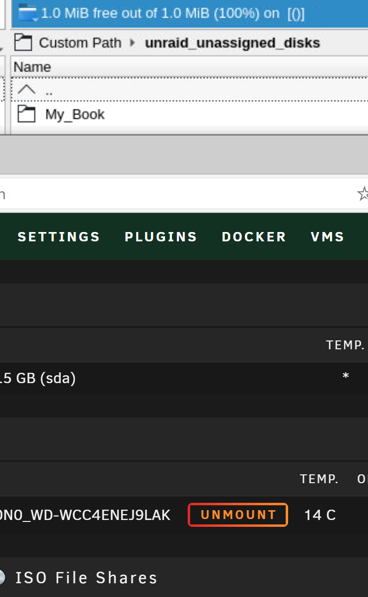

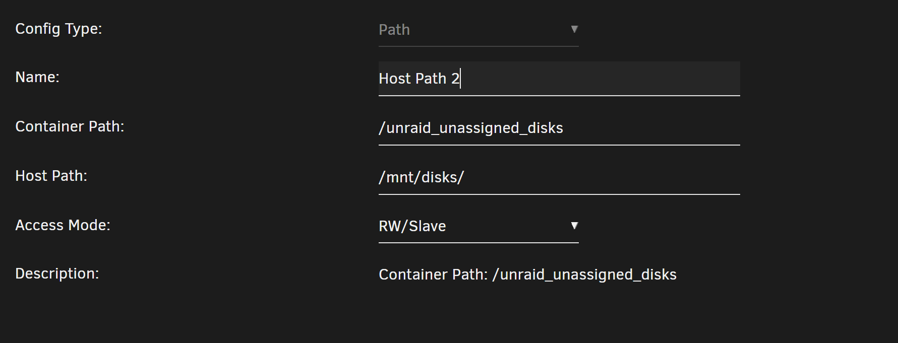

hmm ya  i used to get that too..  and is the unassigned drive   set to  slave read write?
also what i have  too  is   under shares.. my Drive is shared  i set it.. maybe thats the issue works for me
try setting it to share.. and then unplug or unmount it wont be instant i noticed takes a moment  so wait 10 -20 seconds
and it should work
so i tested  just now..  u5 pic is mounted.  u6 unmounted  u7 is remounted
all happned in a second;,,,   try that share button   see if that fixeds it for you.. or give unraid a reboot then re try what i did
yes its set the r/w slave

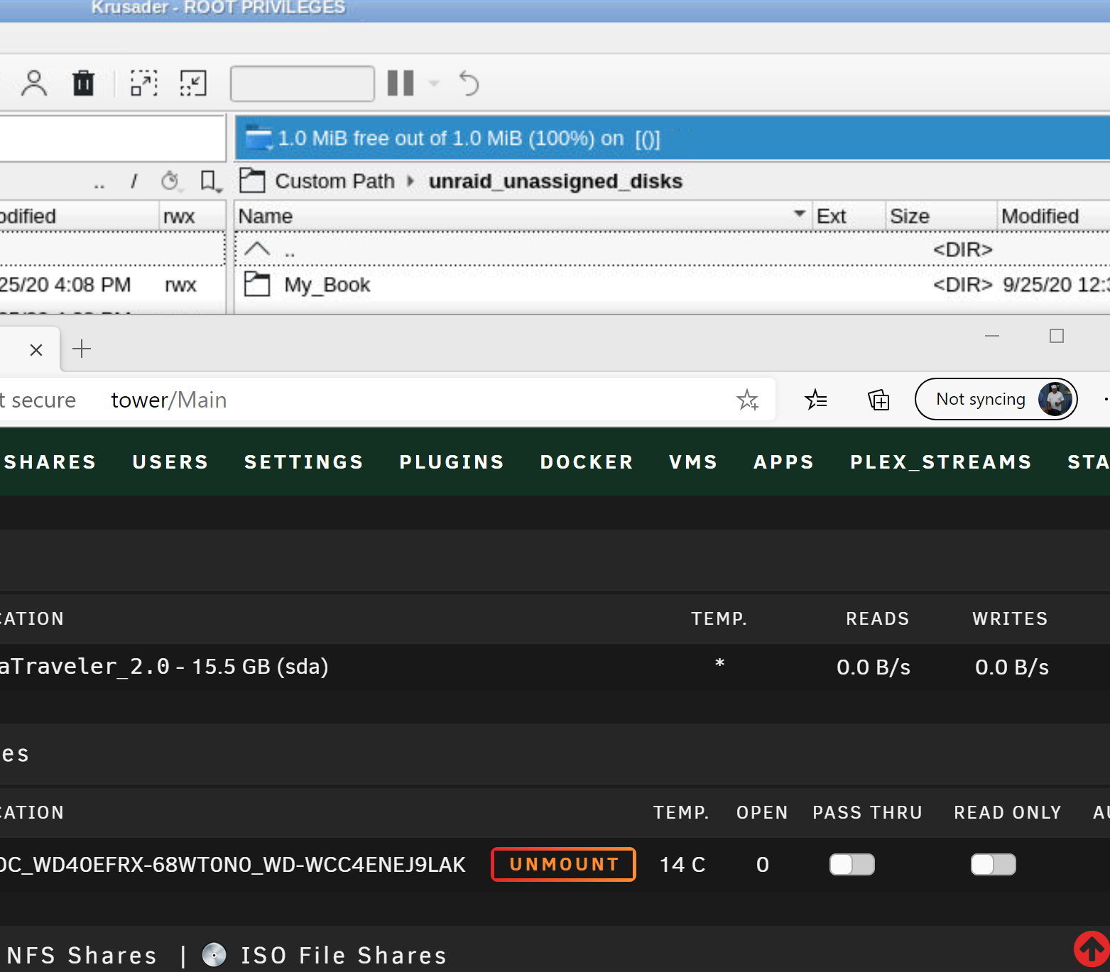

try my other  option i do.. i set the share to enable  under shares.. see if that works

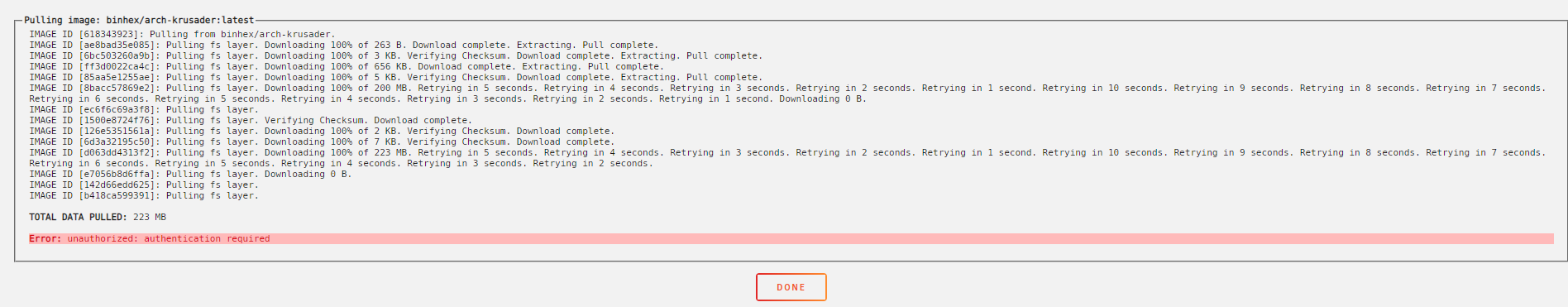

Hi all,
Im trying to setup my first unraid server however im having troubles in installing krusader to copy my unnasigned disk contents to the array. Can you help me out sort what could be behind this error? thank you in advance.

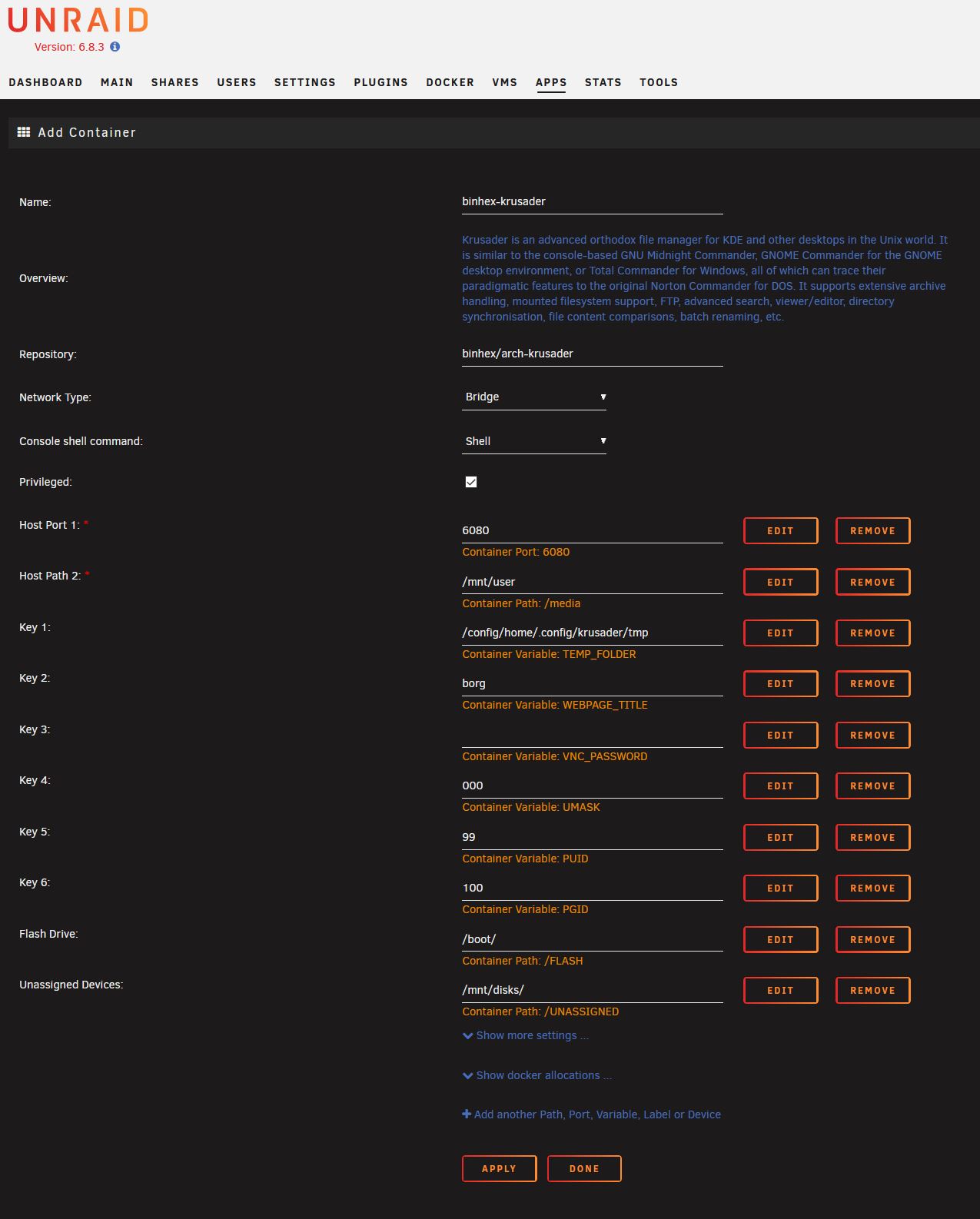

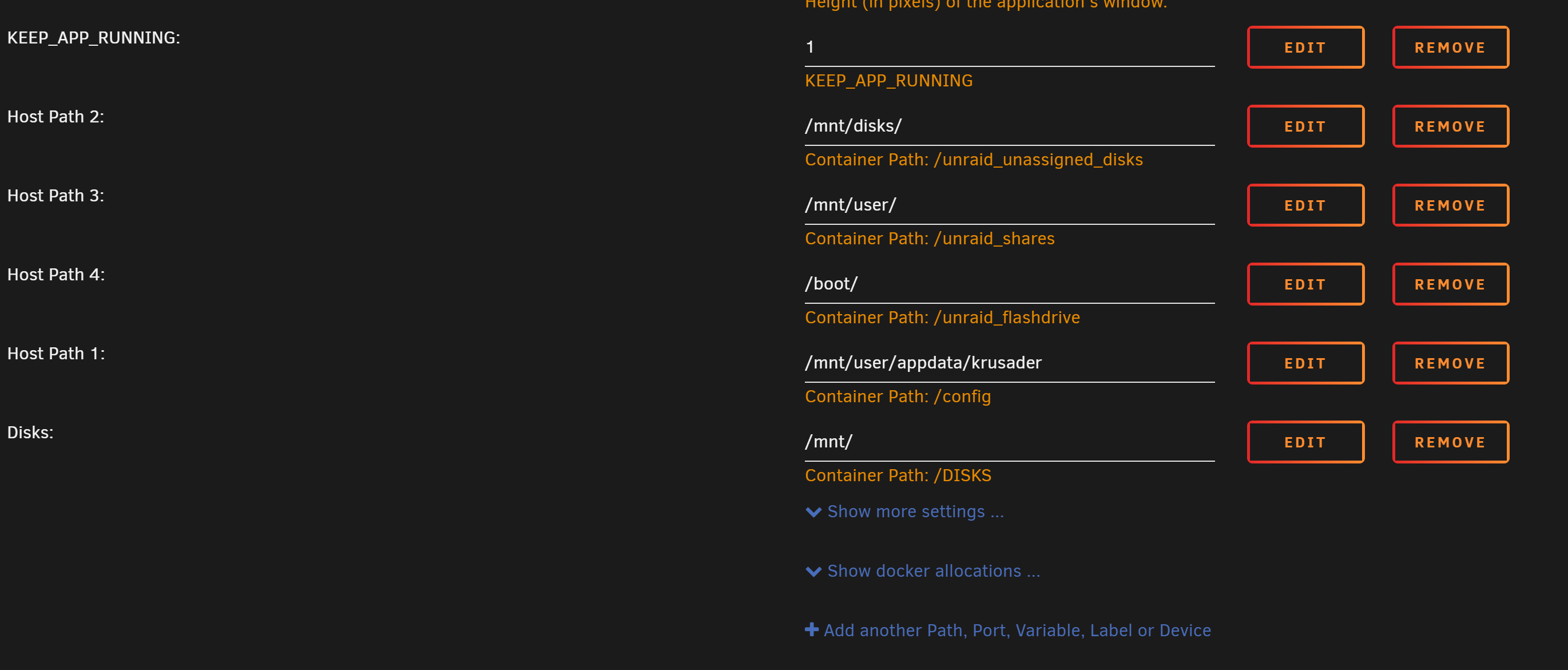

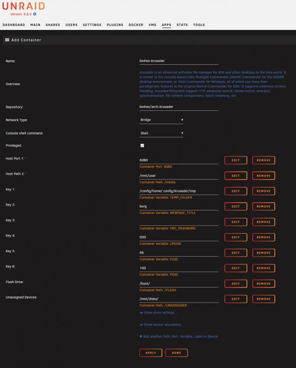

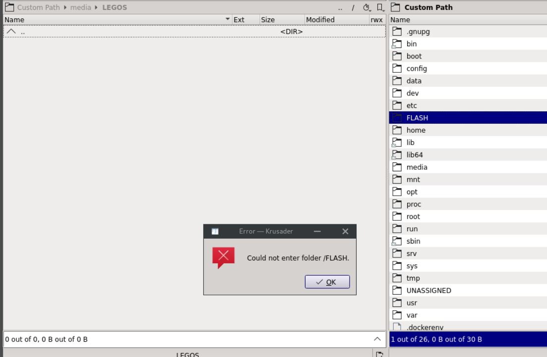

Fellow Forum Members,
Krusader installation is kicking my butt. I am following Spaceinvader's Krusader installation video but what makes it difficult is how his version does not match the version I am installing from Binhex. Right now I'm trying to backup my boot drive as Spaceinvader shows in his video.
However, when I try to move the FLASH folder from one pane to the other pane belonging to my share folder LEGOS I get a "Could not enter folder /Flash" error shown in the graphic below. I have logged in as ROOT user and I still get this error.  I have also included a second screen capture showing my current Krusader settings.  What change do I have to make to fix my Krusader setup so it works correctly? Is there a Krusader installation Video that shows the BinHex version and not the older SpaceInvader version because that will help me out tremendously?
Lastly, the "/mount/user" and "/media" container values BinHex includes does not match to SpaceInvader's version. What container value do I add if I create an UNRAID folder like SpaceInvader shows?  I ask because I do not see the Unassigned Devices "disks" folder or array hard drives like SpaceInvader shows in his video.    Any help will be greatly appreciated.  Thank you.

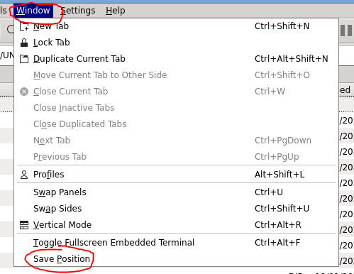

On 7/7/2020 at 10:22 AM, TexasUnraid said:
lol, I think ya'll are misunderstanding my question.
I have krusader working just fine, I have all the paths mapped as I want them just fine.
The only question I have is the minor annoyance that when I start krusader it by default opens to the in-docker /home/nobody folder.
Thus requiring me to back down 2 folder trees to root before I can start climbing the unraid file system tree in /media (I renamed it but same thing).
I would simply like krusader to default to starting in the /media folder so I do not have to back out of the home folder evrey time I start the docker.
It is a very minor thing but it annoys me and seems like there should be a way to change the defualt folder it opens to.
Try navigating to the windows youd like to be your new default and then inside Krusader go to Window>Save Position
Good find! that does seem to of worked!
