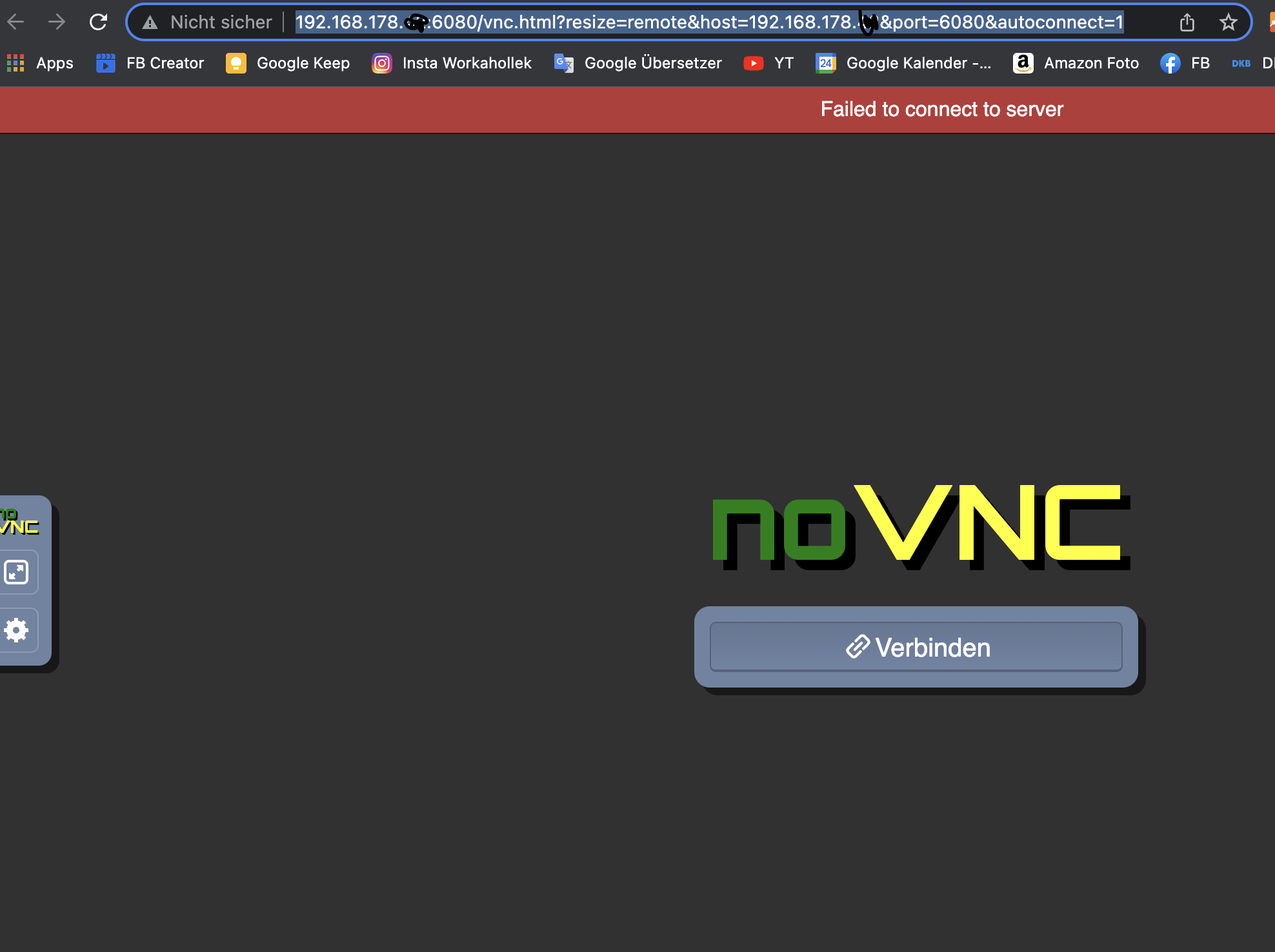

Hi, is it possible to remote access binhex krusader via internet web browser?
I can remote access my Unraid Server over the Unraid website -> Community -> "My Server" section with no problems after port forwarding on my fritzbox. But if I try to open the webgui of Krusader I got "Failed to connect to Server".
URL i am getting is: http://192.168.178.xx:6080/vnc.html?resize=remote&host=192.168.178.xx&port=6080&autoconnect=1
I already forwarded port 6080 and 5900. Thanks!
1053715587_Bildschirmfoto2022-01-25um15_56_57.thumb.png.3a3e2253cebcf5fd9b6dfa6e3e57a04d.png
Remote access via MyServers can only access the WebUI and any VNC only VM's.  It doesn't have access to any of the GUIs for any random container.  You would need to use a VPN (eg: OpenVPN / wireguard) for that.
(Or alternatively, create a VM (vnc only) to connect to via MyServers and from it the WebUIs of the various containers)

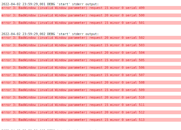

Hi all,
I'm a new Unraid user and built a server for my movie collection that I'm ripping at the moment.
I copied about 90 rips yesterday from ssd drive using BINHEX - KRUSADER. It looks like the copy was successful,  but looking at the log file I see some errors that I can't find a solution for on the forum:
error 3: BadWindow (invalid Window parameter) request 20 minor 0 serial 502
error 3: BadWindow (invalid Window parameter) request 15 minor 0 serial 503
error 3: BadWindow (invalid Window parameter) request 15 minor 0 serial 463882
etc etc.
What does this mean and how can I prevent them? I'm using Unraid Version 6.9.2 2021-04-07, Krusader latest version.
