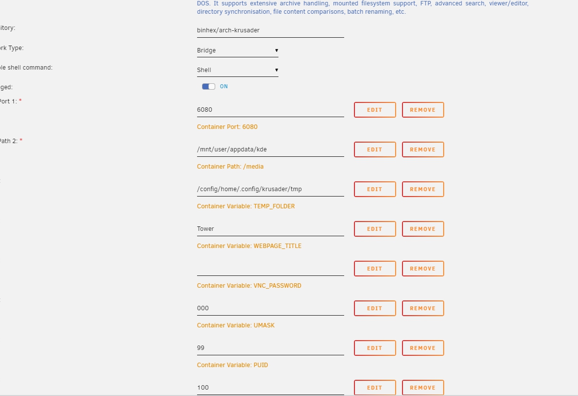

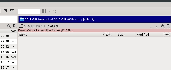

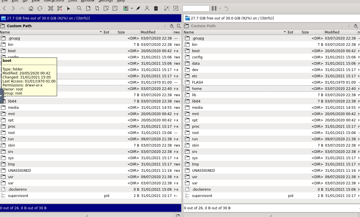

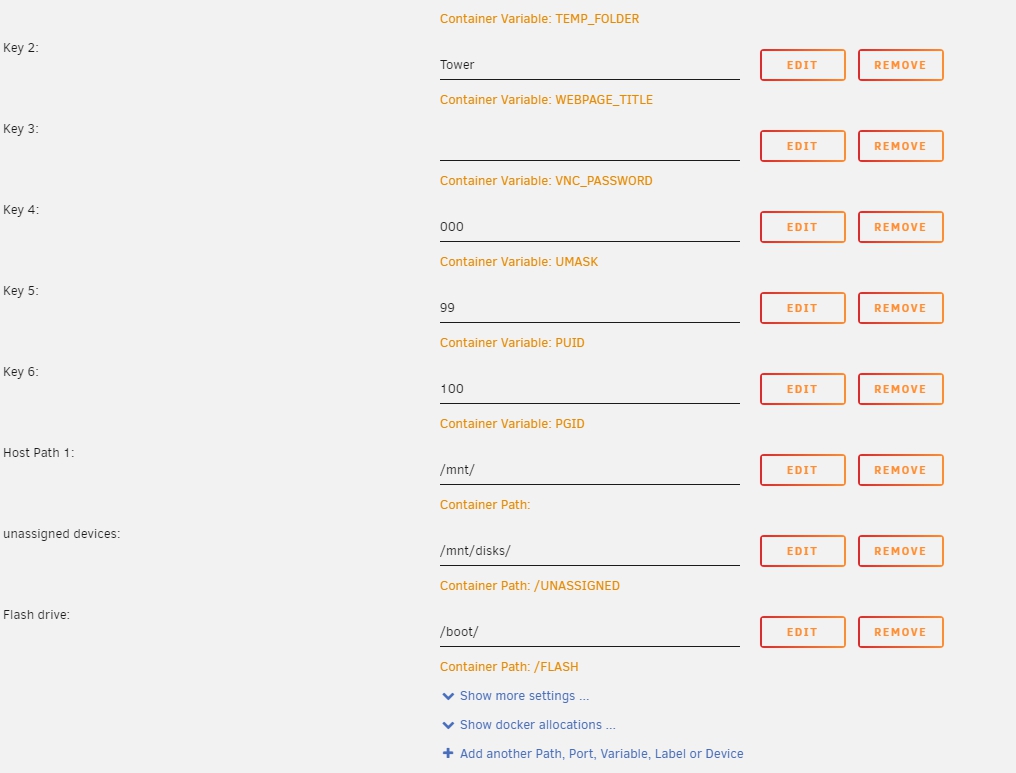

Hi guys,
tried to install your Krusader, and following SpaceInvader indication, but the settings pages are different and perhaps I've made some mistakes.
However the docker was installed, but in the GUI I don't see the same details Space was shown and if I go into some folder ( for instance FLASH ) it doesn't show anything.
Any suggestions on how to fix all these issues ?
- are the settings corrects ?
- the version showed in the Spaceinvaders is different, especially regarding the KEYS that in the video are not mentionign and not with such a numeber of them, however I left them untouched
- in the setting the line  "the Webpage title " : is as default named TOWER.  Is the name of the server ? I left it, but to be clear, my server has a different name, should I change it ?
- Why I can't see UNRAID FOLDER ? The main issue it that I would move file onto some  share folders, but since I don't see them, I can't.   Any suggestion on  it ?
THX for your kind support
Attacched some screenshots

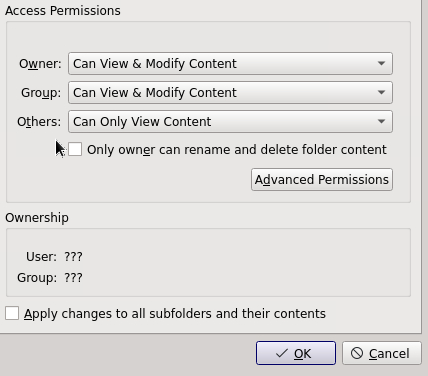

Hello, I am unable to use this to delete an sql database that was left behind when I deleted nextcloud and mariadb. I have tried to find a solution and just cant figure it out. It says only "nobody" has the authority.
Any help would be wonderful. running 6.9.2.
Pretty newbie too.
Sorry to post quickly again but this is the picture of what I believe the issue to be.
