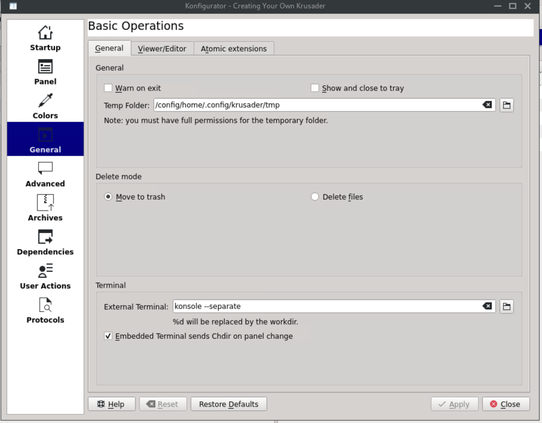

50 minutes ago, TexasUnraid said:
I could not figure out a way to disable trash
Settings/configure krusader/general/delete mode = change from 'move to trash' to 'Delete files'

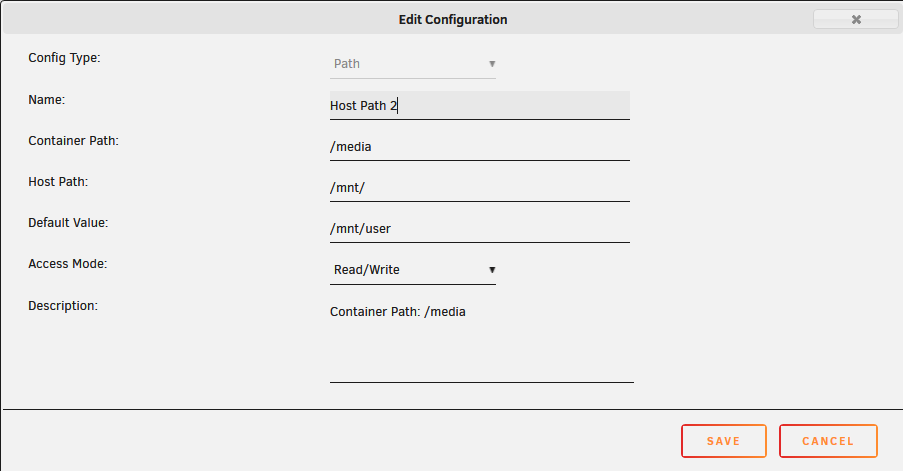

Look at Host Path 2.  I edited it to look like this:

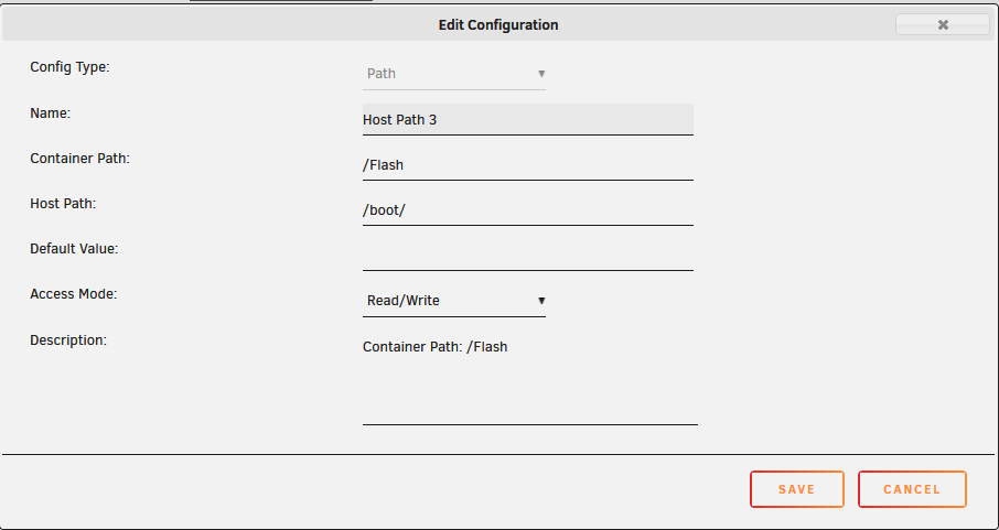

And I added Host Path 3 to add the boot/flash drive which looks like this:

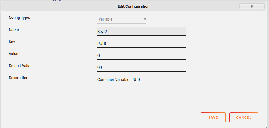

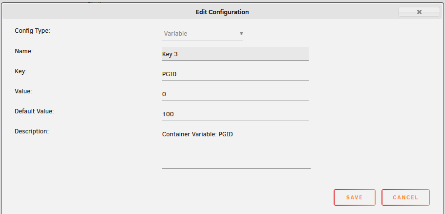

Which adds the boot drive to Krusader.  IF you use this addition, you will have to change the PUID and PGID to change the user to root as shown below:
It is important to realize that gives Krusader 'root' privileges so you have to make sure that access to it is limited.  (What I do is 'stop' the Krusader Docker after use. So basically, it is only active when I am actively using it!)
This should give you enough information to setup a Host Path to any point on the Unraid file system.  You do want to be a bit careful as I seem to recall that you can get to the Krusader GUI from a web browser if you know the IP address and port number!
as @Frank1940 says, you can do basic auth with password protection via env var 'VNC_PASSWORD', but yeah dont port forward this directly to the internet!, reverse proxy should be fine with a real cert or vpn tunnel if you REALLY need access whilst out and about.
lol, I must of passed over the general tab assuming it would be buried deeper then that.
Thanks!

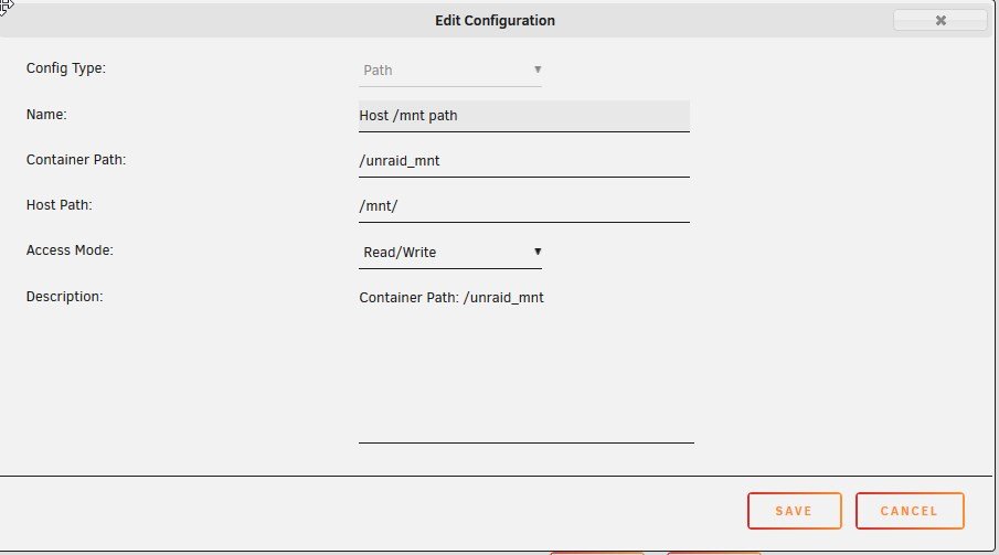

Thanks, I actually setup paths much like this already from that video actually.
What does the default value do? I never really understood it, it never seems to be set in dockers?
I am not sure what in the settings you have there would cause krusader to open by default to a folder of my choosing? Right now it opens to the in docker home folder every time I start it. So I have to back out to get to the unraid folders.
EDIT: I do not see the default path option? That was the only real difference from your settings?
