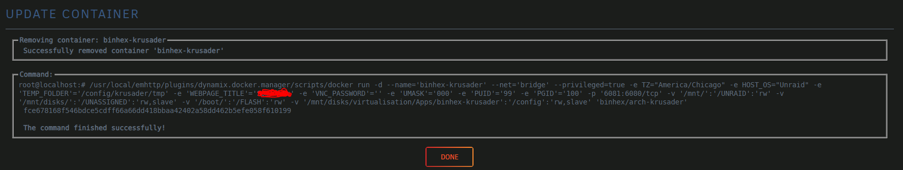

42 minutes ago, statecowboy said:
Hi everyone.  Was wondering if someone could do a sanity check on my config.  I've had some weird issues with my docker image filling up, and I believe this only happens when I leave krusader running for a long time.  Probably worth noting, every time I start krusader I get a notification that I can't save bookmarks to the home/nobody location.  I am wondering if this is resulting in tmp files being written elsewhere within the docker image.
More useful and more complete than that screenshot would be the docker run command that results. How to get the docker run command is explained in the very first link in the Docker FAQ pinned near the top of the Docker Engine subforum.

3 minutes ago, Frank1940 said:
Double check this assignment as I believe it is on the RAM disk that Unraid uses.
That path would make sense if he actually had a mounted Unassigned Device at /mnt/disks/virtualization. Of course, it should also be configured read/write slave if used for this purpose.
And even if it is in RAM that is not that same as filling docker image.

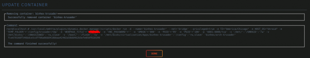

Attached.  And yes, my dockers live on an unassigned device set to R/W slave mode.
I don't see anything obviously wrong with that. Of course, if you write (copy/move) anything into any folders within Krusader that aren't mapped to host paths then that would be writing into the docker image.

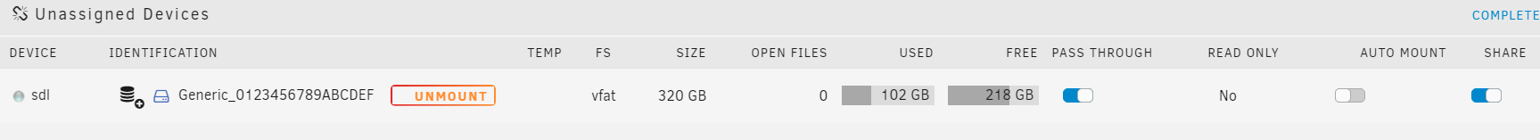

Hello,
I plugged an external drive to Unraid as seen in the screen capture. What else should I do to be able to see it in Krusader's panel?
1 hour ago, xtrips said:
Hello,
That depends on how you have your krusader mappings. If you have /mnt mapped then it should already be there. Post your docker run command as explained in this very first link in the Docker FAQ:
