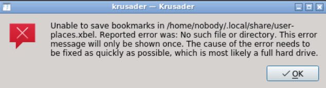

Using RC7 and getting this error on load up.
Also, I'm trying to use VNC Viewer to connect to the remote desktop. I put in "192.168.1.254:6080" and it will timeout. You are able to use the VNC Viewer on this, right?
