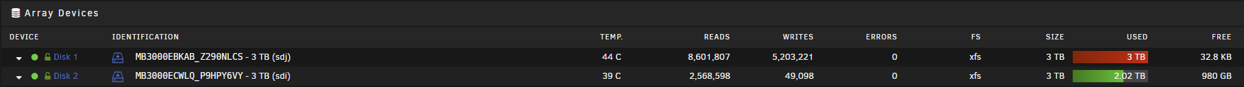

I have 3 drives, and only one of them is filling up. I have high Water choosed across all shares.
I been thinkin to use turbo write but it has its own drawbacks ✌️
There are 3 settings for a User Share that Unraid considers when deciding which disk to write: Split Level, Minimum Free, and Allocation Method.
Split Level has the highest precedence. When choosing a disk to write, if Split Level says the file should go on the same disk other files are already on then that is the disk that will be chosen.
If a disk has less than Minimum Free remaining, then Unraid will choose a different disk (except Split Level has precedence).
High-water Allocation is a good compromise between using all (included) disks without constantly switching disks simply because one disk temporarily has more free space than another. It is a little complicated to explain but fortunately there are already explanations in the wiki:

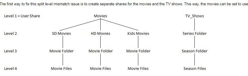

hi guys can someone please tell me how do i clean the history list and if is there a way to select the default folder when open Krusader, thanks in advanced
Did I select the wrong share? shouldn't it be under "user"

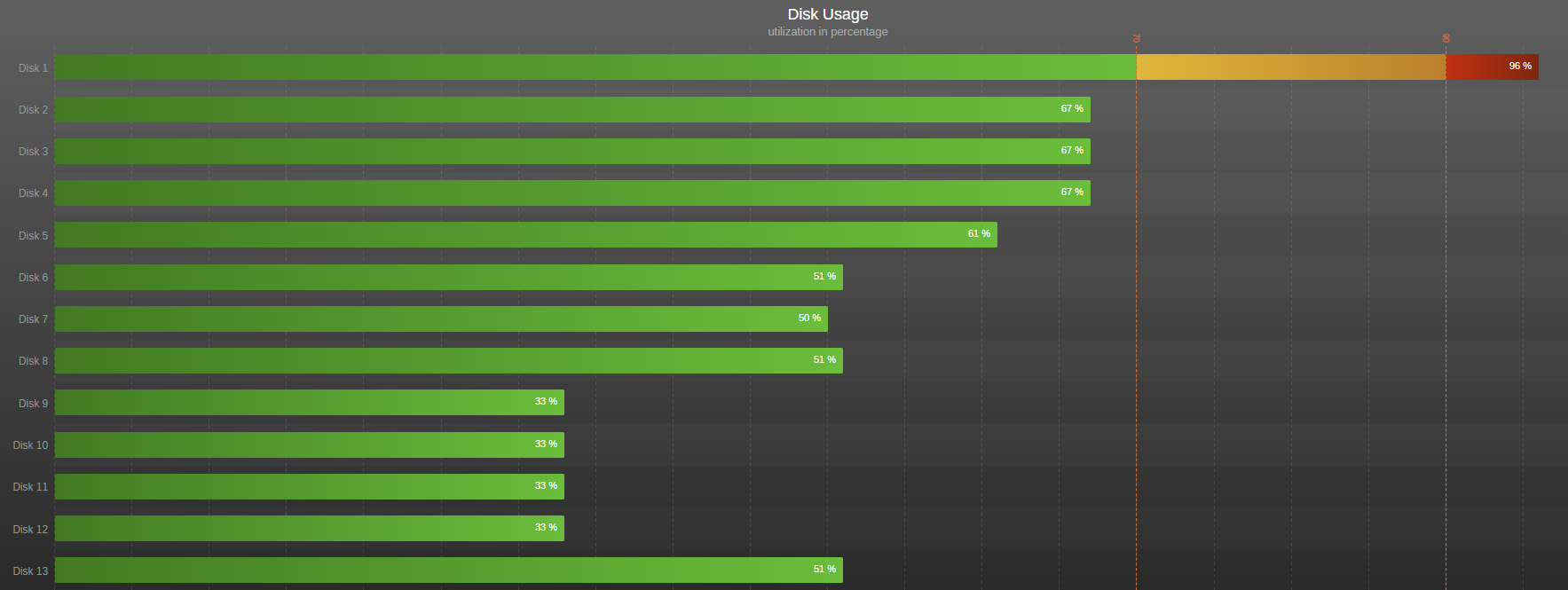

I just used binhex-krusader to copy a very large media folder and for some reason it just filled up a single drive and stopped?
I have copied to the "root\UNRAID\user\movies" and I have the shared folder setting to "High-Water" any way to do the copy with krusader and not filling up the individual disks?
Its movies: So split level is 2
I just did a unBALANCE and then restarted Krusader and startet the transfer to the share under user (Not user0) I dont have any cash on this share and I dont have any parity drives (Waiting to add them after the copying is finished)
But Krusader is now again filling up disc nr 1 - transferring from my old server by SMB it looks like it levels the data?
Any help is much appreciated
Linux sees all user shares mounted at /mnt/user. Move and Rename are the same command in Linux, mv.
So if you move files between user shares, it will rename them with a different path on the same disk they are on, instead of copying them to another destination disk and then deleting them from the source.
You will have to do the copy then delete yourself instead of a move. If you copy from source to destination, it will write a new file at the destination using the user share settings. Then you can delete from the source.

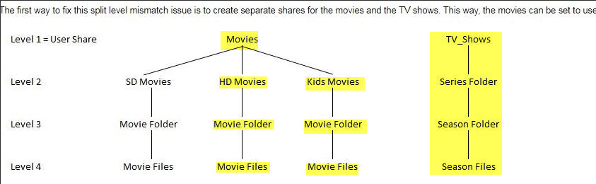

I think you need to set your split level higher.  This quote is from the following section in the Unraid 6 manual found here:
         https://wiki.unraid.net/index.php/UnRAID_Manual_6#Parameters
Split level defines the highest level in the share directory hierarchy which can be split among multiple disks. In the Movie share example above, setting Split level to 1 only permits any object created directly under the Movie directory to be allocated to any disk according to the Allocation method. Thus, when we create the Alien subdirectory, it may reside on any of the data disks; however, when we create a file or another directory within the Movies/Alien directory, this object is at level 2, and will be created on whatever disk the Movies/Alien directory actually resides on.
I realize that it is virtually 'legalese' and very difficult to understand.  (At one time, there was a Wiki entry that had a much clear description of how the split level worked but I can't seem to be able to find it any more.)  The split level assignment number has caused confusion for years.  It is intended to keep the .VOB files in the VIDEO_TS directory of a DVD on the same hard disk so that the movie/show/video does not pause should the .VOB files be split across two disks.
Here is that section  (Found it with Google):
      https://wiki.unraid.net/Un-Official_UnRAID_Manual#Split_level
I did read this and came to the conclusion that split level 2 was perfect (All is mkv files) so dir is in a relative flat structure
But maybe I need to count the sub dir of the shares?
Movies/Kids Movies/Movie name/Movie file.mkv --> Would this be split level 2 or 3?
No The transfers are from Mounted share inside Krusader to the shared Unraid folder, so it should move to the next drive...
Update it just moved to the next drive but it didnt leave any room left on the disc (I have set 50G free space on all shares?)
Looking at the folder it looks fine all movies in each folder on the same drive - like I wanted ?

Another possibility that I have seen in other situations, such as rsync, is that the application will create all the folders in advance, then copy the files to those already created folders. Since the disk has plenty of space for the empty folders, that is where they wind up.
Print out this section on paper:
Now write the name of each folder (not any file names, as the split level strictly deals with folders/directories) on the paper.  There is not such thing as a 'sub-dir"!  It is either a folder or a file.  I do believe at this point, you need a split level of at least three.  (By the way, I doubt if you truly need any split level if you are using .mkv files for media storage.  Each show or movie is in one (and only one) file and that means that there will be no pause in the playing of any movie or show while a second disk spins up.  You may have a slight delay while loading file names but that is usually only a few seconds.)
Yes you are completely correct - it just finished with 68 empty folders... so cleaning up and starting unBALANCE up again.
Ok bad choice of words 😊 but you know what I mean saying "Sub-dir"
I just wanted to have one single folder with the movie in that folder and if possible poster, nfo files etc,,,,
And my homework was exactly what your link says:
Losing a drive would then mean losing, a "full" set of movies with info, making it possible to identify what was lost.
And for TV Shows
I think the level is (ok) its the way copying is done in Unix.... just have to keep using External transfers to the unRAID server

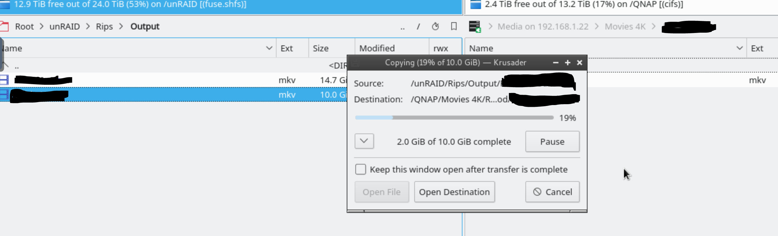

FIle copy crashing/freezing krusader when copying a large file ~10GB to QNAP NAS. I have a SMB mapping from KRUSADER to a share on my QNAP NAS and I have been unsuccessful copying large files from the unRAID NAS to the QNAP NAS, starts out fine and ~2GB of data copied, KRUSADER crashes and I can't restart it w/ out rebooting unRAID.
Is this just a limitation of KRUSADER or do I have a configuration issue? I have read just about suggestion posted and re-installed KRUSADER w/ same results.
Both NAS are attached w/ bonded interfaces and configured correctly on the switch.
