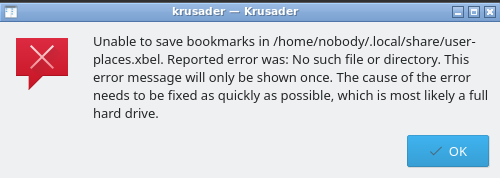

Hi  I'm trying this docker for the first time and I'm getting an error on first run:
1218782224_FireShotCapture54-Highlander-noVNC_-http___172_30_12.3_6080_vnc_html.png.9ee80a58fe0e978416892381f210662b.png
Help please
Help please
root@localhost:# /usr/local/emhttp/plugins/dynamix.docker.manager/scripts/docker run -d --name='binhex-krusader' --net='br0' --ip='172.30.12.3' --privileged=true -e TZ="Europe/London" -e HOST_OS="Unraid" -e 'TCP_PORT_6080'='6080' -e 'TEMP_FOLDER'='/config/krusader/tmp' -e 'WEBPAGE_TITLE'='Highlander' -e 'VNC_PASSWORD'='Removed' -e 'UMASK'='000' -e 'PUID'='99' -e 'PGID'='100' -v '/mnt/user':'/media':'rw' -v '/mnt/user/':'/user':'rw' -v '/mnt/disks/':'/disks':'rw' -v '/boot/':'/flash':'rw' -v '/mnt/cache/appdata/dockers/binhex-krusader':'/config':'rw' 'binhex/arch-krusader'

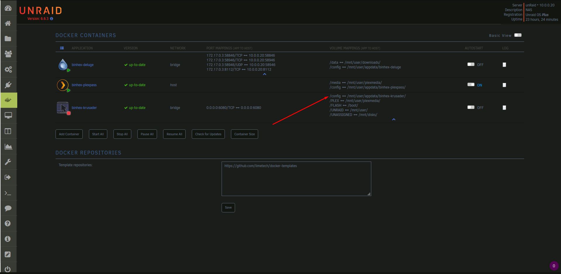

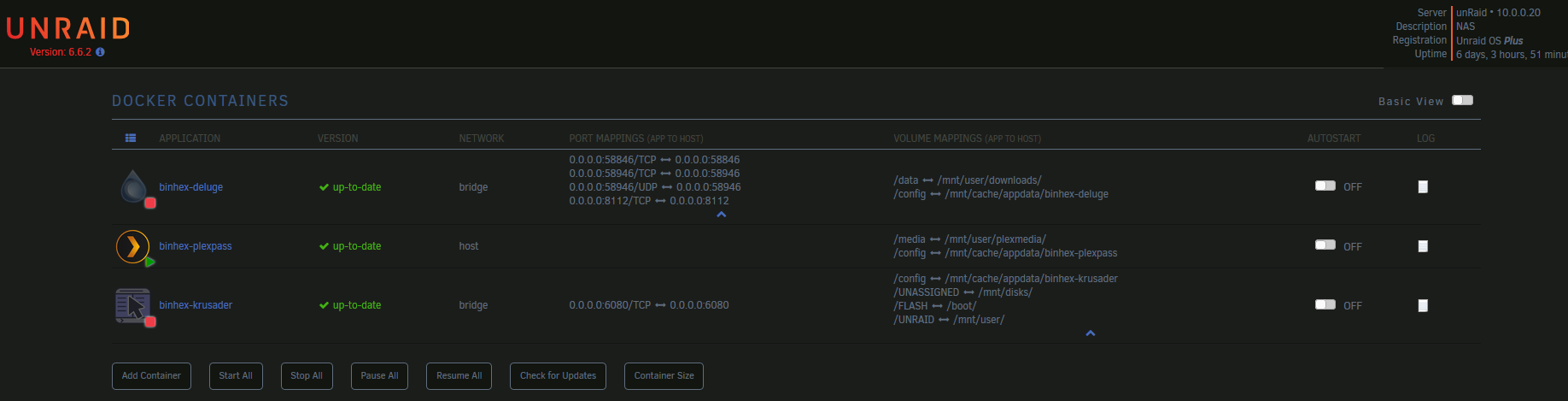

I am having this same issue after swapping cache drives and choosing to rebuild my dockers from scratch. I think there is some sort of permission error going on, not only do I get this same error each time but it also walks me through the tutorial for the first time each time.
Here is what my dockers look like Screenshot_45.thumb.png.db78d495f25c9f9c50122ecdc0be1f9a.png
I have also tried with all default settings as well as deleting my docker user template on my flash drive and trying another install, but nothing helps.
Here is my docker log as well: supervisord.rar
I thought that this might be related: https://forums.unraid.net/topic/72736-fix-common-problems-binhex-krusader-newbie-question/
But i still have issue without mapping anything but the default and excluding Unassigned devices to see if it would help.
If anyone could point me in the right direction to try and fix this I would really appreciate it.
P.S. I had a very much similar issue with deluge docker awhile back as well: https://forums.unraid.net/topic/62206-dockerappdata-permission-issue/
Thanks in advance for the help as always!
~Acps
Ok so I tried multiple things to try and fix this, including delete the docker and reinstalling, deleting the docker template, resetting and installing with default settings, deleting the dock image itself and rebuilding it. None of which fixed the issue.
Until I found this post:
And looking at my docker logs I could see it was having permission issues, so I did 2 things, first was to set my appdata folder "cache" settings to Prefer instead of Only. And I adjusted the appdate install path within the template from
/mnt/cache/appdata/binhex-krusader/
to
/mnt/user/appdata/binhex-krusader/
So this is what my docker tab looks like now:
The permission issues in the log stopped and the errors I was getting every time I launched the docker have stopped as well.
Can able tell me whether or not this is how your supposed to set the path for the "appdata /config"? I switched my other docker apps to /mnt/user/ as well instead of /mnt/cache/.
The whole reason why this even popped up for me was because I swapped out some ssds for my cache drive and reinstalled all my dockers from scratch. It had been running fine before that for atleast a year or so.
Thanks in advance!
~Acps
not a good idea, if you are storing docker configuration, downloads etc on the cache drive then you do not want it to be moved by the 'mover' process to the array, thus the recommended setting is 'only', this wont be your issue.
to
sadly, also not a good idea, a few docker containers are very sensitive to using the fuse based filesystem (plex being one of them) and you may see issues when specifying a fuse path (/mnt/user/<anything>), better to keep it as it was (writing directly to the cache drive).
so onto your issue, if it is permissions based then your best bet is to stop the container and then delete the file /config/perms.txt, then start the container, this will reset file/folder permissions to match the PUID and PGID you have specified.

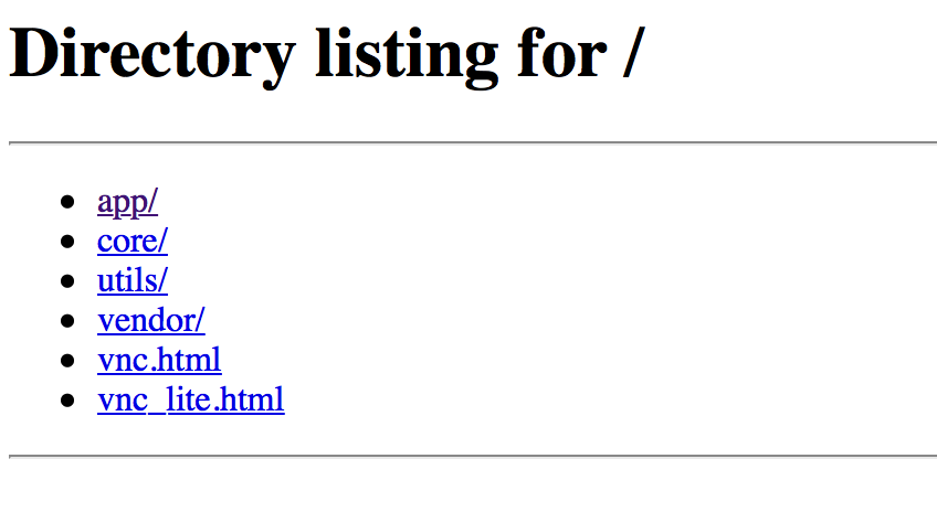

there may be something funky going on with my VPN setup, but I after using Krusader without a glitch for hours at a time, I suddenly keep getting a situation where when I want to call up Krusader at port 8080, I only get a white page with a directory listing.
what could be causing this to happen?
makes me realise, yet again, that Krusader is the single most important application on my unRAID, other than the unRAID OS and WebGUI itself...I can't live without it, I can't manage my data on unRAID without it...simple as that...thank you *so* much, binhex, for what you have done here and continue to do!
been pulling what little hair I have left out for hours now...going to bed, hoping for a solution tomorrow.
g'nite all!
g'nite all!
So its partially loading the page, or showing you whats been cached by the browser, my guess is that your VPN is either dropping or your firewall is blocking the connection for some reason, if you could test it on your home LAN and confirm no issues there (without restarting the container) then that would strengthen the argument that its most probably firewall/vpn related.
it's definitely not a firewall problem...I get the same behaviour from my computers here in LA, and also from my iMac in Berlin, which I remote into and use for data synchronisation to the unRAID system. And it was working perfectly for weeks, until yesterday.
I can confirm that the VPN seems to be re-connecting, constantly, for some reason, and that I have sent a request to the IT there to look into it. What I don't understand that with all things being equal (including the re-connects), the iMac in Berlin was working reliably with Krusader on port 8080 for the past 2 weeks, 24hrs a day...this just started happening, and everything I have been trying fails to have any effect...the fact that it is happening on 3 machines makes it particularly curious.
